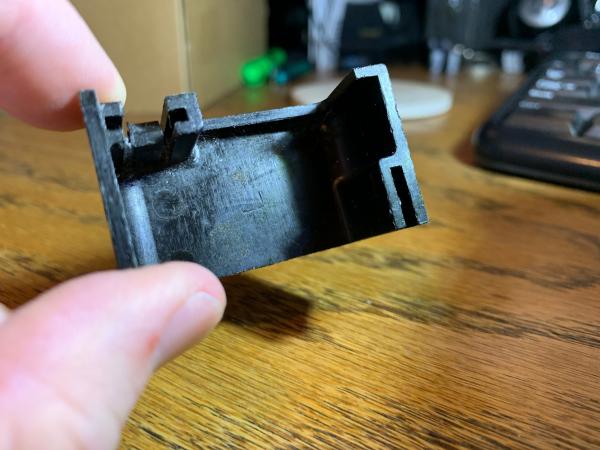

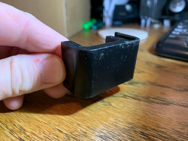

- In the center console, I've had a piece in there for nearly 13 years since I purchased this that I have no clue what it's for. Can anyone help identify this from the pic? Where does this go and/or it's purpose?
https://www.toyota-4runner.org/memb...4runner-limited-picture59797-img-0283-1-a.jpg
https://www.toyota-4runner.org/memb...4runner-limited-picture59796-img-0284-1-a.jpg

If you'd like, I have a '96 center console that I can trade with you. I'll even throw in the e-brake mount so you can add it to your rig. I only ask for your center console and the e-brake mount in exchange *fingers crossed :wave:

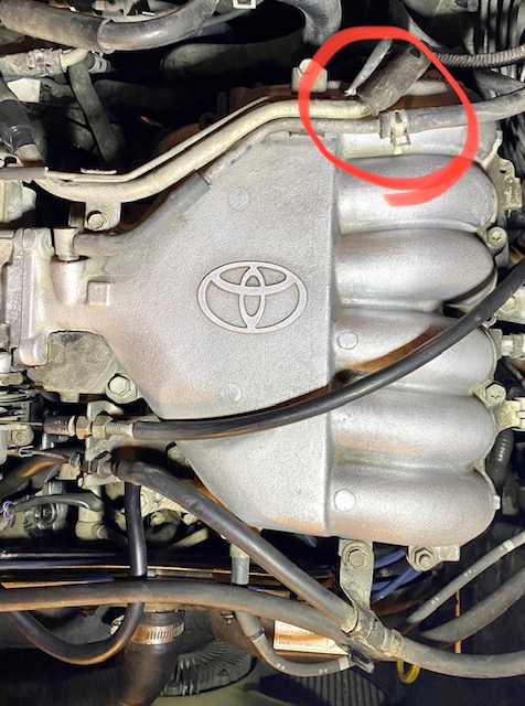

Threw a P0171 code. It was only a few days ago that I cleaned the TB, IAC, and MAF, so I looked for a vacuum leak and found the culprit.
Most of these hoses are original (21 years old) so I’ll go ahead and replace everything with some blue silicone.
Silicone Boost Vacuum Hose
The replacement hose set I want is out of stock. I emailed them and they responded very quickly and said they thought they’d be back in stock in about two weeks.
In the meantime, I wrapped the fitting with some silicone rescue tape.
