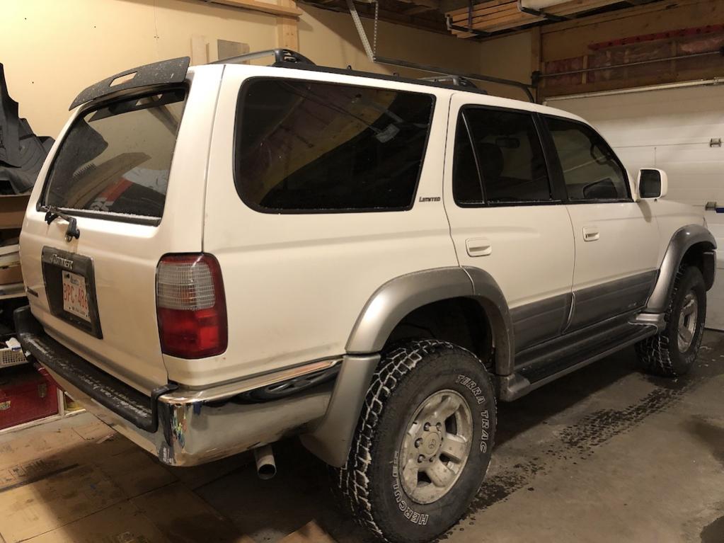

Got the rear replacement bumper on my limited.

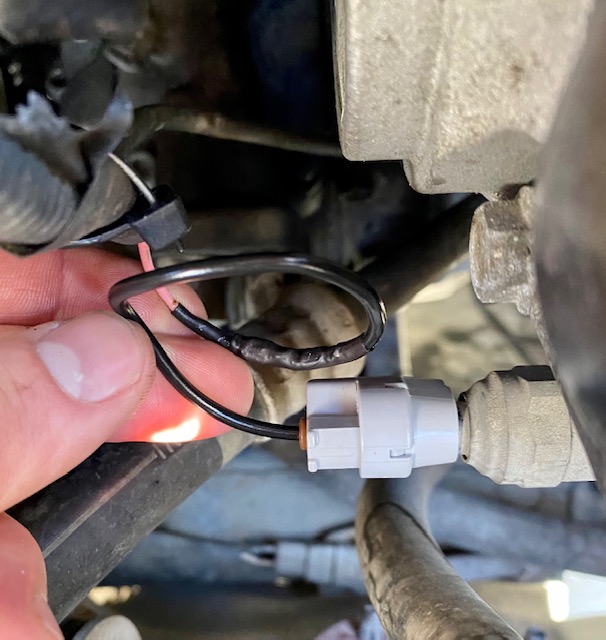

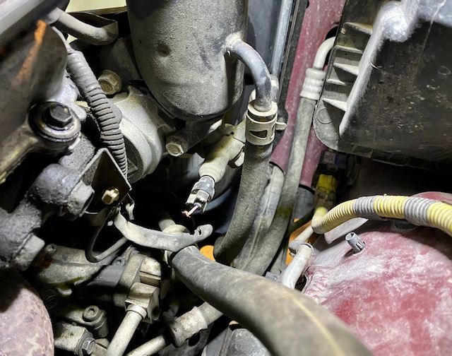

About a month ago I noticed that the power steering idle-up switch wire had been cut.
So today I soldered in a repair and verified that it’s working. At very low speeds, cranking the steering wheel will momentarily increase the RPMs by about 50 to 100.
(Not the best looking solder... I should’ve practiced before doing the repair since this was my first time... :cowboy: )
Toyota parts:
- 90980-11428 Housing, Connector F
- 82998-12440 Terminal, Repair W/W

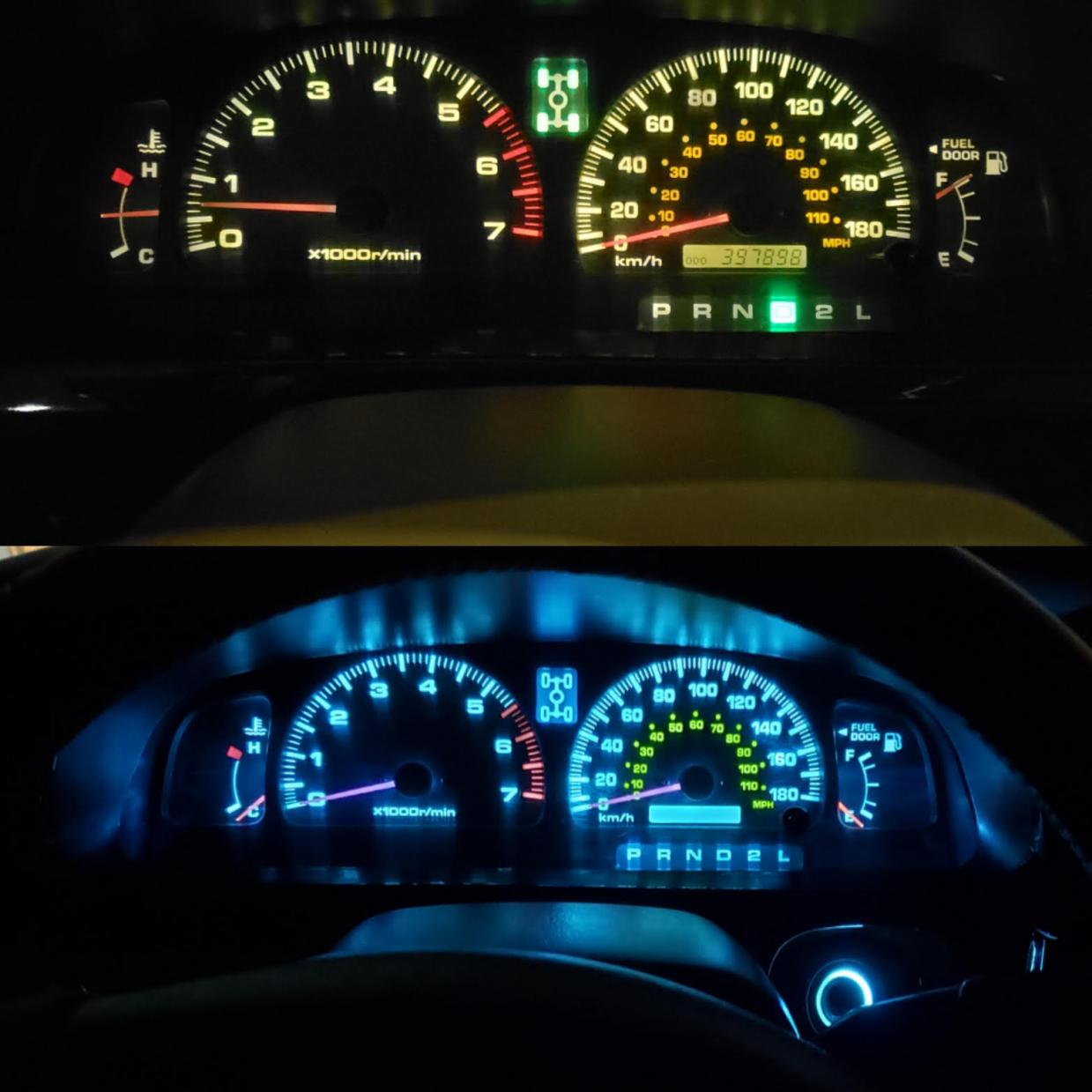

finally got around to changing the gross dash lights, ended up kinda ricey but anythings better then before will probably ended up switching them again in the summer

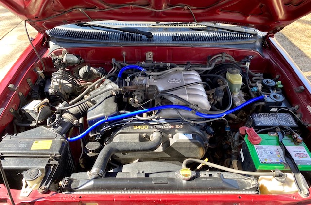

Started replacing all the 21-year-old hoses. Two down, many to go...
