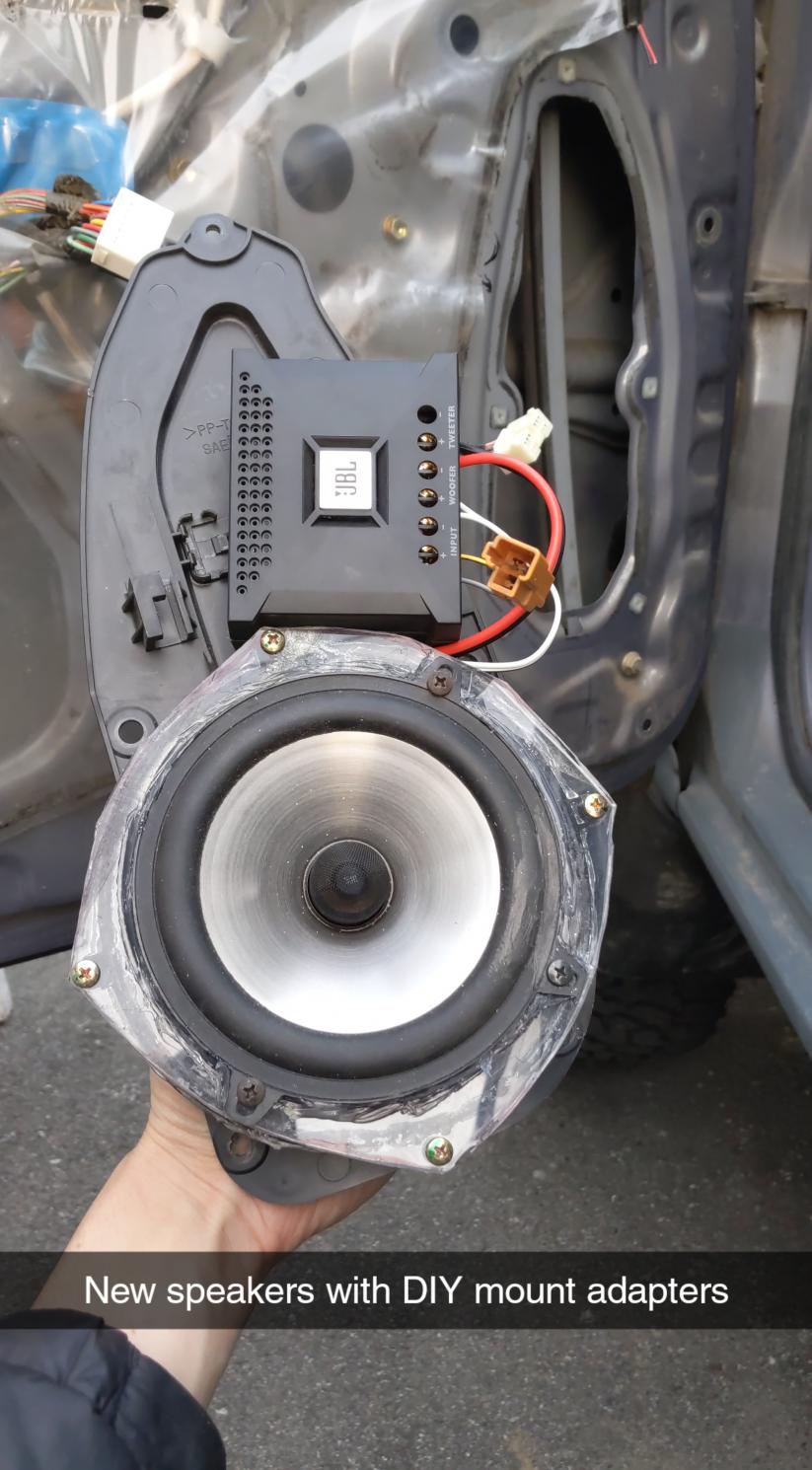

Installed some new (used) speakers.
The fronts were 5.5 inch (I think) JBLs with external crossover. The crossover just barely fit under the door card if I positioned it very carefully. I made adapters out of 1/4" scrap plastic, to fit these into the stock speaker mounts. (see attached photo)
For the rears, I was able to squeeze in 6.5 inch shallow mount Pioneers. I removed the stock speaker mounts completely and made my own out of the 1/4" plastic. I used some old margarine containers to make some rain covers similar to the ones build into the back of the stock mounts. I loosely followed this guide: 3rd Gen rear door 6.5" speaker upgrade

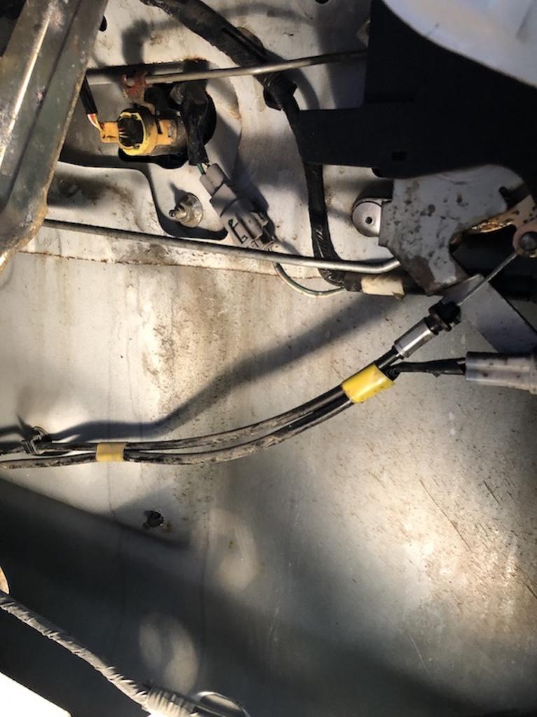

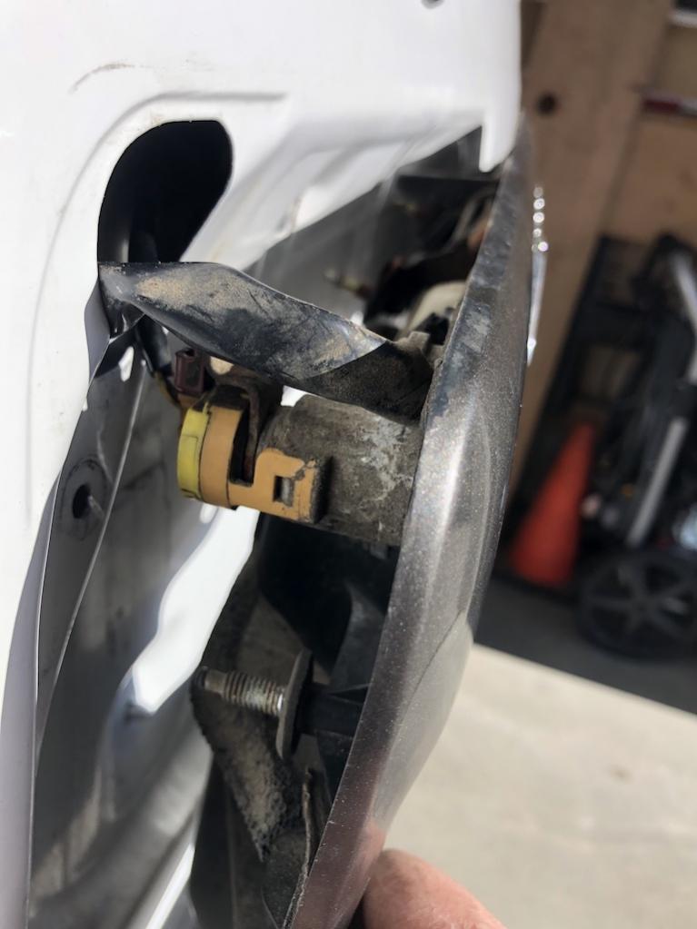

Removed the rear hatch lock cylinder. Can't get the key inside so getting the locksmith to rebuild. Broke one of the garnish clips...should be interesting to find one of those.
