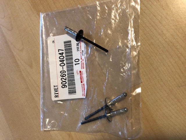

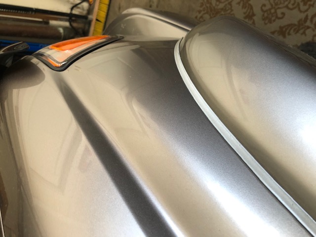

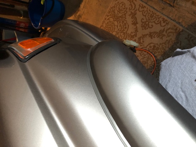

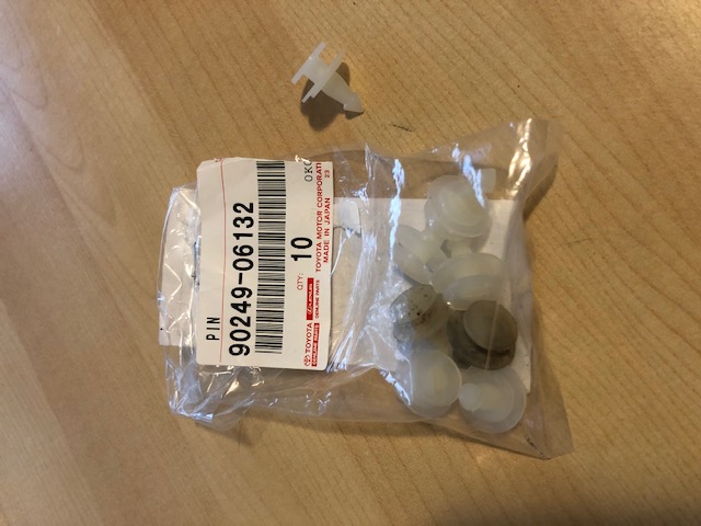

I finally got around to replacing the fender flare pads. It's one of those aesthetic things that has been bothering me since I bought it. (I'm a bit OCD)
Looks much better now.

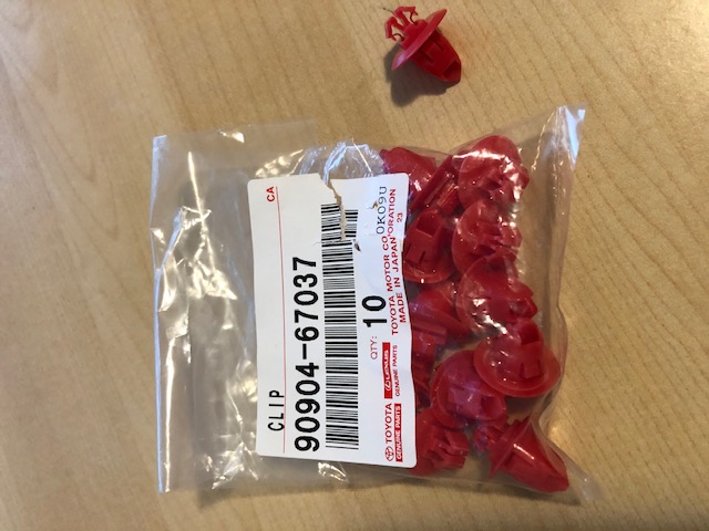

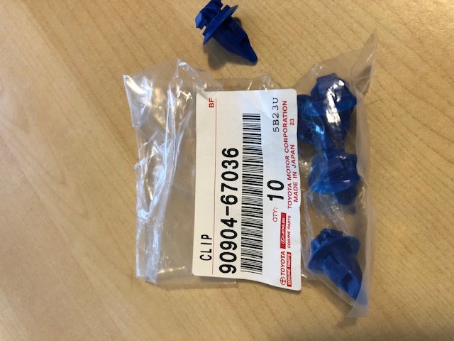

FYI, there are three different clips needed for these flares on my '02 sport edition (despite what the dealer told me)
Rear quarter panel uses pn: 90249-06132
rear door and front fender use a combination of the red and blue clips
pn: 90904-67037
pn: 90904-67036
all of them take rivets pn: 90269-04047

I went through that OCD exercise too, very hard to figure out the required clips, rivets, pads, and fasteners. My '97 used different rivets at the front and back ends of the front flare, the front one has a spacer - 53888-35010.

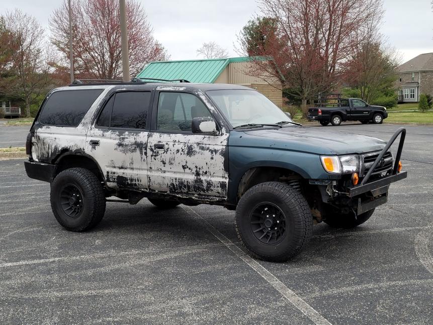

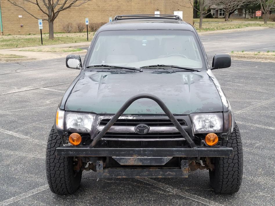

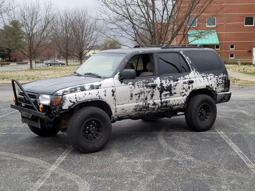

Well, mine was a bit unorthodox...I went after what I though was a crappy spray paint job with carb cleaner and a pressure washer cause it kept chipping off...turns out, it was a crappy plastidip job....and despite not getting it all off, I am way more pleased with the results than I should be...also realized my hood and fender are my 2 favorite 4Runner colors, but the rest is silver.

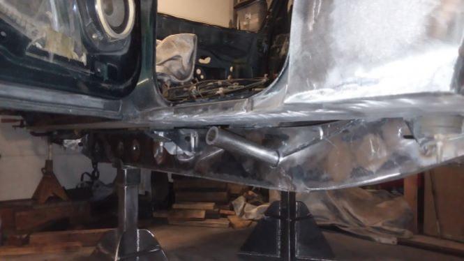

Ironically, these sliders taught me how to weld ;)
They may also teach me how well my welds hold up in real world stress tests.������

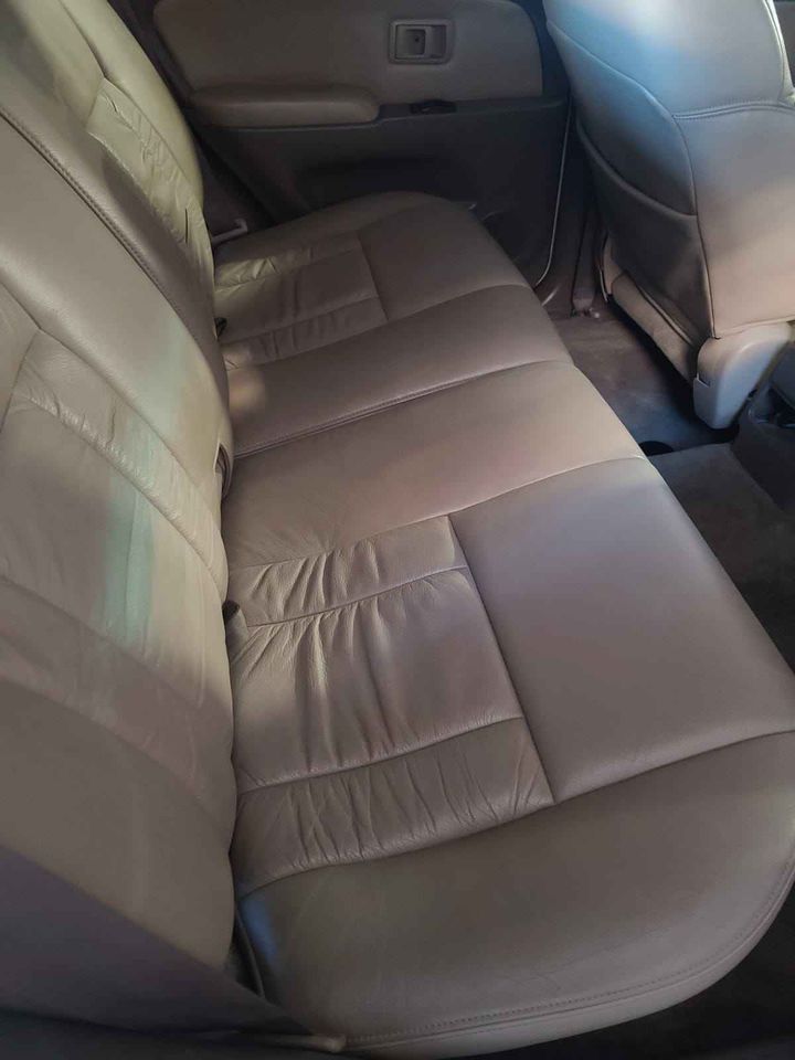

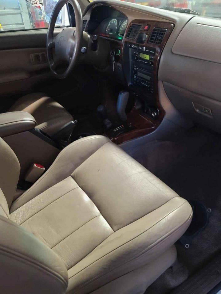

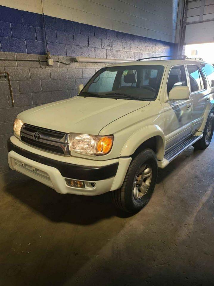

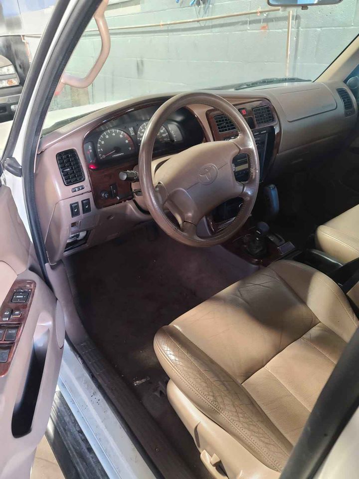

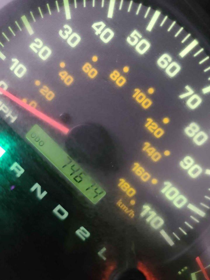

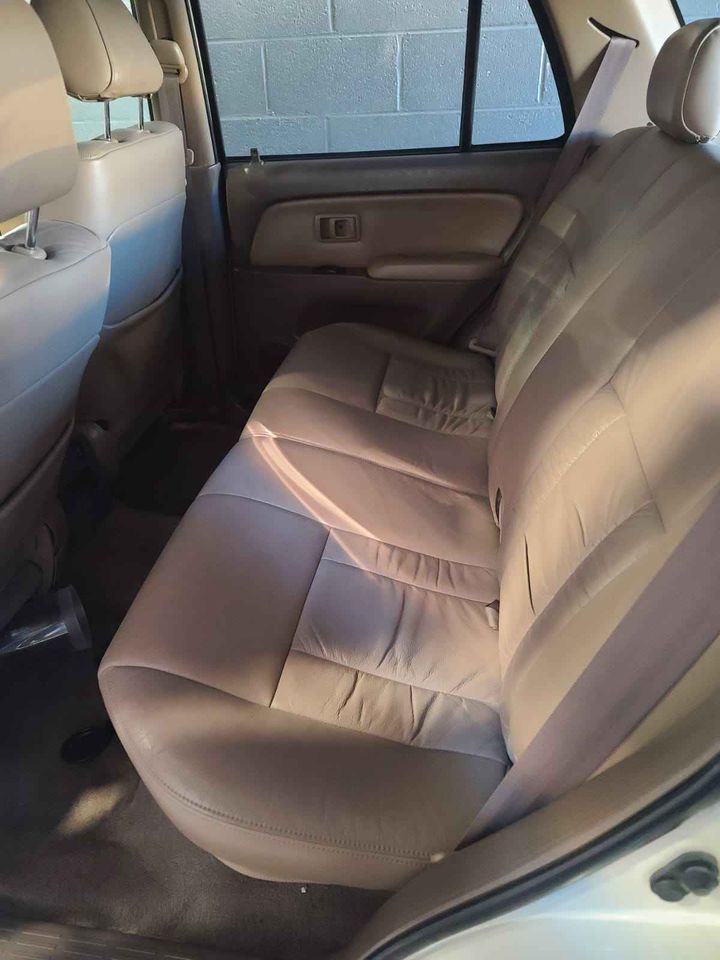

Hello,
For the sake of discussion and more information. What do you think the resell value of this car would be?
In addition: Is bring a trailer worth it for the sale?
Specs:
Miles Driven 78,674 miles
Tran: 4x4
Condition: good-fair

Somewhere between the change in my couch and 50 trillion pesos. Gonna need a lot more pictures of interior, exterior, frame, engine bay, and any problems before anyone can give you an accurate guesstimate. The more info you give the more accurate people can guess.
Hello, thanks for the replay. I assumed there would need more photos. I have a video of the undercarriage which is pristine, however, don't know how to upload it.

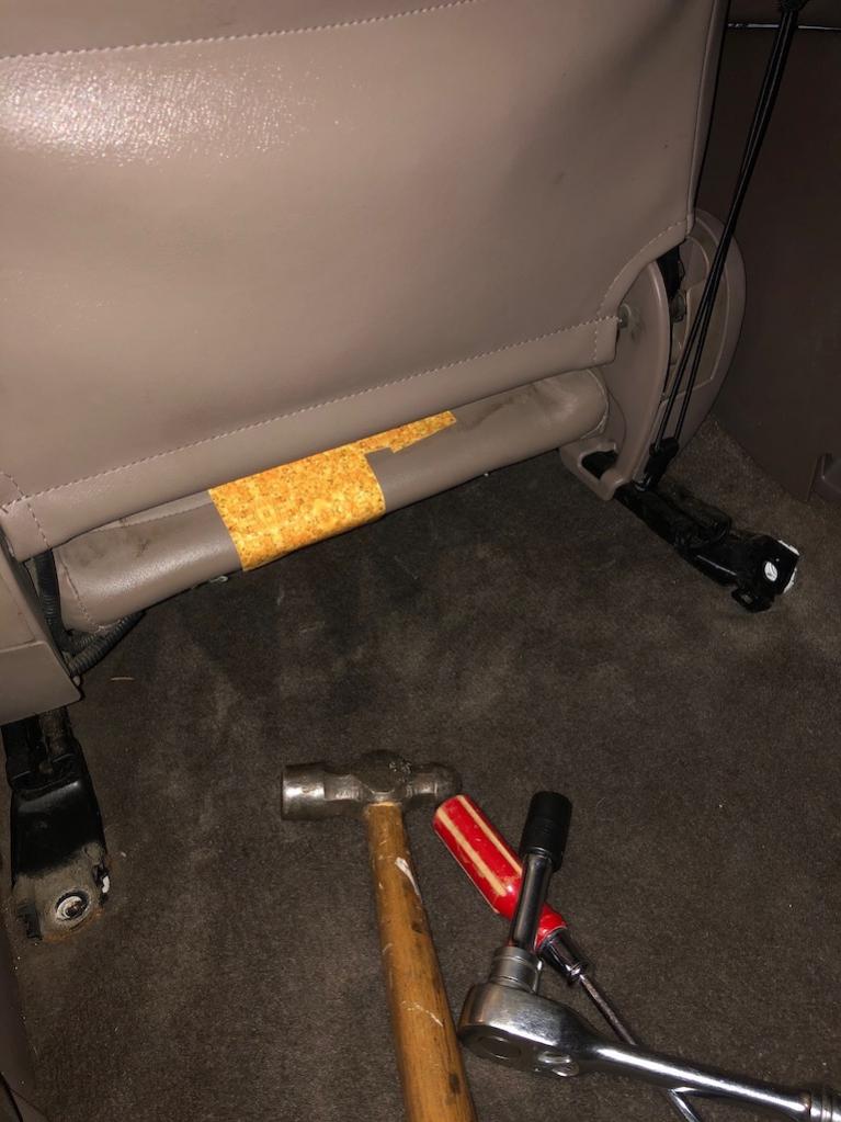

Pulled my front seat rail bolts out today in advance of my bottom seat pan removal. Getting the bottoms repaired with vinyl. Still trying to make a decision on the heated seat install.
Was pretty cautious after reading all the threads about the damaged /fractured bolts. The 14mm bolts came out pretty easy, the most difficult were the rear outside bolts that thread through to the bottom on the outside. A bit of penetrant and a hard whack with screwdriver and hammer did the trick. I was pretty cautious tightening and loosening each bolt slowly and worked out perfect. The metal around the bolts were in pretty good condition.
i've been soaking all my bolts in vinegar then applying anti-seize with all my projects prior to fastening. Anyone else doing this?

Nice! Well it depends on your location. And how much info you can provide to show it’s been well taken care of. There is a 01 limited with 90k miles local to me going for 20k right now. It looks brand new. Not sure if he will get that much for it but that’s what it’s listed at.

Based on the what people are posting them for right now 18k
