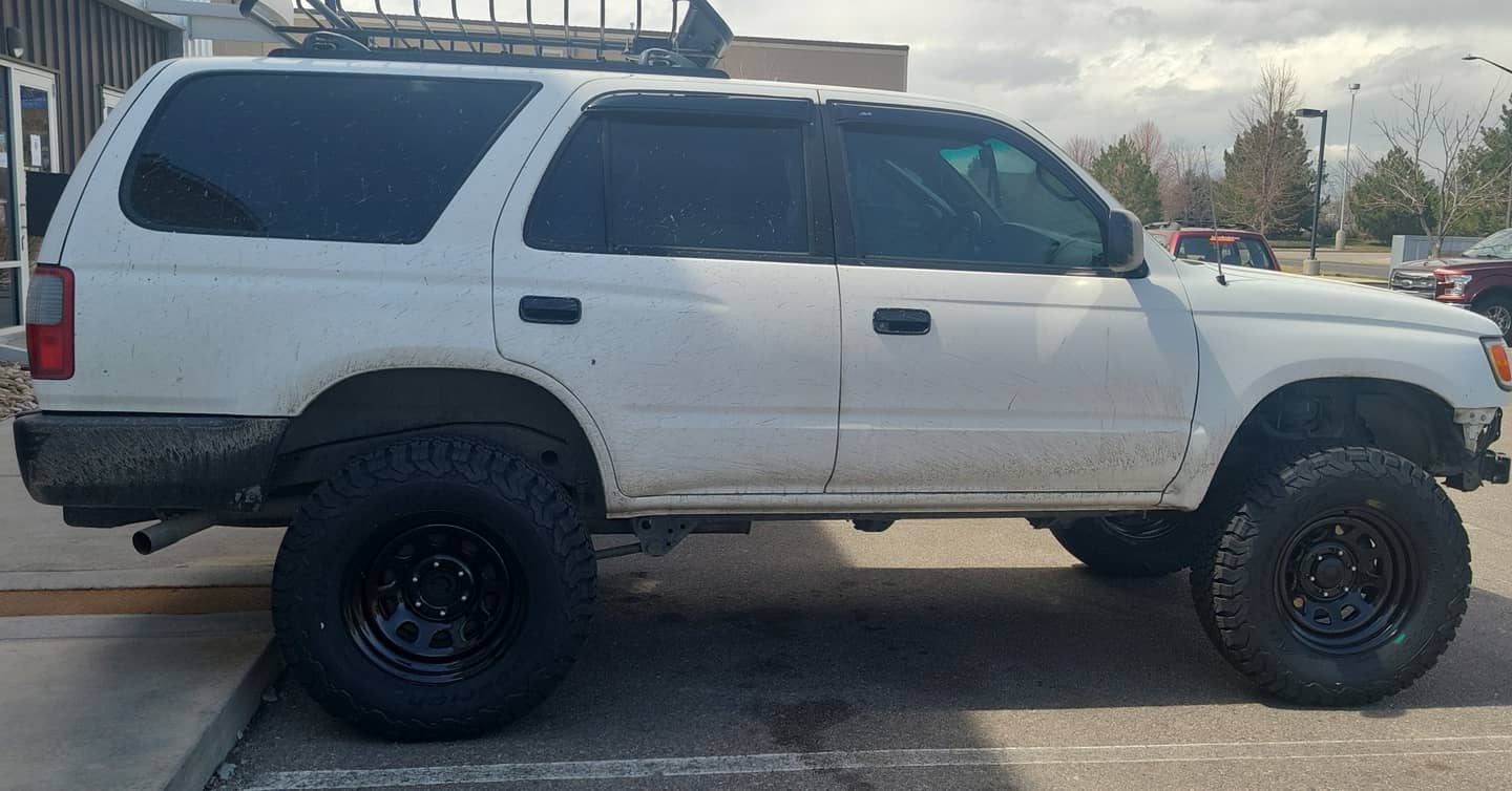

Warn front receiver, Baja rack, SLAP by Joe, and I gave her a bath!
Got my baby back yesterday, new ball joint, new wheels + tires. Went with ProComp 51 Series, 285/70/17 BFG K02 tires. It's about to go to my local shop for a steering rack leak and some other small items. Need to attach my gas can mount, Maxtrax mounts, full skids came in yesterday. I'll have a busy weekend! :)

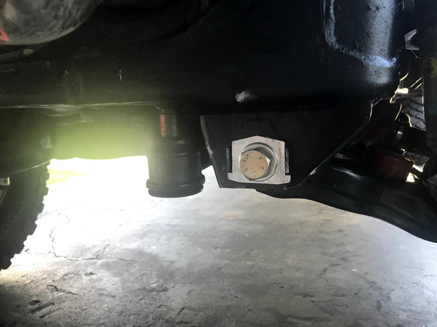

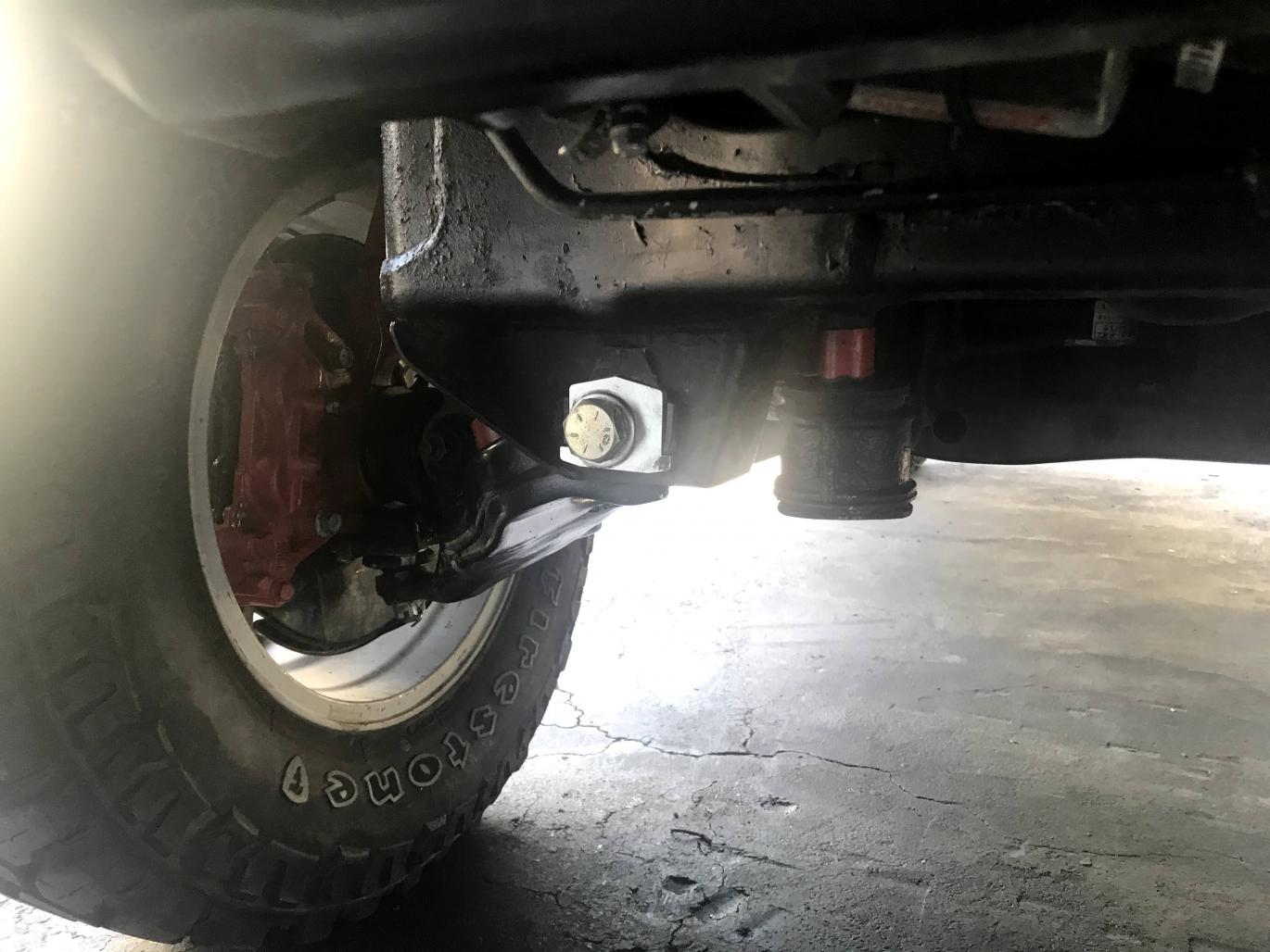

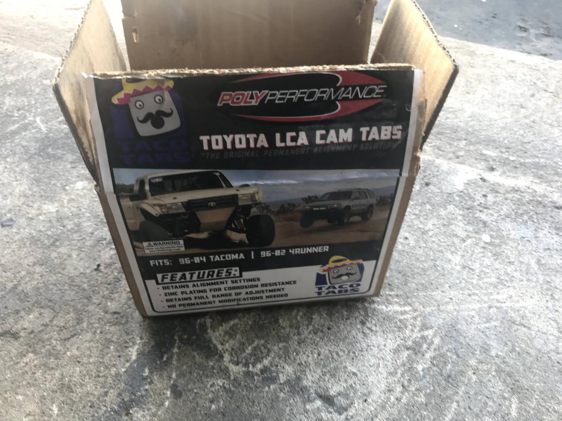

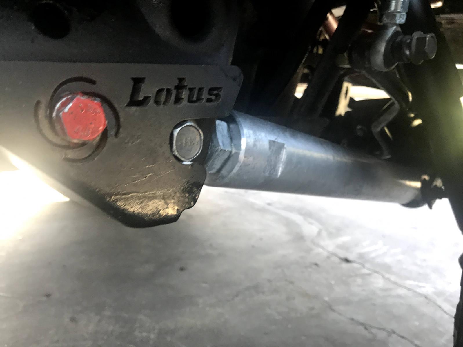

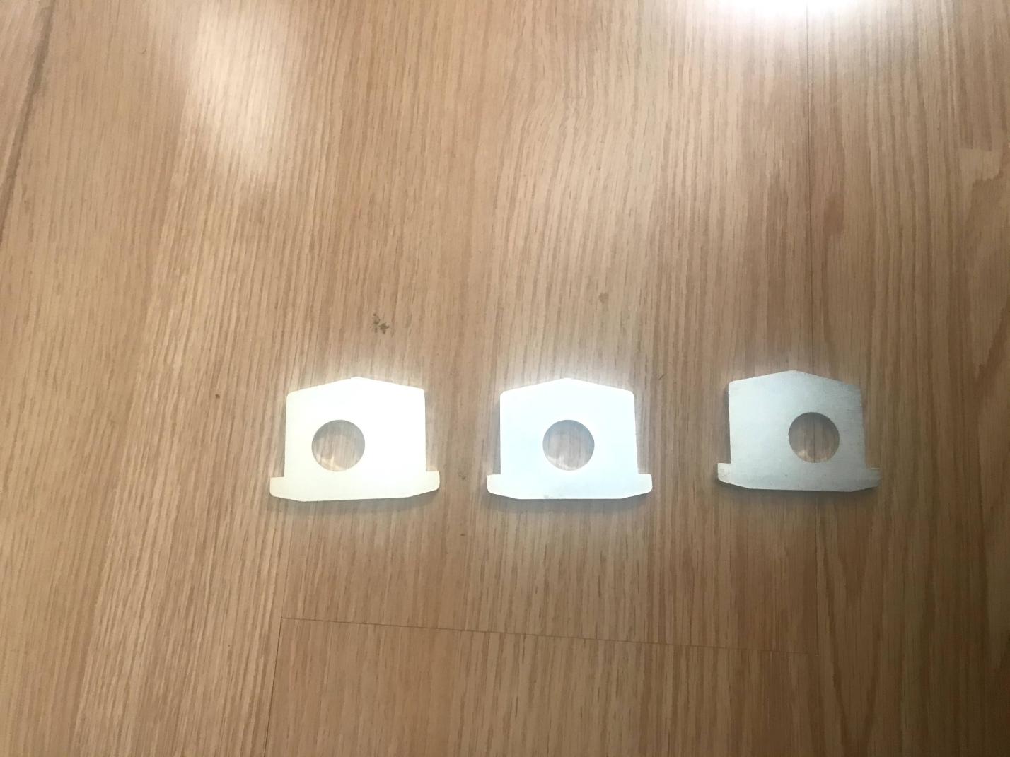

3rd gen custom rear links and front control arm rebuild
I finished putting together some custom rear lower links and rebuilt the front lower control arms.
I put together a set of custom rear lower links and purchased a pair of Left and Right treaded Summit Machine Flex Joints with a custom set of Wide Open Design 7075 Aluminum links.
The front lower control arms were blasted, welded eimkeith reinforced brackets, installed new Sonoran Steel lower control arm bushings. I also installed the Poly Performance Taco Tabs cam delete so hopefully I will not need another alignment after wheeling with the Keystone Cruiser.

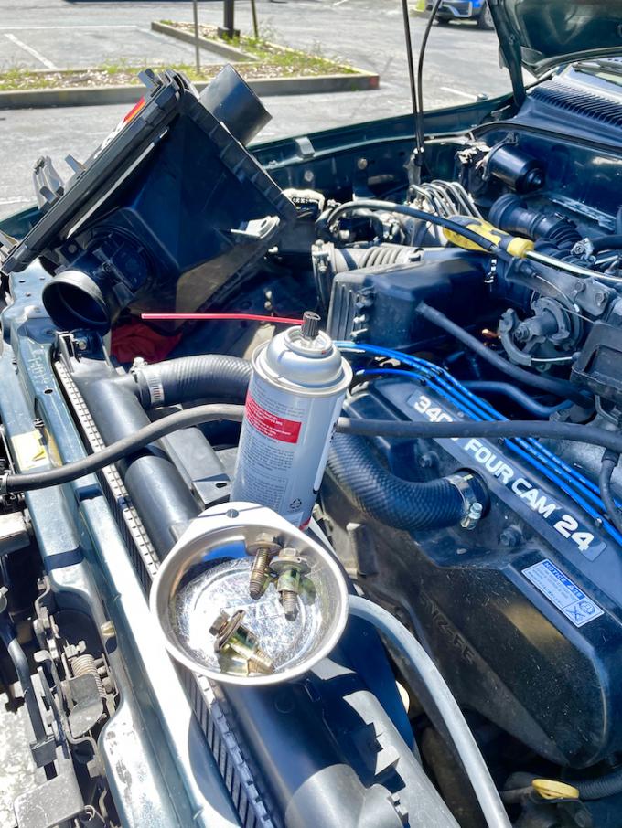

Nothing of great interest here, but I have a 30 minute lunch break so I blasted the MAF sensor with some CRC in the parking lot. The little things add up.....
Edit - I am still pre-smog and leaving as little to chance as possible. The CRC can claims a measurable performance boost, so there's another 1 HP for the butt dyno.
I had a persistent P0420 (for about 2 days) that appears to have been fixed by doing a better job clamping the cat-back exhaust system together. 700 miles and no Pending CEL.......
Another Edit - looking at this pic reminded me that I used the Cruise Control last weekend for the first time since owning this 4Runner and it worked pretty darn well. Never been a CC guy but it was OK for parts of a 1500 miler....
I've been seeing these plates quite a bit recently, can someone explain what the purpose is?
Edit; nevermind, I get them now! Might have to snag me a set
