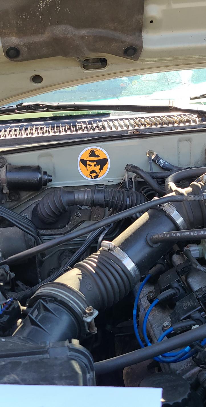

yet another sticker :cowboy:
ok....one...I dont know who the sticker is
two....looks like your running th ebig 3 wires
three....on the resonator delete...is that something you made your self....im about to make one myself just was not sure how or where to attach the vac line
The vacuum line connects just below the two throttle cables if I remember correctly. Should be the same line that originally went to the resonator. Some void this and simply loop the line back to some other part of the intake plenum but I see no reason for this besides cleaning up the bay a little more
Sticker is Blaze Foley
