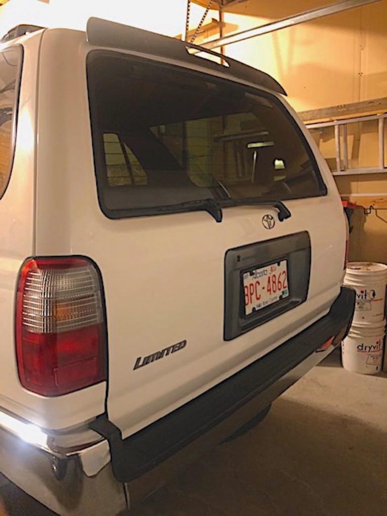

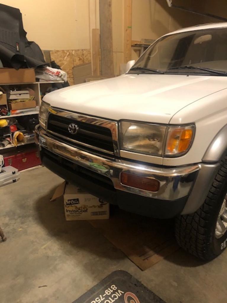

Polished the headlights/tail lights and signal lens with Mothers Mag Polish. Came out great. Did the front grille and chrome bumper as well.
Also received the new rear wiper arm and blade and got that installed.

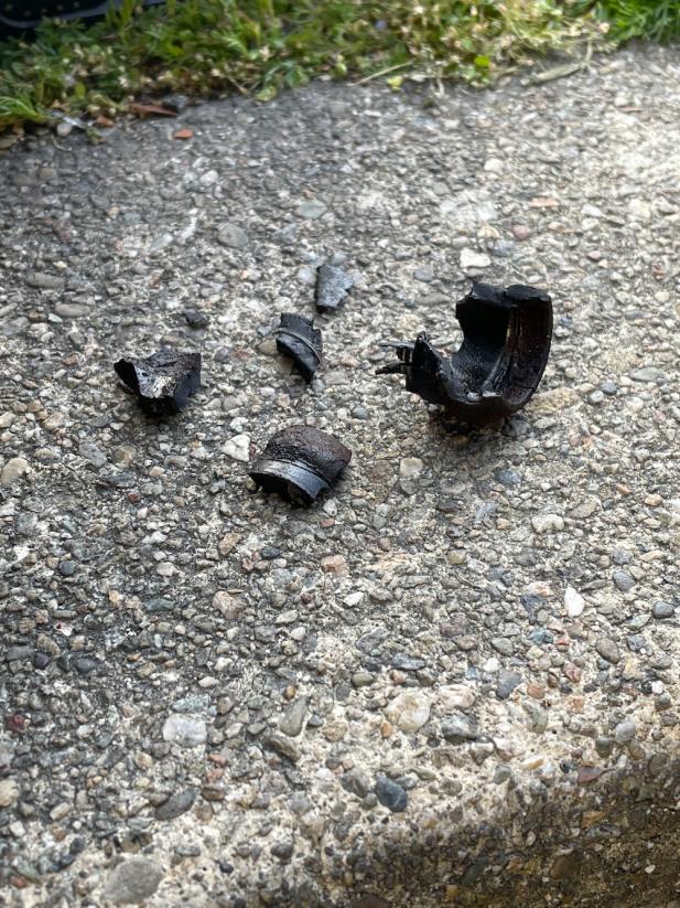

Not at all exciting, but I replaced my PCV hose, grommet and valve. The entire lip crumbled to bits and then of course most of what was left in the hole fell into the engine. Luckily some needle-nosed pliers and a flashlight were all that was required to fish the bits out. Don't hesitate to plow ahead with this, as the bits don't actually fall too far inside.

another reason if dong valve cover gaskets to do this one too
