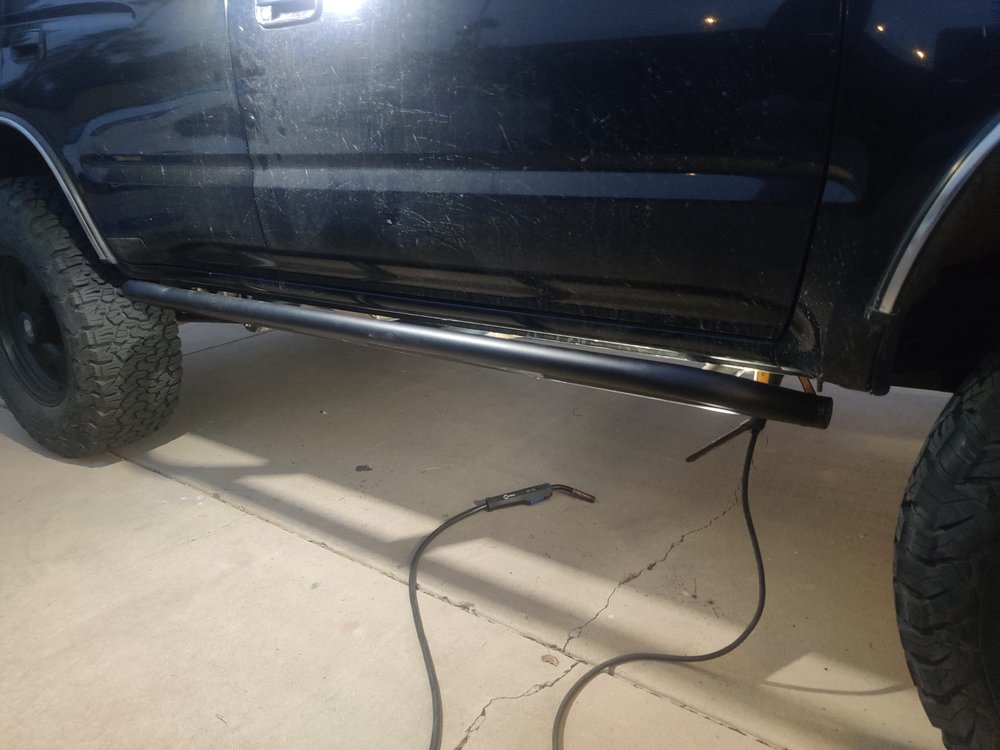

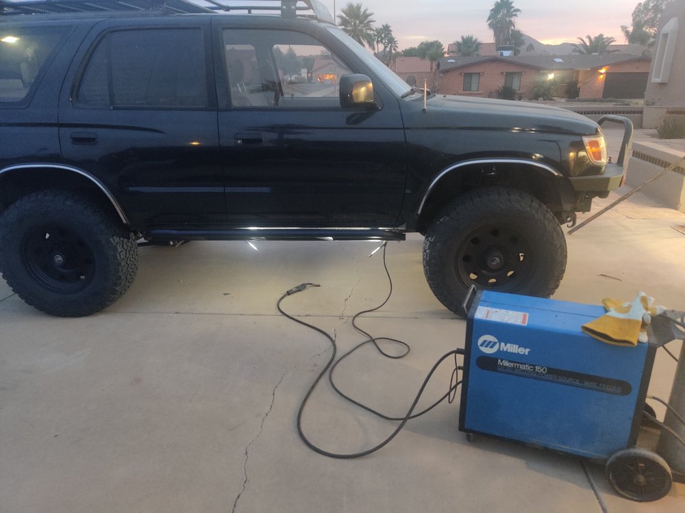

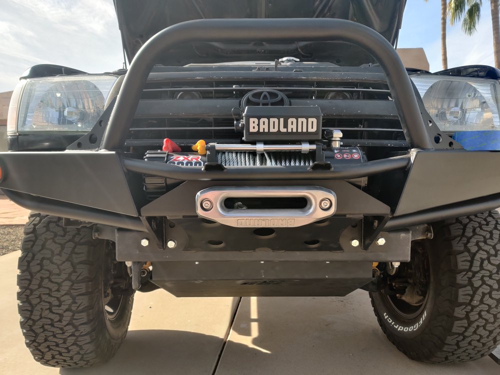

My Co-worker was nice enough to weld on CBI my sliders for me and i trimmed in my grill over my winch control box.

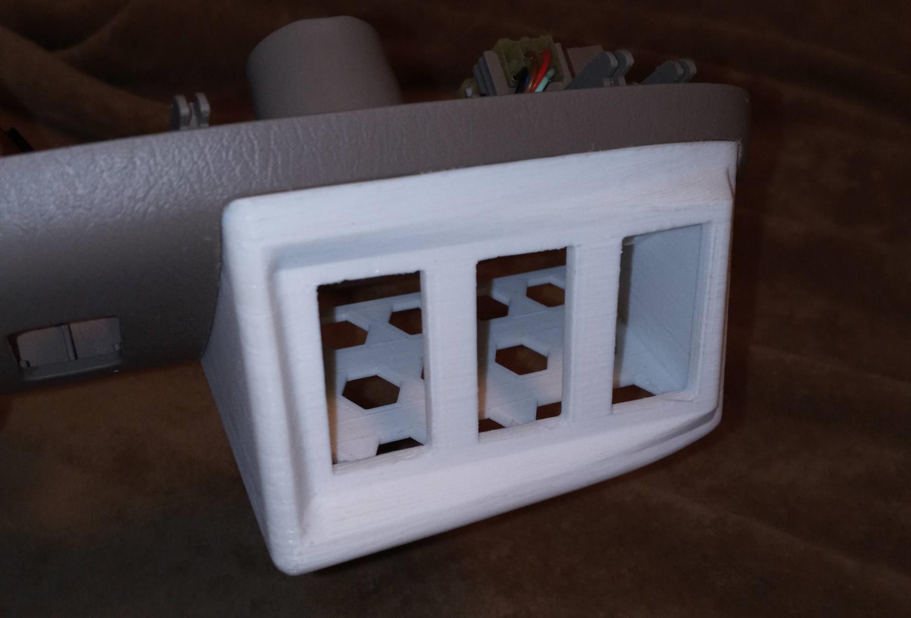

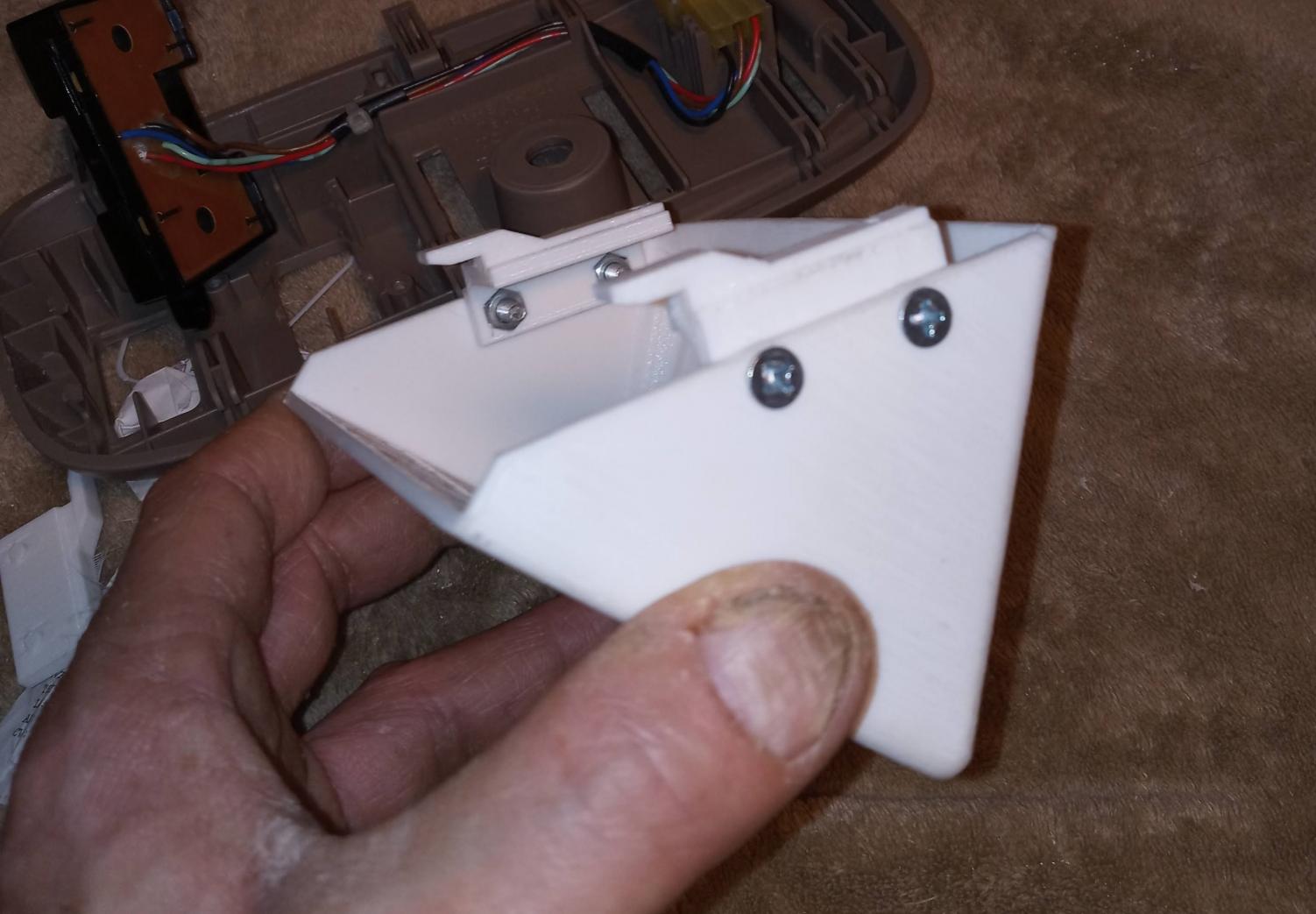

Early 3rd Gen Toyota 4Runner Overhead Switch Console
Revisited an old model I teased on here many many months ago, thought it's time to share for anybody interested. Sent a completed one to a member for evaluation/critique but never heard anything from it. Fits the early 3rd gen overhead console. More details can be found on Thingiverse (options, fitment, mounting, etc)...
Early 3rd Gen Toyota 4Runner Overhead Switch Console by dylan77 - Thingiverse

Pics and details are in the link...figured anyone interested enough would check it out where it's available for download. Not really into starting a new thread for this thing, it started out as a personal project and sat on the backburner for 11 months now...the excitement of an idea becoming a legit object left long ago (and the dude who got the first article then ghosted himself didn't help). If the need arises I can start a link to answer questions or gather feedback for any tweaks. Just really wanted to put it out in the world for more options for us early 3rd gen guys...

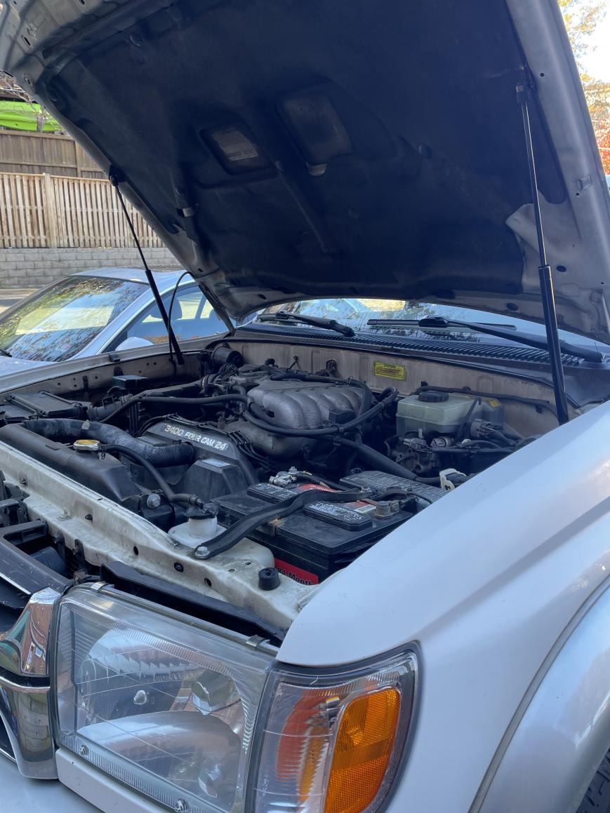

Spiker Engineering Hood Struts
Has anyone ever worn out their struts on the first day? These things are awesome and I can't stop raising the hood! Installation couldn't have been simpler. Thanks tons, [MENTION=198376]4Runner4Leon[/MENTION]!
Do you have any pics of this thing installed?

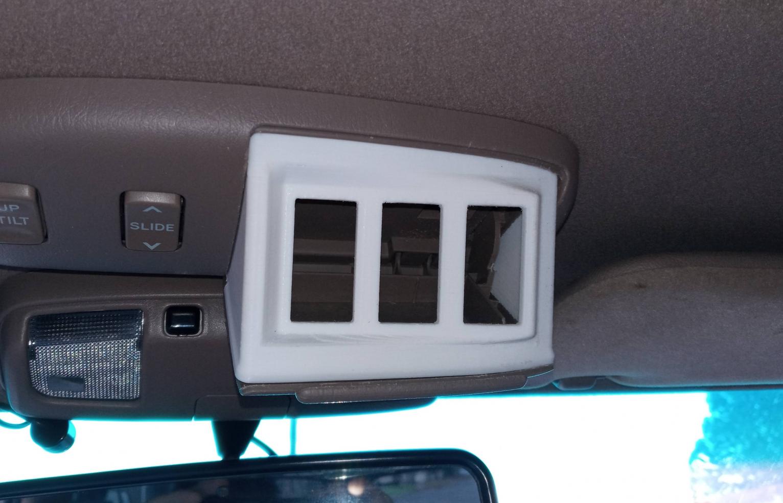

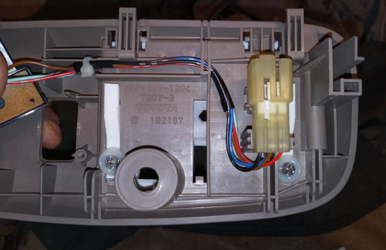

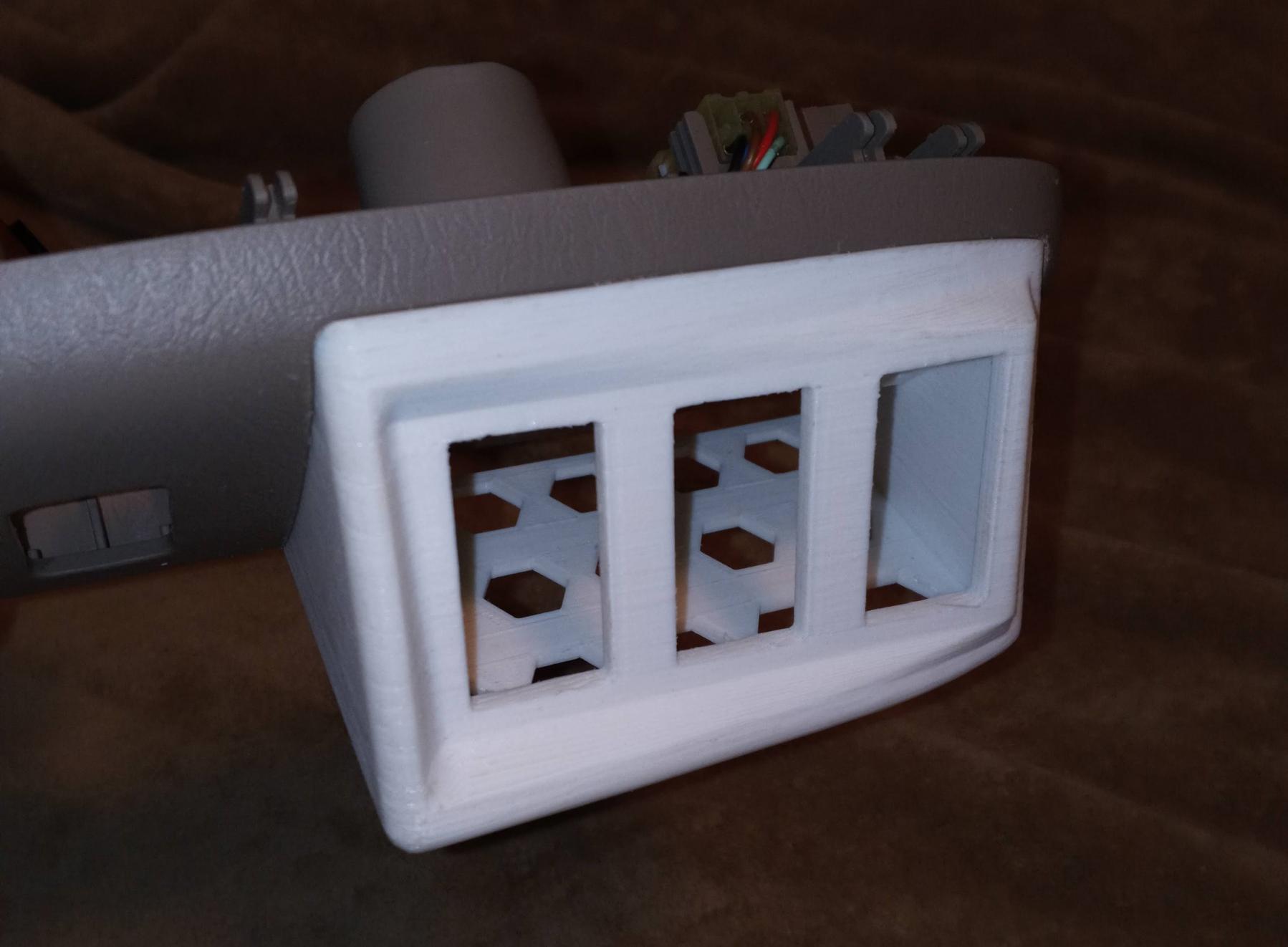

This is generally what it will look like installed. This is one of the first versions where I was trying to keep the door and use it as some sort of mounting solution but I wasn't happy with the fitment. You'll see the gap around the panel and the contour...that is fixed. Here is another pic with it together, ready to mount. Unfortunately I sent the working model I had installed and ran for a few weeks to that member who dropped the ball...

Managed to get my Spiker struts on without injuring anyone seriously with the rivet gun. I now have a coveted "Hood / Trunk Prop Rod" (Part# 5344135021, now discontinued) in my possession that I'm willing to part with for a reasonable price if anyone feels compelled to make an offer. I hate to part with an object of such sentimental value, especially around the holidays, but I realize there may be others out there who are less fortunate when it comes to prop rods. Of course, for the associated prop rod grommet, you're on your own. Good news is, they're still available.
I'm still debating what to do with the 12V Denso Buzzer that I removed from the passenger side strut hole, but I'll keep everyone posted. Right now it's just kind of hanging out near the firewall.
