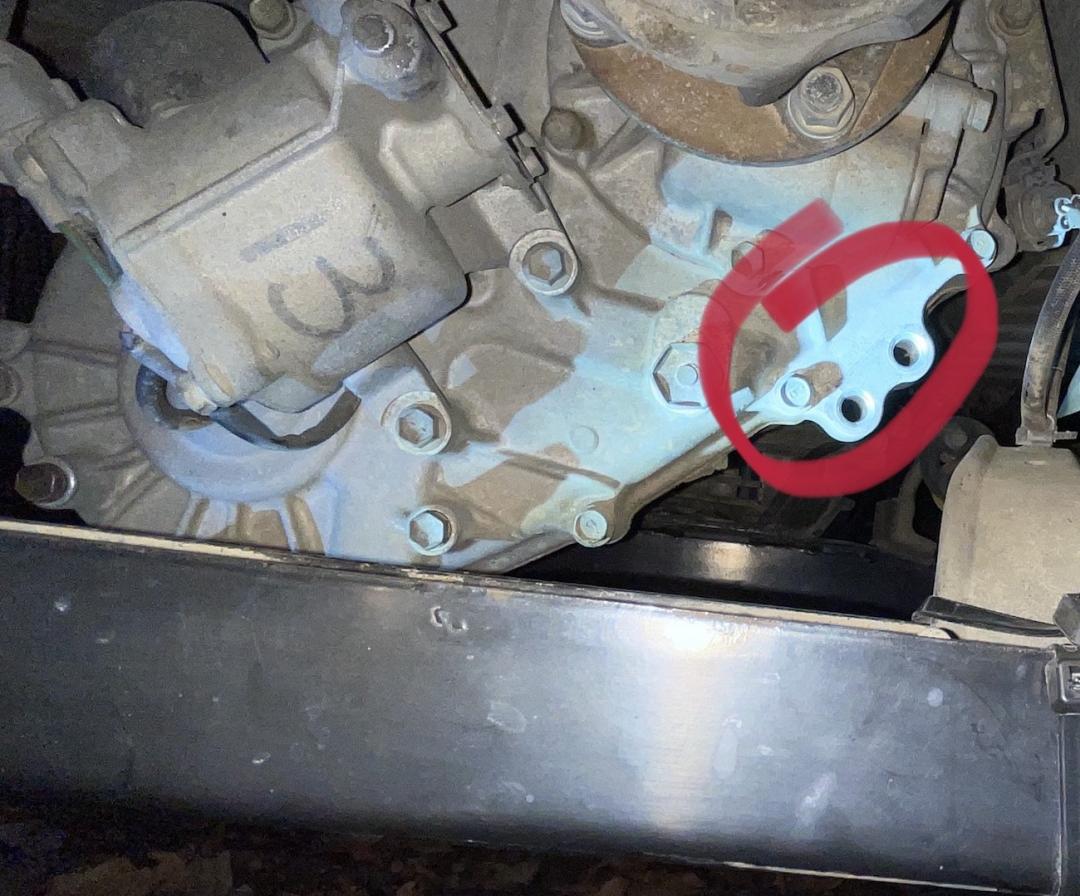

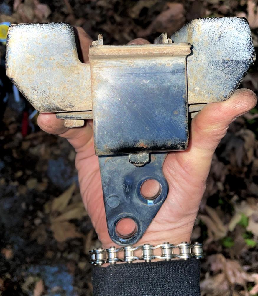

Rather boring, but I removed the vibration dampner from the T-Case since the skid it has been rubbing on was off anyway. Didn't notice anything at the J stick or feel or hear anything in 4WD or at any other time so I'll leave it off for now. The rubber between the U-shaped weight (which weighs at least 5 lbs, feels like) is torn anyway. I reinstalled the mounting bolts in the 2 holes shown because they are a bit special - very fine thread, marked 9, and have a captive washer. Just in case I feel the need to put one back on....
I did this on my son's '98 limited several years ago. He developed vibration in the driveline. We crawled under the car to discover part of the rubber was missing on the dampener. It took us a couple months to find a decent replacement in a salvage yard that still had one. After all that work of replacing the dampener, the vibration was still there. The problem turned out to be the driveshaft itself. :shrug:
