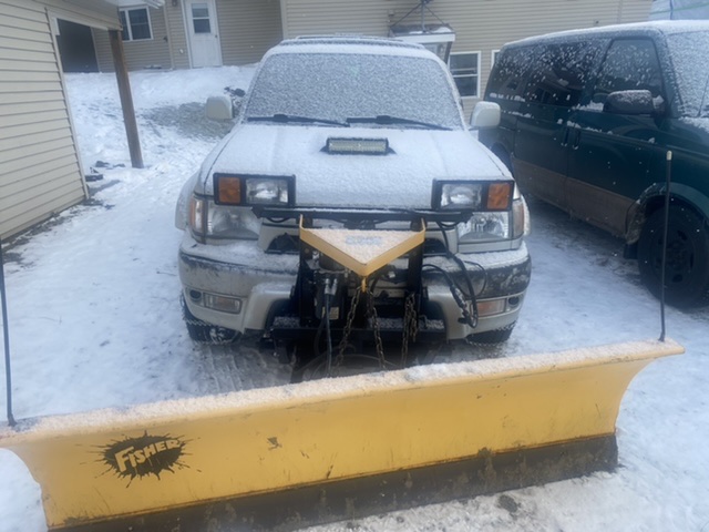

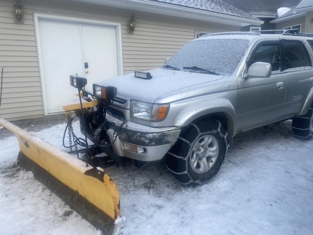

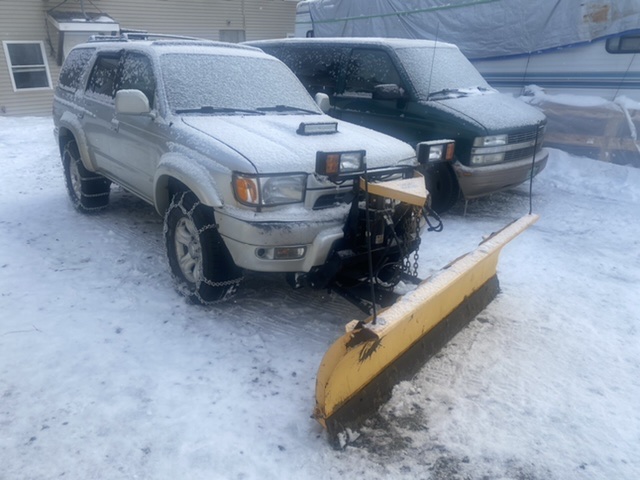

A hair different than the usual 4runners posted here…the plowrunner set up! Pushes like a champ with the chains. Big 3, 220amp alt upgrade to accommodate the plow and lights on top of the normal vehicle draws. The frame has beaucoup rust damage in the rear so it’s a yard truck till complete failure. Hopefully a few seasons.
