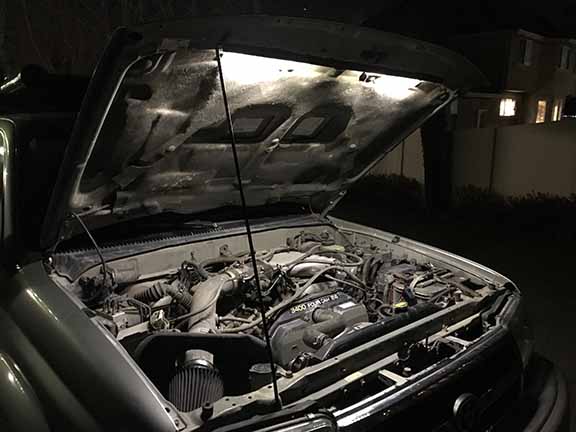

Installed hood lights. The cheap LED strips I got are a lot brighter than I expected, I think it turned out great.
I'd like to get an auxiliary fuse block to stay organized as I start adding lights, but I'm not sure where to put it yet.
