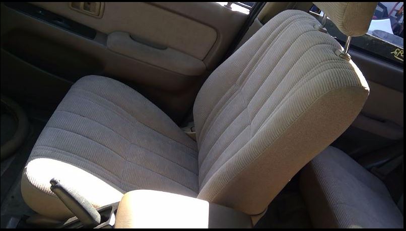

Here's a pic of a regular cloth seat.
Eddie
They just look like regular cloth seats to me. What’s the difference?
EDIT: I should have phrased that differently. They look the same as the cloth seats (dimensionally) in my 2000 SR5 and I have not been able to find anyone stating sport seats are x inches of seat back side bolster protrusion over SR5 cloth seats. I also haven’t seen enough cloth seats from 01-02 to know if the sport cloth seat fabric was different from a base seat fabric.
The reason I’m looking for that information is to know if the seat bottom and back cushions for a sport seat will work with my base seat covers. The base seat cushions are unavailable. If the sport seat cushions are dimensionally different enough then my base seat covers aren’t going to fit correctly.
Eddie
Thanks man. Between this pic and the specs link from further up I figured out I do in fact have sport seats in my sr5 as a package option.
I now remember seeing something about a 'sport package' in the originating dealer VIN details for my vehicle on the Toyota Owners website. Always wondered what that meant exactly.

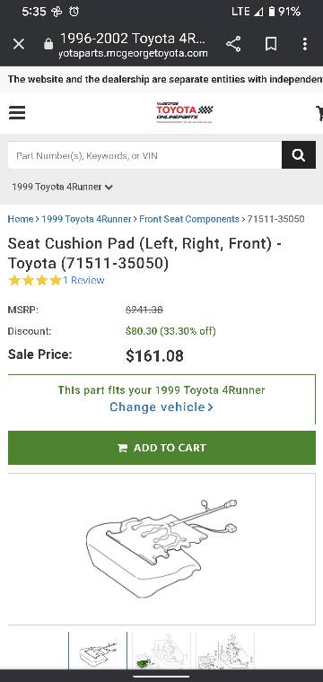

See attached.
Eddie
are these seat sections side specific? - also are these the "Sport" style cushions? the sport ones are nice because they have a higher bolster.
appreciate the info
They appear to be universal
appreciate the info
They work for left or right, and they're for Limited and Sport seats. The base/normal seat foams are discontinued. Do you currently have sport seats?
