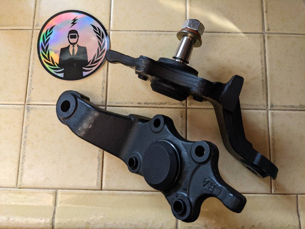

Spindle gussets! More deets in my build page.

You didn't get the matching LCA reinforcements? Tsk tsk :fish:
LCAs are not a solid-mounted, single forged arm 22" long that carry the rolling weight of the entire front end, they are boxed and ride on bushings.
I plan to reinforce my spindles, too, favoring LCA skids plates over reinforcement.

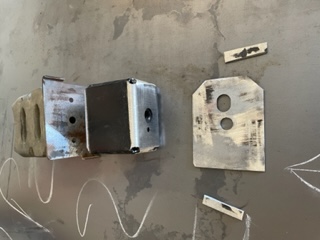

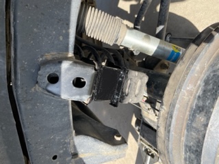

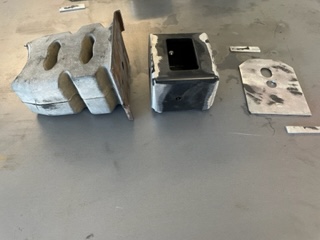

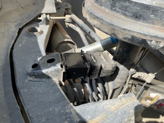

Installed an ARB bumper awhile ago and decided to repurpose the frame rail extension pieces that came with the bumper for a Tacoma. To extend my bump stops, I cut a piece of flat plate, drilled a hole in the middle and stacked the plate on top of the extension piece, with the extension piece on top of the bump stop. I tacked everything together along with some tabs on the plate to keep it from rotating. I used some longer bolts (m8 x 1.25 (course thread) x 90mm) to attach the extension.

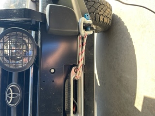

I also swapped out my steel cable on the winch to rope. I won’t be using a hook so I made a sacrificial rope loop to keep the winch rope protected from uv/trail damage. The sacrificial rope loop is double braided polyester. I found a YouTube video that explains how to make it.
