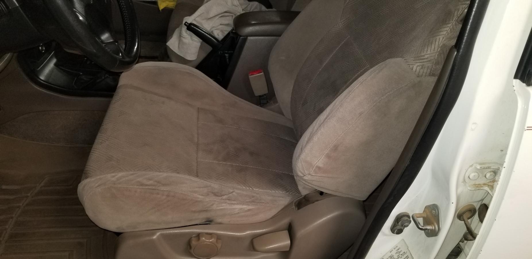

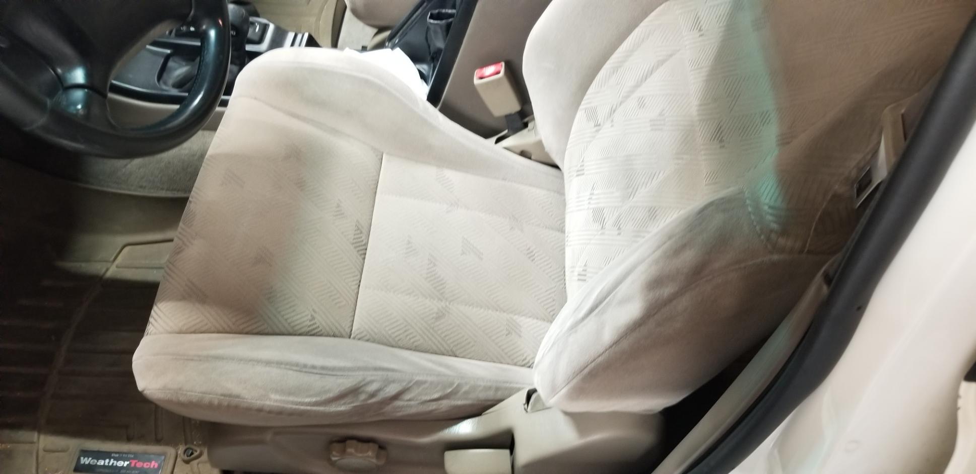

Replaced the seat back and seat cushion in the driver's seat.
The seat back bolster was really crumbling and deteriorating and the seat cushion bolster was almost as bad.
I went with OE foam. Pricey for sure but amortized over 10+ years, it's nothing.
Much different ride while in the seat and should be good for as long as I'll be driving. I do think I'm going to have to rise up a bit more when entering and exiting the vehicle as I notice the foam sticks out and up more and years of hitting it cannot be good for its longevity.
Job was not too bad just time consuming since it was my first time. There is a very helpful video on youtube on Andy Loechler's channel.
I suggest buying a hog ring kit (mine had angled pliers & 300 rings) on amazon for about $16 before you begin the job. Zip ties can be used in a pinch but I did not think they'd stand the test of time and I have no desire to do this all over again because zip ties break after a few years due to age and the stress/pressure the rings are subject to.
Here's a before and after pic. Happy to answer any questions.

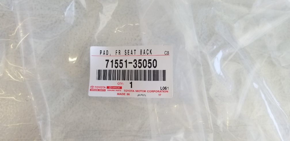

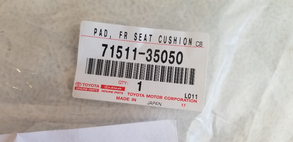

I was looking in to this earlier and there were different kinds and couldn't figure out if I have "sport" seats or not. My seat looks like yours do you have the part numbers you used?

See attached.
Eddie

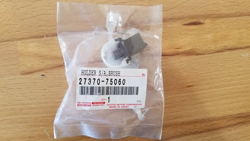

Replaced the alternator brushes which had been on the to do list for quite a while. I used a c-clamp to push that pivot bolt sleeve flush with the pivot mount so the alternator went back in super easy. What I had a problem with was getting the terminal nut off it felt like it was going to snap. It took some patience and trying a bunch of different pliers to get a decent grip on the sides of the crimp connector where it wouldn't damage anything so I could stop it twisting. The insulator nut wasn't tight enough and the terminal nut was too tight. Tightened both to fsm spec when putting it back together.
Pretty easy job overall.
