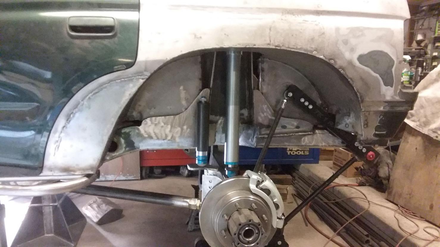

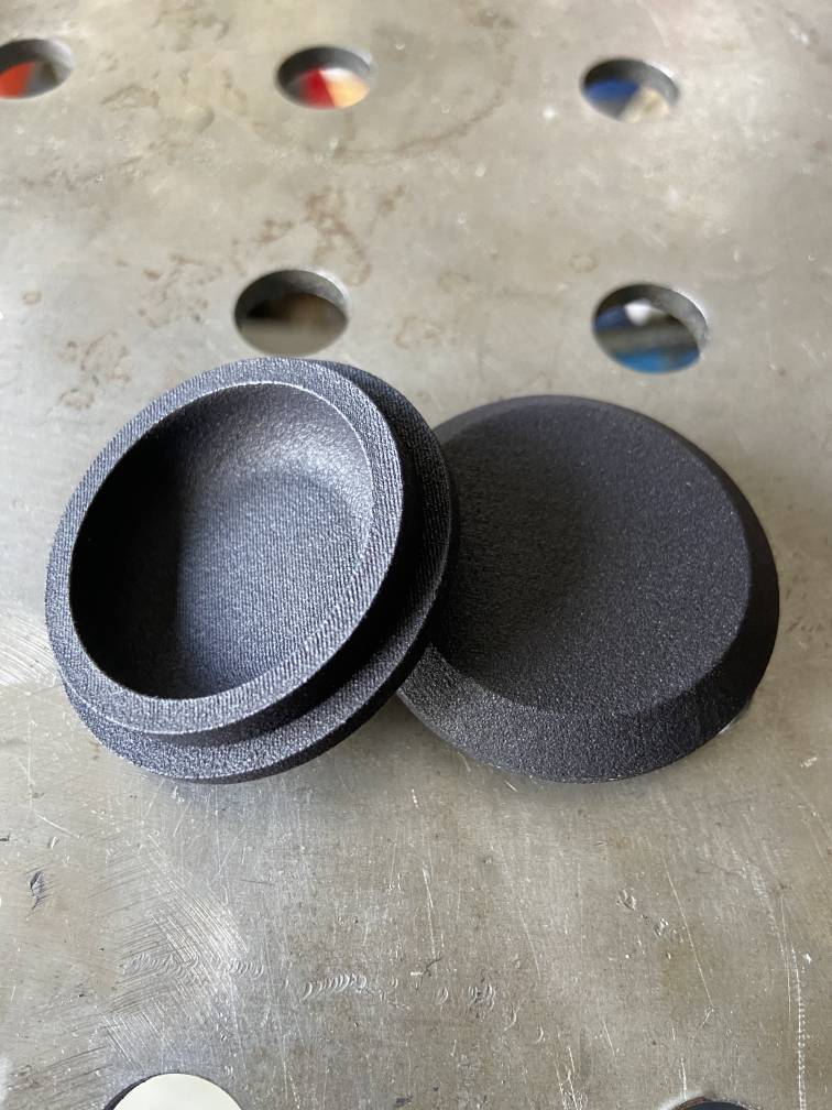

There is a 3D printed cap covering the uniball bolt that you can see in my pic, and here
I'll ask [MENTION=118730]AssBurns[/MENTION] his thoughts about adding a boot, maybe [MENTION=102606]infamousRNR[/MENTION] can/will chime in, too

Corroborated with Josh from Anon Fab yesterday. No boot.

guess I did not notice that they were not stock LBJ which does have a boot

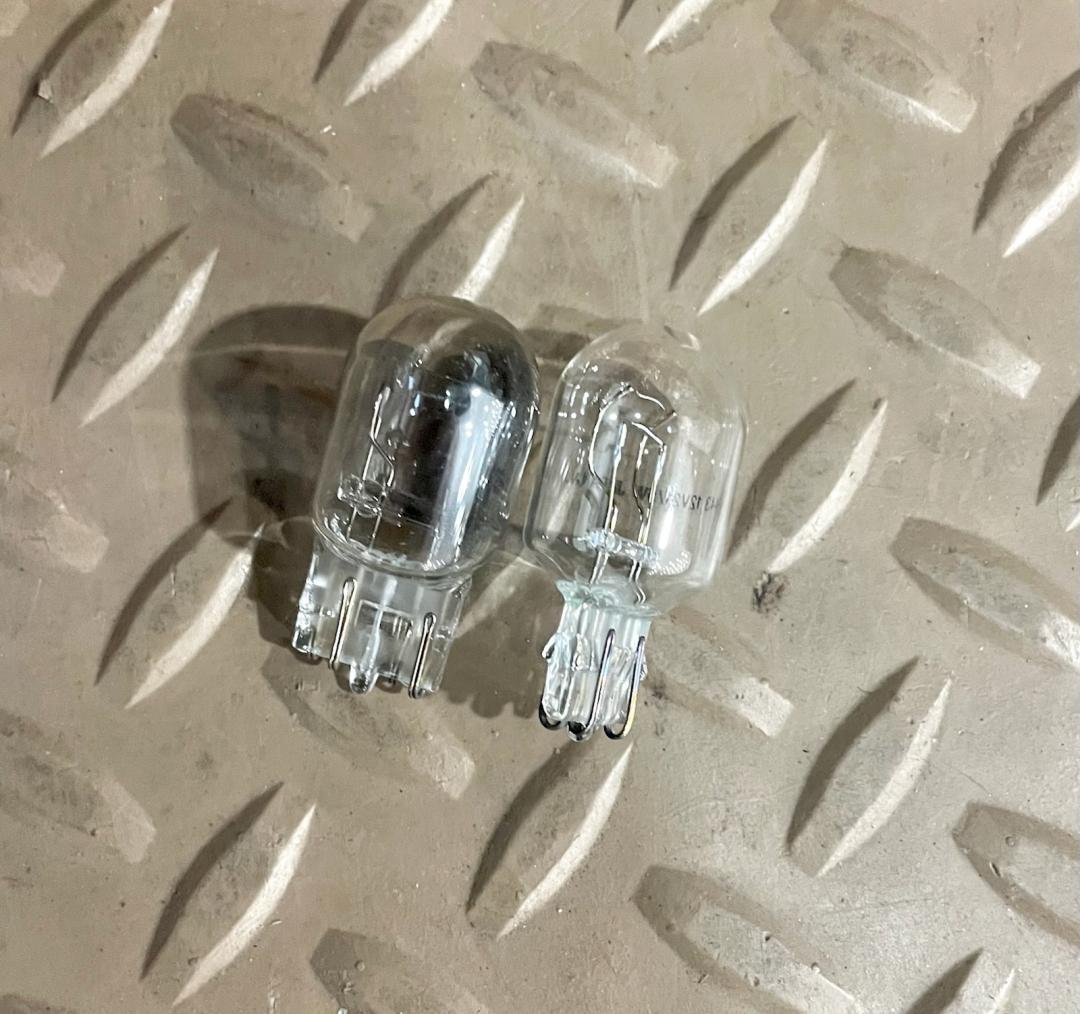

Today, I changed out both of my brake light bulbs as they both were out! (how did no one tell me I had no brake lights?! I'm truly thankful no one rear ended me too. Yikes!)
Strangely enough, (or perhaps not a coincidence at all, but perfectly intentional by Yota?) I had been dealing with an intermittent ABS light on my dash in the days leading up to the realization that the bulbs were burned out.
Now that the bulbs have been replaced, the ABS light has not come back on.
Is that something y'all have seen before? That the ABS light is an indicator to check everything over in the system, including the lightbulbs themselves?

I’m interested to see how these turn out for you. I bet we can find a lower boot for these things too just to keep the dust off.
LC boots would probably work, or perhaps use the Energy boot finder page
Please Wait... | Cloudflare
There's just nothing to attach a boot to at the base, so it's just a "pressure fit" from the spindle holding the boot down
