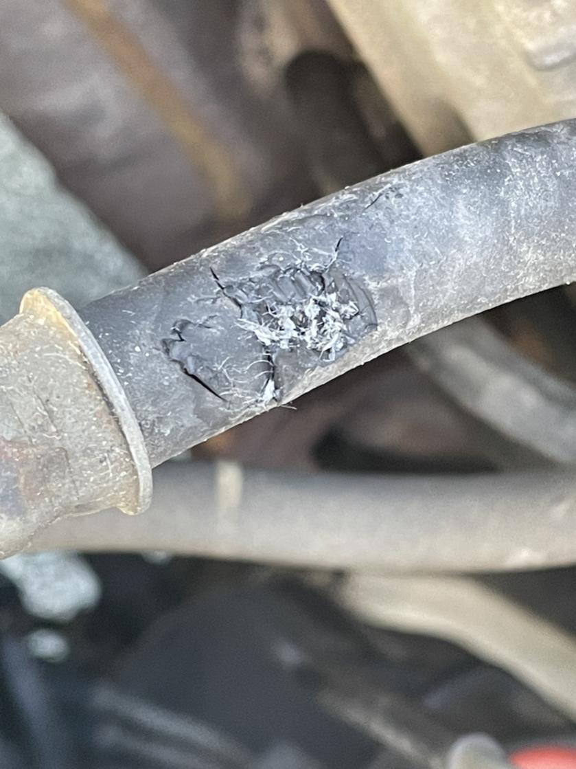

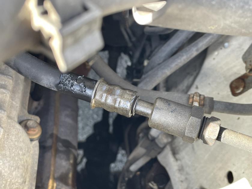

Averted catastrophe.
Strong smell of gas on a quick trip out for two Mickey Ds cheeseburgers (no, pickles, no buns). Pulled off the road into an empty "Just Tires" parking lot.
I suspected that my spare fuel containers in the back were leaking. Opened the rear hatch and found .... nothing. No gas smell. Returned to the front. Saw gasoline spilling out from under the hood on the drivers side. WTF?
Cut the engine. Popped the hood. The fire blanket on the hood is soaked in gasoline and dripping all over the place. JFC. I ripped the blanket off the hood and cut the engine off.
Went back to the front. Turns out that I had a ruptured fuel line. (See pics.) Gasoline everywhere but no fire, luckily. I called a tow truck and had it towed to my local stealer where I left the key in the drop box and a note: "Ruptured Fuel Line, DON'T DRIVE!"
Moral of the story, I guess, is to check your fuel lines as part of your routine maintenance if you have higher mileage. I'm at 297,600 miles.
This could have been 1,000 times worse. I could have lost the vehicle to fire or been stranded in the middle of nowhere. As it turns out, I was less than 1/2 a mile from the dealership. So $95 for the tow. Probably going to run a few hundred $$ for the fix but so what?
Note: The gas smell had been present here and there for a few days. I suspected the gas cans in the back so never checked under the hood. That was a major mistake. Could have been worse. Story of my life, I guess.
Note to self: procure a fire extinguisher.

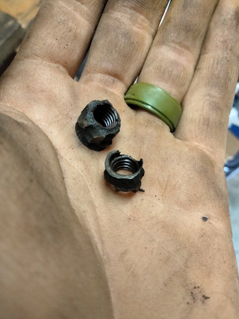

I couple days ago I replaced both of the o2 sensors on my 99 limited. Up steam and down stream . Holy cow those nuts were hard to get off. I soaked them with PB blaster for a few days and ended up using a torch to heat them up and a box end extractor wrench to break them free. Talk about a pain in the butt. I went with denso sensors from rockauto.com

That could have been very bad. Just curious but any ideas on where you would mount your fire extinguisher inside? I have thought of doing this but never got around to it, I should probably do it soon before wild fire season starts. Better safe then sorry.

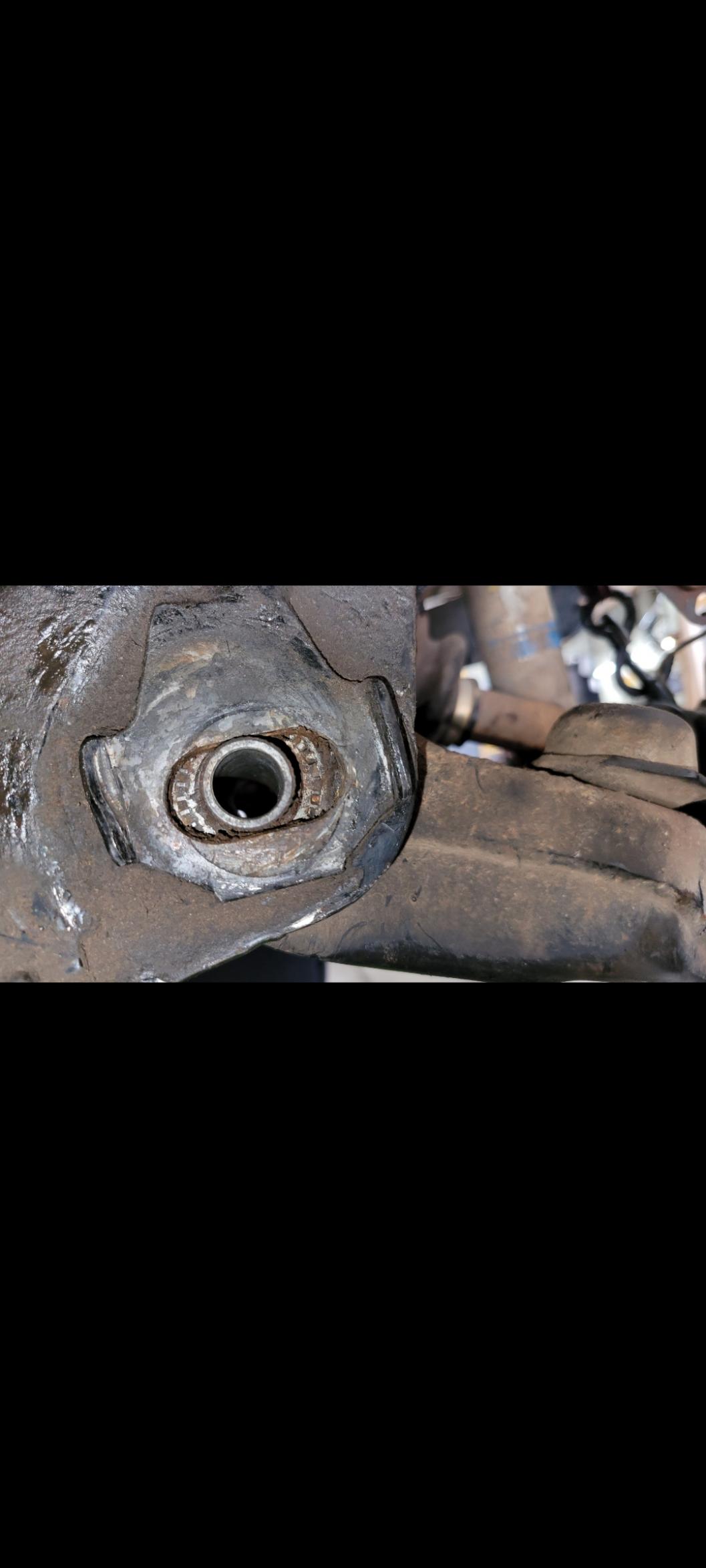

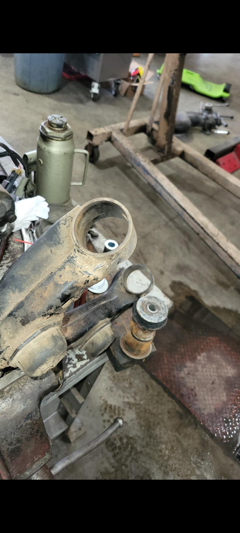

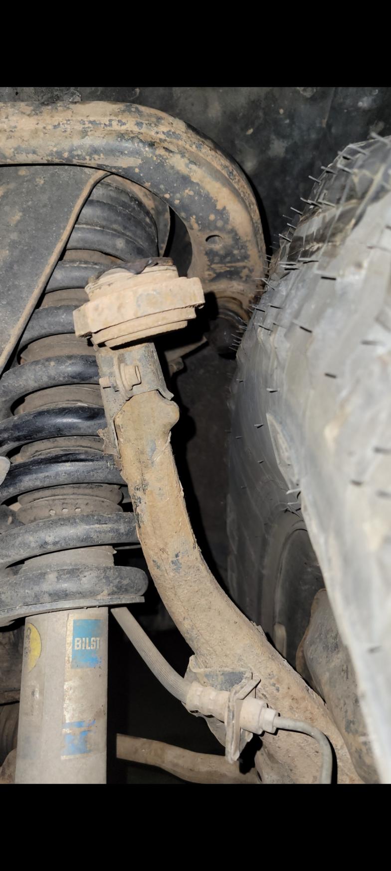

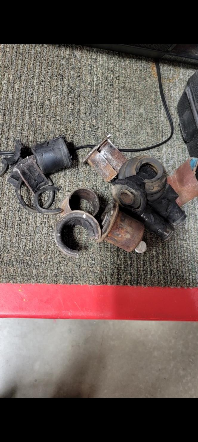

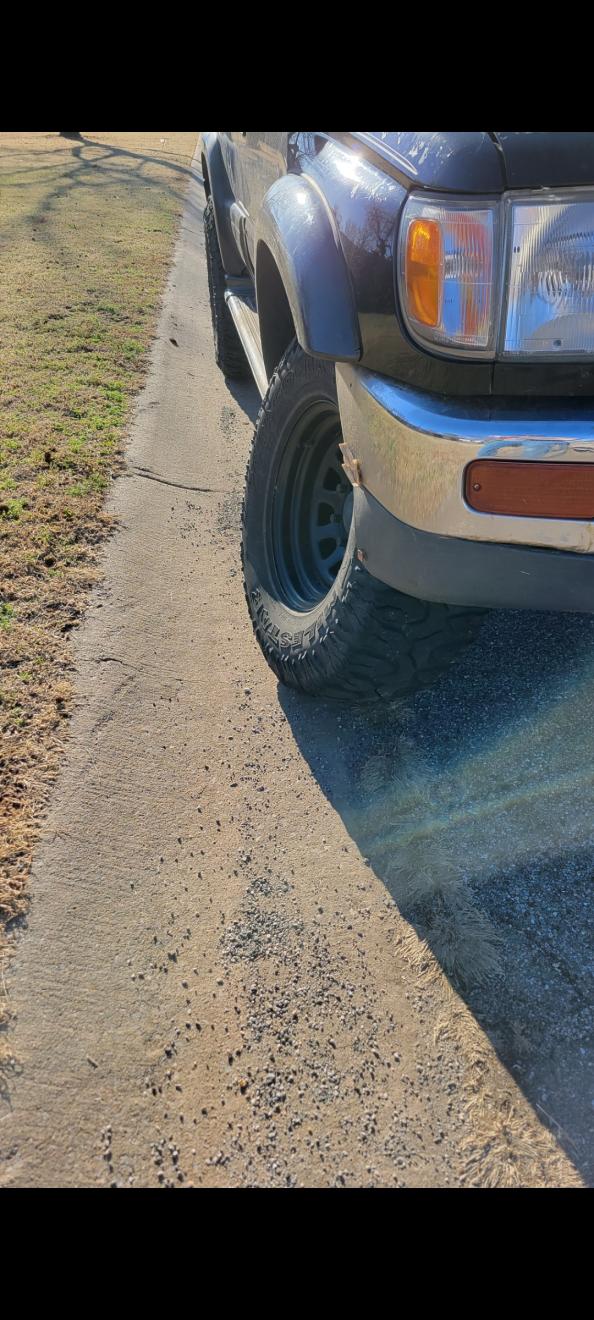

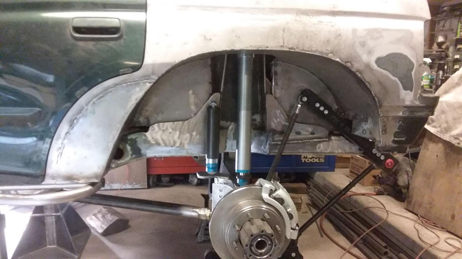

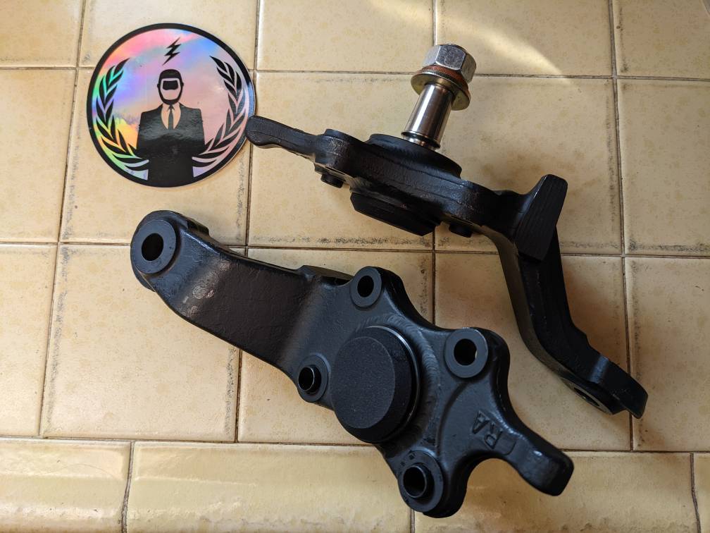

Last couple weeks have been fun! Passenger side upper ball joint said it was done, got it back on the road. Had access to a shop for a few days and had already ordered bushings for all the control arms so I decided to tackle those first, easy enough... Until one of the eccentric cam sleeves is seized to the inner bushing. Tried about everything, had to cut both ends off to get the LCA free. Bottle jack and some heat works great.... After you get it out lol. Oh yeah, the driver side upper ball joint *♂️. Thankfully had the part and must of the tools I needed so an hour later I was rolling straight. And last, but definitely not least, the UCA bushings fought very hard
