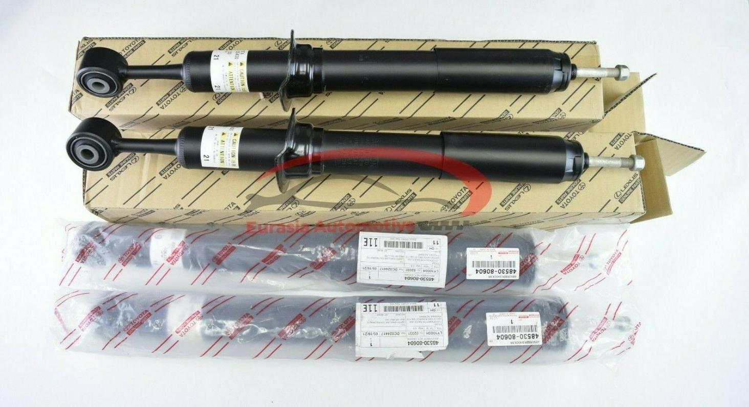

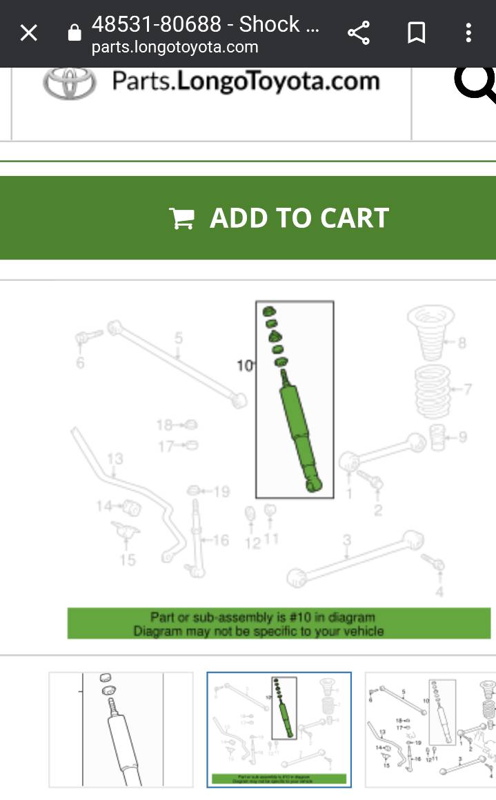

Cool tip!That's odd, the parts diagram shows the shock, cushions, retainer and nut as an assembly
Sent from my Pixel 4 XL using Tapatalk
That is odd... Mine did not come with them
Mine was packaged just like the bottom 2 in this pic

Installed 2020 4runner rear OEM shocks. For anyone that's lifted above 3" and wants a really soft factory ride buy these!! I believe they are the softest shock you can buy and be lifted a good bit. Shocks are 24" extended which is I believe is 4" longer than stock. I have them paired with the LC 7.5 wraps
Previously I was running the 80 series OEM Tokico rears. 2020 4runner shocks are about the same length as the 80 series rear and should be valved a bit softer.
Part # I purchased 48530-80604. Costed me $75 for the pair at the dealer. What a bargain!!!
Any idea what the compressed length is? Wondering if I can use these with a 2" lift, or if they would bottom out before hitting the bumpstops.
They were roughly about 15" compressed. If you have a 2" lift most likely your springs will fall out with these unless your sway bars prevent it

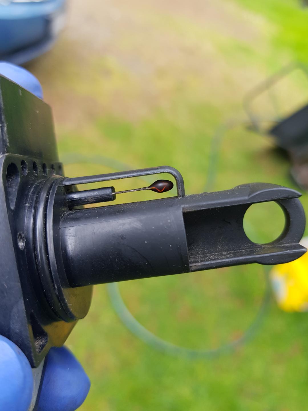

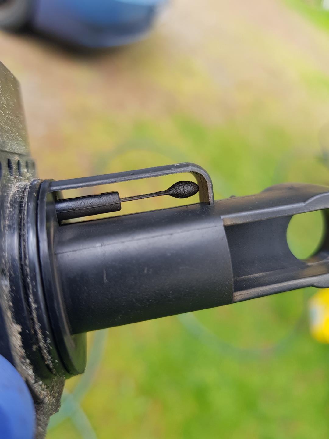

Cleaned the MAF sensor. Can't believe I didn't do it before. Seems to have cleared the P0171 code and low idle at start up. Totally filthy.

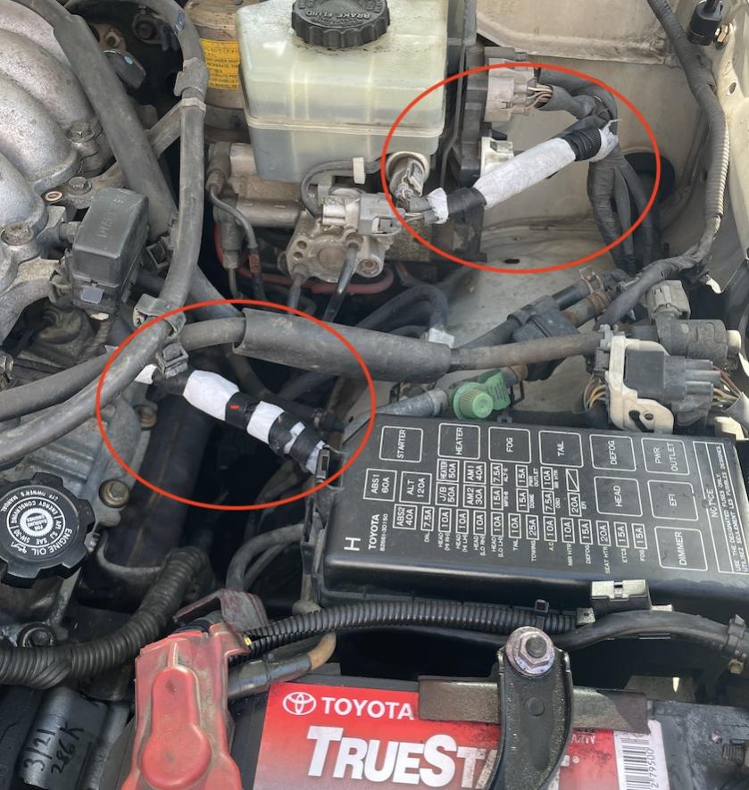

Added cheap rodent repellent (dryer sheets) to engine bay after replacing the ruptured injector fuel line that was gnawed through by a rodent of some sort.

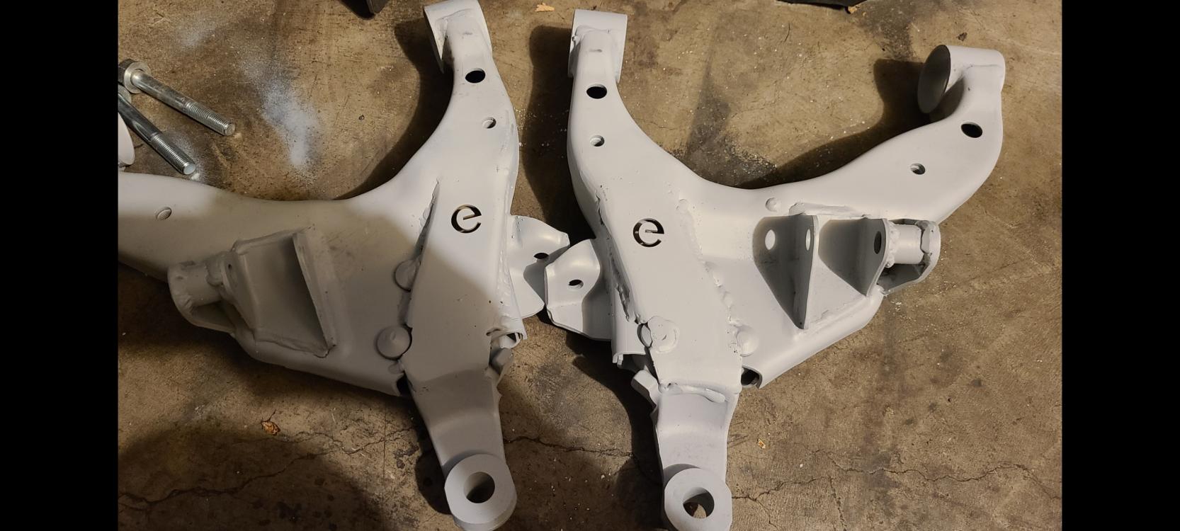

My coworker owed me a favor, and with him having 5+ years as a government contracted welder, I asked if he would put together my LCA reinforcements. Oh boy was that a mistake.
Nearly five hours later, I'm left with these. Pretty rough beads; half of them completely away from the joint, porosity all over, dude welded in the limiting strap bung making it totally useless, completely skipped a weld because the 1/16 gap was "too big to fill" - gave me the whole nine on this one. I would've been better off giving them to a gorilla with some jumper cables :mad2: :mad2:
Guess if you want shit done right you gotta do it yourself, but oh well, at least the legwork is done. Ironically the bottom sides either weren't too bad, or he was able to clean up perfectly, but they look flawless underneath. Just the top looks rough

Meh, good enough for government work right? :D
