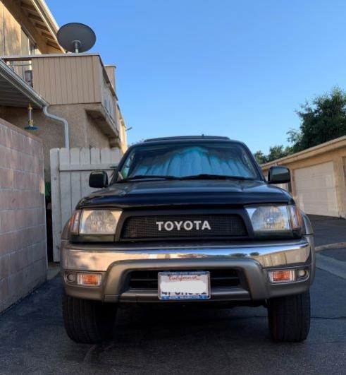

Satoshi grill
Just installed the Satoshi grill on Sunday. Definitely gives the Runner a different vibe! Worth It!

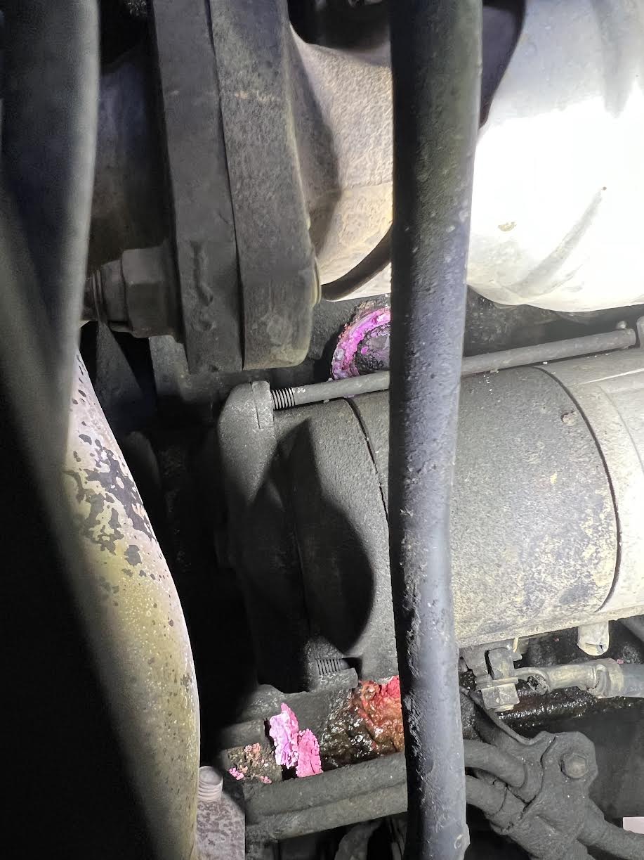

Regreased my brakes and pads to keep them from sticking. Anyone have any idea where this leak is coming from, maybe a freeze plug? It's up above the starter and I'm very slowly losing coolant

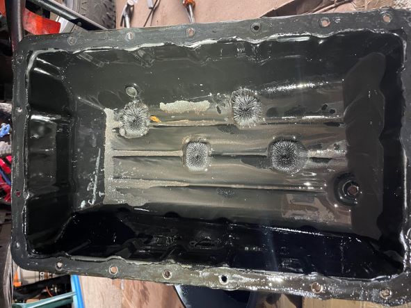

After having a code pop up for my trans ( this truck is new to me in last month ) I decided to start some much needed maintenance.
I'm not the most mechanically inclined but try anything once before i ship it off to get fixed... this is also going to be my daughters rig at some point ( shes 15 ) will see but she has awesome patients where i just scream and throw tools... which happened a lot last night!
We dropped the transmission pan to replace the filter and do another fluid drain and fill ( shit was black and silver... terrible )
I didn't realize what a PAIN it was to finagle the dip stick tube around and out... literally costs us at least 2 hours of awfulness... took off sway bar was still brutal.
here is a picture of the pans inside... its fuked but praying i wont need a new tranny asap... we will save for one but dont need that expense right now for a truck we drive every other weekend for adventures.
anyway we started out planning to do the trans filter, trans cooler, mag in line filter, grease everything, diff services front and rear plus the transfer case...
we spent 6 hours of hell on the trans pan and filter alone. with cleanup.

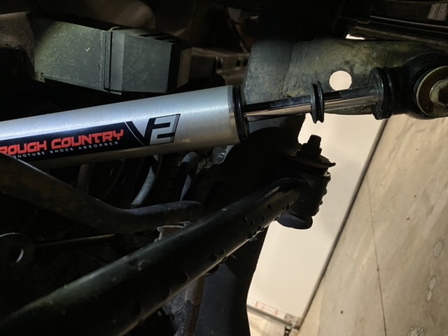

RC V2 Rear Monotube Shocks / Diff Vent
First of all, thanks to all of you who have posted over the years with how to's and helpful pictures. Because of the knowledge and help I got from this forum I decided to join my self and maybe help others in the future.
I swapped out my old Bilstein 5100's that have been on my 2000 4runner for who knows how long (bought car used) for some RC V2 Monotube's. This is one shock that I could find very little information about and zero info of others running it on the 3rd gen application. I also removed the stock rear diff breather that was completely compromised and did not vent at all. This is more than likely what caused the axle seal to leak on the previous owner. I did the 6ft long hose mod and vented into the fuel door location.
Installation was pretty standard. The shocks look great and seem to perform excellent so far. I can report back in the coming weeks with updates if anyone would like. I will attach pictures later tonight as I forgot to snag some last night during the install.
I have been running the RC loaded struts up front and the ride has been great.
If it's anything like a Toyota, if you give it some love now, you should be fine until you've saved enough to repair it or get a new tranny.
Did you replace the bolts on the pan when you dropped it? I've had a slow leak, we thought the new gasket failed, but the parts guy at the dealership mentioned the washers fail so you need to get new bolts. I only replaced the one in the trouble area for now so we'll see how it goes. Just a thought to make sure you don't have to do it three times like me.
On the other hand, after seeing those magnets, maybe you'll want to drop the pan again to see how they look!

Majic,
That is a lottttt of glitter in that pan. People freak out and post when they find a little 1-2 mm smudge of metal on the magnets. In your case, it looks like the magnet are dang near full of metal, leaving the rest of the shavings in the channels. With that said, it is a great opportunity to let your daughter learn with this truck and maybe even drive for a year or two. Teenagers are great at dinging up their parents cars. That's why they're given old cars.
