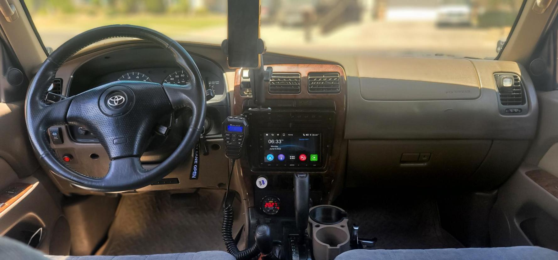

finally able to clean my 4runner and mount up my mic mount for my midland radio.

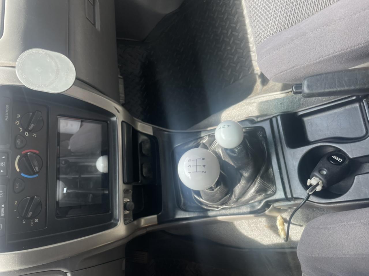

Finally found a ADD shifter from a Tacoma to get my multi-mode shifter at the correct angle. Tapped threads to the D slot shaft and screwed on a matching H-N-L shifter to match my cue ball 5-speed knob. Now all I gotta do is run the 4WD button wires to the dash and install a switch in one of the rocker blanks on the dash.
Also bought a ‘04 Tacoma ECU to fix my CEL light from my 5-speed swap. However, when I plugged it in the truck wouldn’t start. I think I have to wire the clutch switches into the NSS switch to get the factory auto trans engine harness and Taco ECU to work together. Only problem is I don’t have the pigtail end of the clutch switches, only the switch themselves. So I’ve gotta source the other ends to the switches so I can splice them.

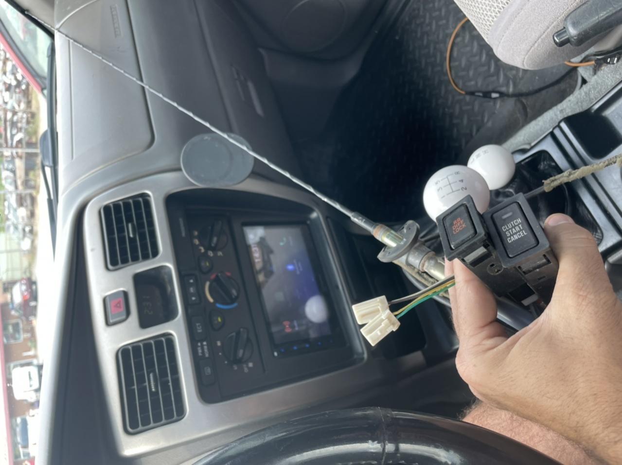

Today’s local salvage score;
RR Diff Lock Switch
Clutch Start Cancel Switch
Clutch Depress Switch Pigtail
Clutch Release Switch Pigtail
Tacoma Whip Antenna Assembly
4R is a multi-mode center diff lock w/ 5-speed swap. Plan on adding e-locker rear in the future so I went ahead and grabbed the switch.
Ordered a reverse switch pigtail from yotatech. Once it arrives I’ll be able to wire in my clutch start cancel, cruise and reverse lights to complete my 5-speed swap.
Quick question on the antenna. I know I need a different chrome nut to lock it to the fender, as it’s a different diameter than the power antenna, but will I also need the black grommet? Or are they the same?
And for the switches, does anyone make an OEM style switch that fits the blanks and somewhat matched the factory switches? I need to relocate the 4WD switch from the shifter to the dash since I changed it to a aftermarket shift knob.

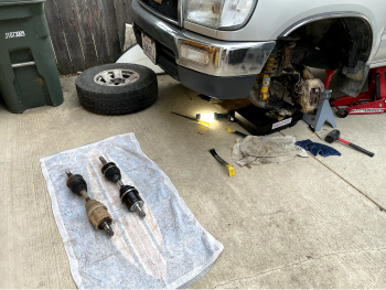

Replaced a CV axle for the first time—wasn't too bad except getting the dust cap off. Originally bought it to replace the right one which was starting to loose grease, but then the left tore and spew grease everywhere. So I guess I'm doing another one sometime soon.

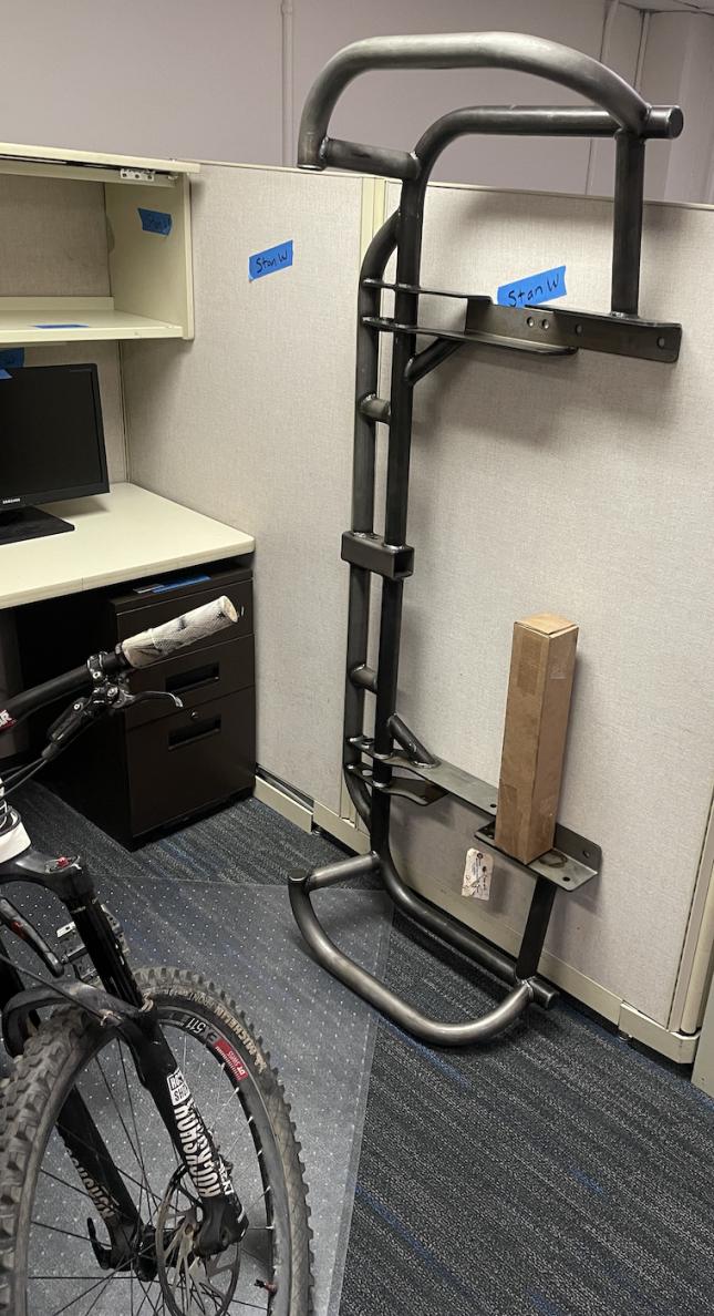

Driven mainly by impatience, I went ahead and ordered a TG tube rear bumper yesterday afternoon. This bumper does NOT check all the boxes I have in my mind, but will certainly make installing the 4-Cam engineering cabin vent system that's been sitting around a breeze and gain a bunch of departure angle in a hurry. I was putting off installing that vent because i'm pretty sure I'd need to pull half the factory bumper to do so. Also, the cost of a bare steel, no tire-carrier plate bumper is AT LEAST $600 more, shipped, and with those dreaded 'lead times'. I am currently 24+ weeks into a BF order for a front bumper from TNF!!
The reason I am bothering to post this is that this bumper arrived the NEXT F@$#*%G DAY. Today. Not only that, the order was placed with an out of state reseller (LC Engineering - a bit better price that Trail Gear) and it was drop shipped from TG. I was in no hurry to get it but along comes a text from UPS that the bumper was on a truck a few blocks away. That's all - just wanted to share the space-time anomaly. It lives in my coworker's vacant cubicle.
