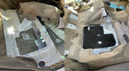

Cut out the rear right seat support.
I was originally thinking I'd put a slide out fridge there. Then I started thinking that if I was in a parking lot, it would be really difficult to pull out. And, the size was more restricted due to the angle and transmission tunnel than I was thinking, so it would have only been a 20L fridge. Instead, I've purchased a drawer fridge which will fit in the rear under the sleeping platform.
Now I'm thinking that I'll just use that area for water storage since it is fairly low. We occasionally do long trips ~2 weeks off grid, so we carry 28 gallons of water for 2 people. Boy does she sag fully loaded! Someday I'll get to upgrading the suspension...
