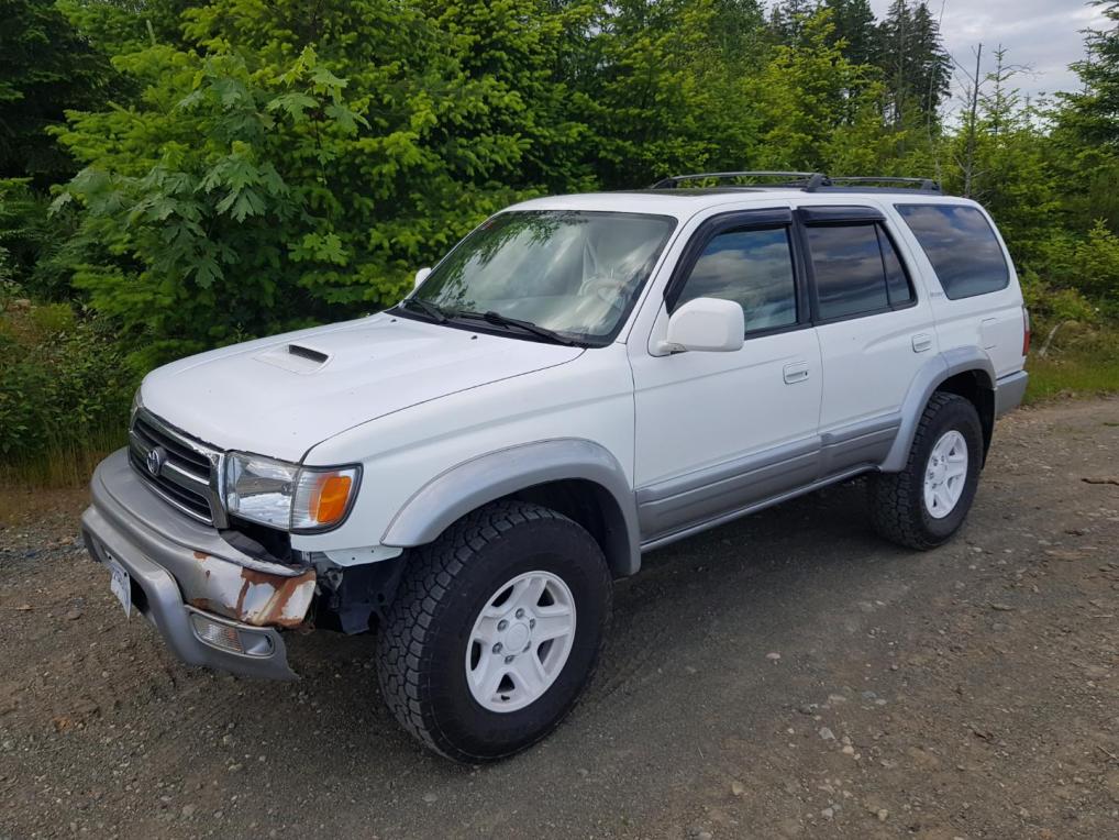

Finally replaced the fender with a white one. I actually had 2 beige ones, one with the limited flare and one SR5 that was on the car. I couldn't get around to painting the limited one until the weather warmed up and.... it's done. Not perfect, but not embarrassing anymore. Next is to weld up the coastal offroad bumper and this thing will really look nice. The white wheels look great.
