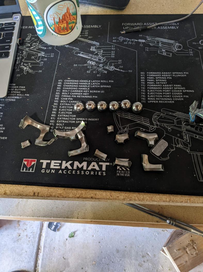

Installed new reinforced LCAs, new uniball LBJs and new ITREs. With another person it took a total of 9.5 hours. The cam adjuster sleeves were an absolute nightmare and took a solid 60% of the time by themselves - and I'm deathly curious what the f*ck they're made of; when trying to come up from beneath it the sleeve absolutely smoked every cutting disk and sawzall blade I had like it was Stellite, but cutting the sleeve dead-on felt like it was pot metal. :wtf:
I ended up cutting off the sockets of the LCA (just to get it out the way) then cutting a crosshair shape at the end of the adjuster sleeve to break off chunks and get rid of that little bit poking out the frame, so it could be knocked cock-eyed and pulled out. Even in doing this it still took two men a couple hours with two prybars, some weird drill bits and a lot of swearing. We both suspect that having an end-mill would make extremely short work of it since you'd be able to shave down that nub past the frame in a minute, tops.
Oddly enough what looked to be the most rusted one wasn't frozen one bit and simply pushed out... weird but I'll take it. At this point the only part on the vehicle that hasn't been serviced in some way, shape or form are the wheel bearings, which are starting to howl around 20mph... but it's such a ***** of a job that I'm willing to ignore it for the time being. :cowboy:

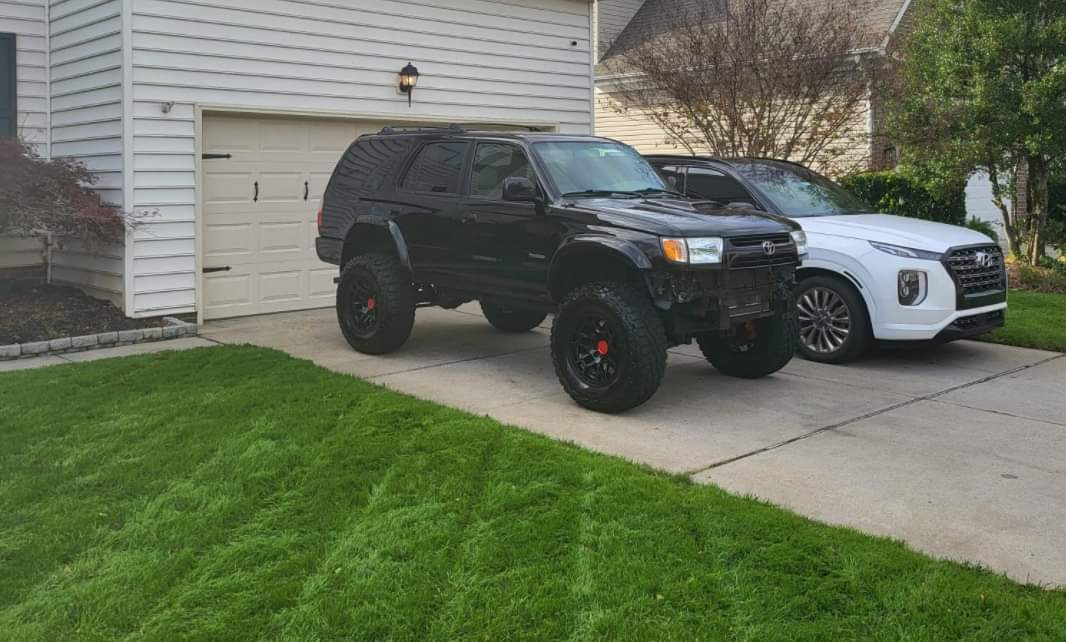

This is how I left her in November. Alot of parts ordered while i have been gone so its gonna be fun when I return in Sept.
