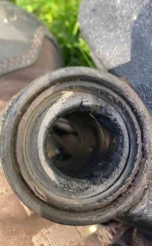

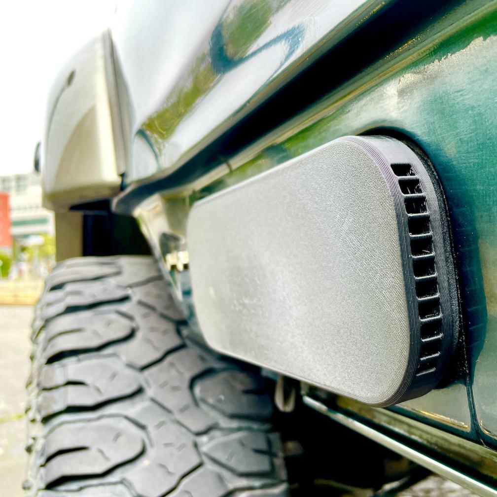

Finally got around to installing the 4CE cabin pressure/filter port out back. Inside (3rd pic) is another nasty dust-infested filter material that I really should have tried to vacuum out or something but didn't have a way to do that so i beat it for a while and wiped the area clean.

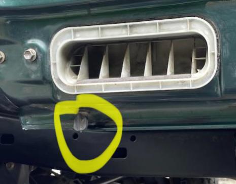

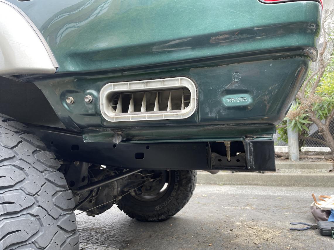

Looks interesting. Where does your sunroof drain empty to now?
Good question. If that's what the clear tube did maybe I can can extend it and route it out the mystery plug hole in yellow below. I have my sunroof silicone'd shut currently, so hopefully it doesn't drink much. The clear tube was clipped to the OEM insert in the earlier pic and didn't appear to be going anywhere. Did I disconnect it from something? I'm not putting the stock bumper back on so I can access the internals easily.

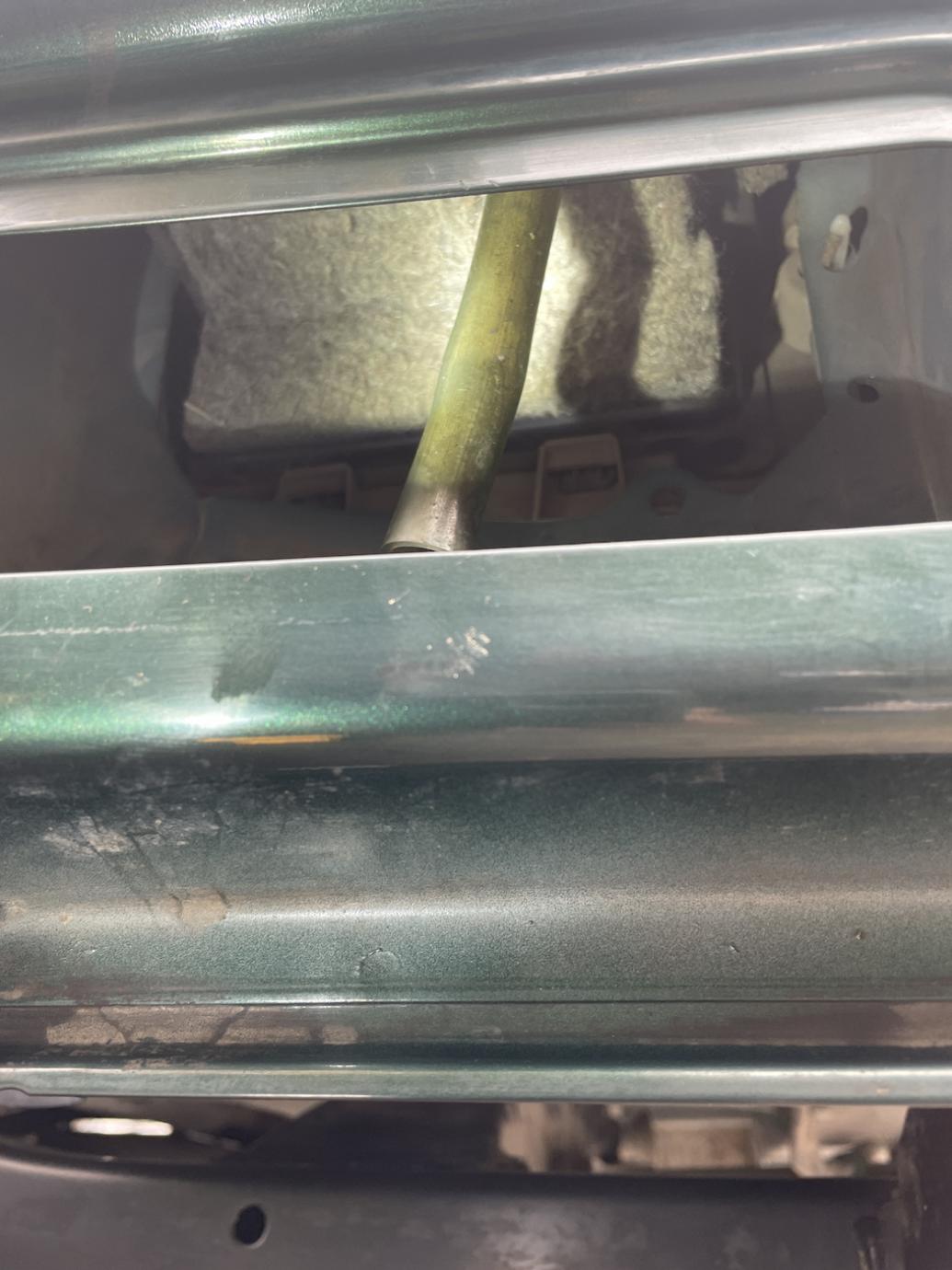

Yep, that's one of the sunroof drains. It runs from the left rear corner of the sunroof to the vent it was clipped into. Just don't pull on it too much, it's got a wimpy spring clamp holding it to the sunroof.
The drain on the right side pokes through a hole in the body, above the tailpipe and under the rear cargo storage. Much like what you're thinking with Mr. Mystery plug.

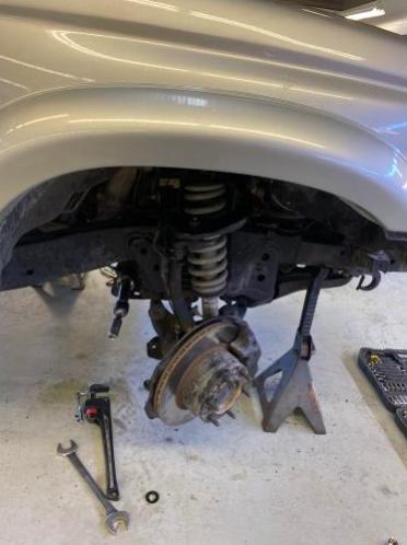

Replaced my ITREs+OTREs, also decided to do my passenger side UCA. ITREs were in decent shape but the rest was shot! Decided to grab my tools and do it myself and save some cash! Not as bad of a job as I thought; replaced with new OEM parts

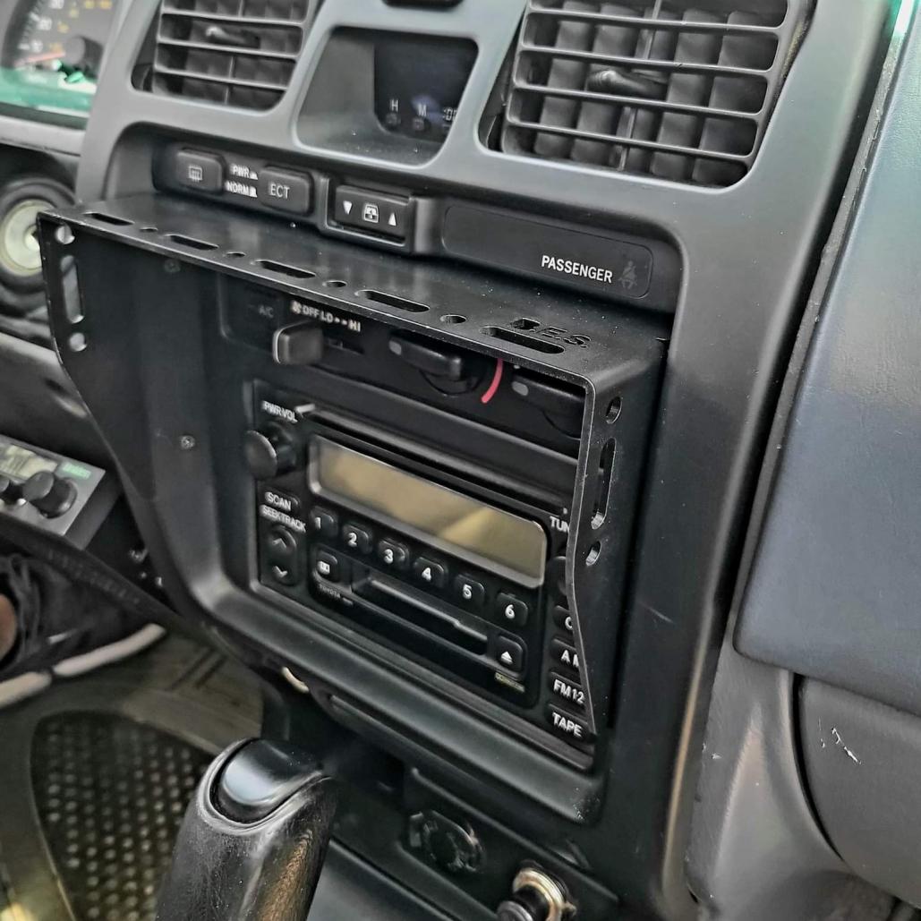

Nothing too exciting over this way. A little tiny 20 watt gmrs radio went in, coax and antenna pending, along with reinstall of interior trim,

I ended up with an Anytone AT-779u/v gmrs. We have the license and it mostly fits the bill for what we do. Still want to take the ham test, it's offered pretty often around here. Mostly for the because can. May have to get one of those inreach dealies to (hopefully never) use for medical emergencies, we're gettin' kinda old.
Heh, today me and the kid used our old Uniden frs/gmrs handhelds to communicate between the basement and the garage. Needed to figure out which poorly marked circuit breaker the garage door opener of stuckedness uses and didn't want to run up and down stairs a bunch. Worked pretty good.

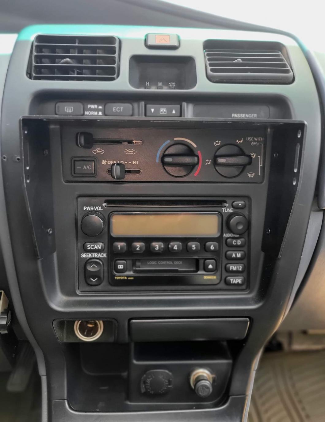

Oh yeah, that's another thing I got done on my '99. Pulled out the mini-CB that rarely worked well, and even when working was full of static, buzzes, hisses, short range, etc. And installed an Anytone 779UV mini GMRS. About as easy of an install as possible. It was a tiny bit wider than the mini CB, so I had to dremel on the dash bezel for a bit (it's where the ashtray was) and in it went. And I used the same antenna cable as the CB used, going to a bracket on the rear of the truck, just to the side of the hatch. I had to drill out the mount a modest amount, and installed a GMRS antenna.
Tested it out with a handheld FRS radio and even with the motor running, and the A/C fan running (things that would cause noise on the CB) it was crystal clear. Range should be dramatically better as well, the 779UV puts out 20 watts on some channels. I'm not sure what the CB transmit wattage was, 4?
The 779UV can be used in 'easy' mode (1-30 GMRS channels), but you can also get into programming it via a PC app and do more sophisticated things with it. For example, programming in other channels outside the GMRS frequencies. I guess legally speaking you shouldn't ever transmit on them, but for example the GMRS setup also brings in the weather radio channels as receive only channels.
It was a bit confusing when I first powered it up, it seemed to be setup as a dual band Ham radio. Cycling through VHF and UHF frequencies, but not the GMRS range. Habanero looked up online and found you need to do a hardware 'secret button' trick to access a setup menu that allows you to set it to GMRS configuration. I kind of thought that the hardware was licensed (as well as the user) for ham or GMRS usage, but... I guess with a secret setup you can sell a radio that does both?
