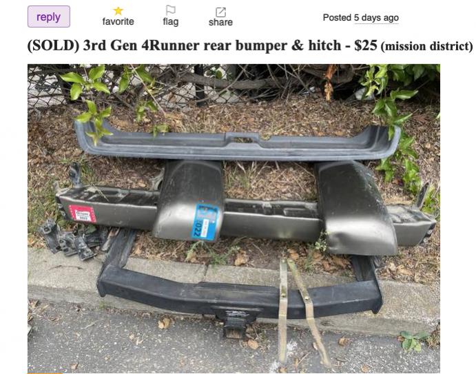

I don't have much T4R-related but I sold a bumper and hitch today to a cat that really needed it!

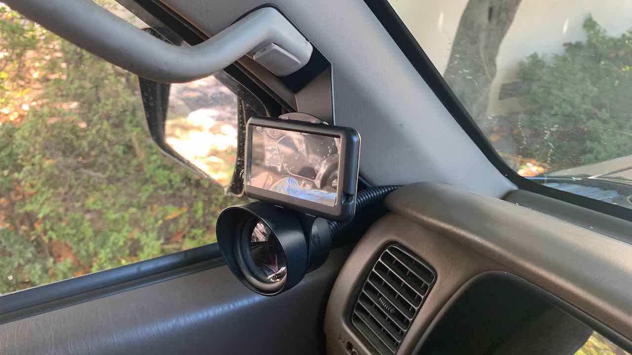

Added a transmission temp gauge and Spiker Engineering gauge mount.
One more thing for me to obsess about.
Went for a drive to test out the gauge and was seeing about 175 around town and 135 freeway, OD on. Coolant temp 194. Outside temp 98+. After returning I added about 1/3 quart ATF. Lost more than I thought during install and repositioning my Magnefine filter. Was about to order a B&M 70264 but started looking at other options and now I'm at the edge of another rabbit hole.
One of these days I'll take off those protective covers and push that bolt cover all the way in.

Looks good. I myself changed out my 70264 I had been running since 2010 for a 70266 last year. Much more rapid cooling. A tighter fit but it will work with some ingenuity.

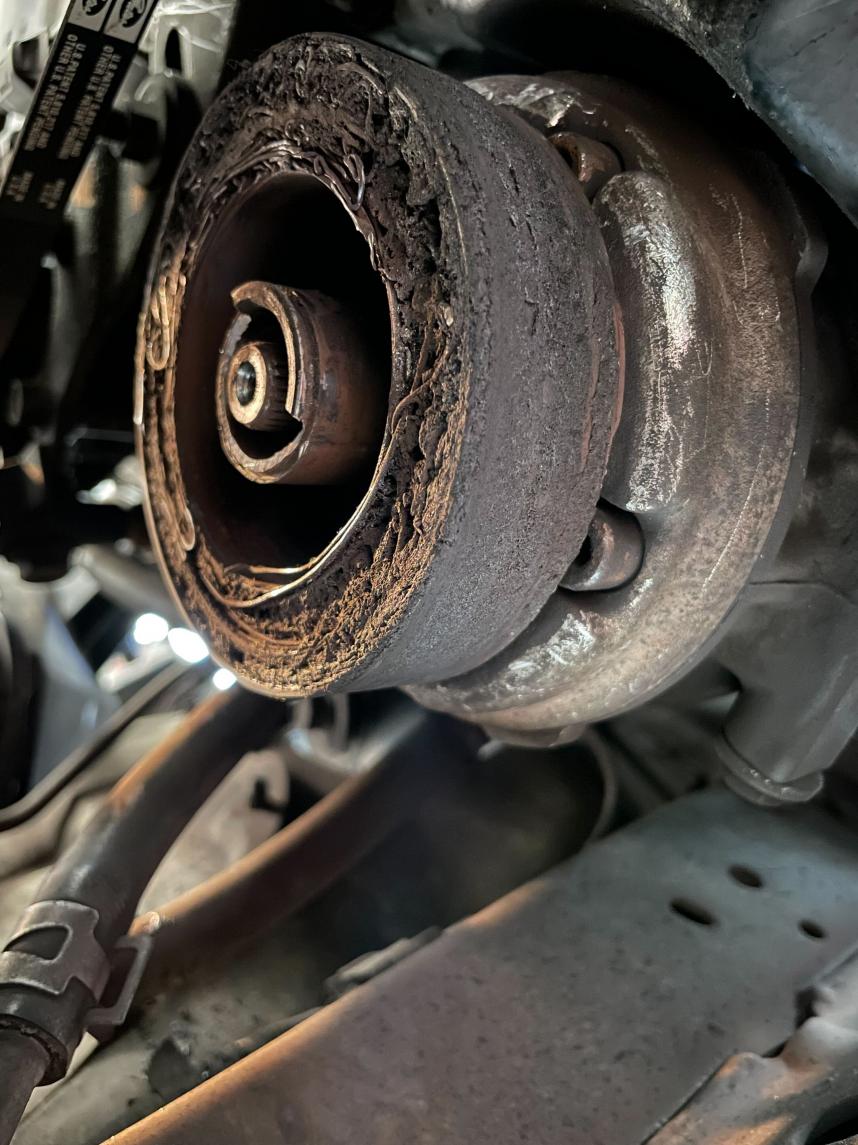

What was supposed to be an A/C compressor clutch replacement became an A/C compressor replacement when I found the collar sheared. This one's probably going to a shop to finish, sadly.

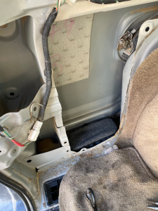

Zip tied a sock rag over the cabin pressure vent. Stuffed a couple extra sock rags into the vent. Hopefully much less dust in the cabin when we head down to Baja in a few weeks.

sorry your having an issue with it.....up here I have not used my AC for 3 years....even pulled the fuse so it wont kick on in defrost mode
but I do miss the hot days.....some times
was thinking of cutting the belt off ...should have not put it back on when I did my timing belt a week+ago
