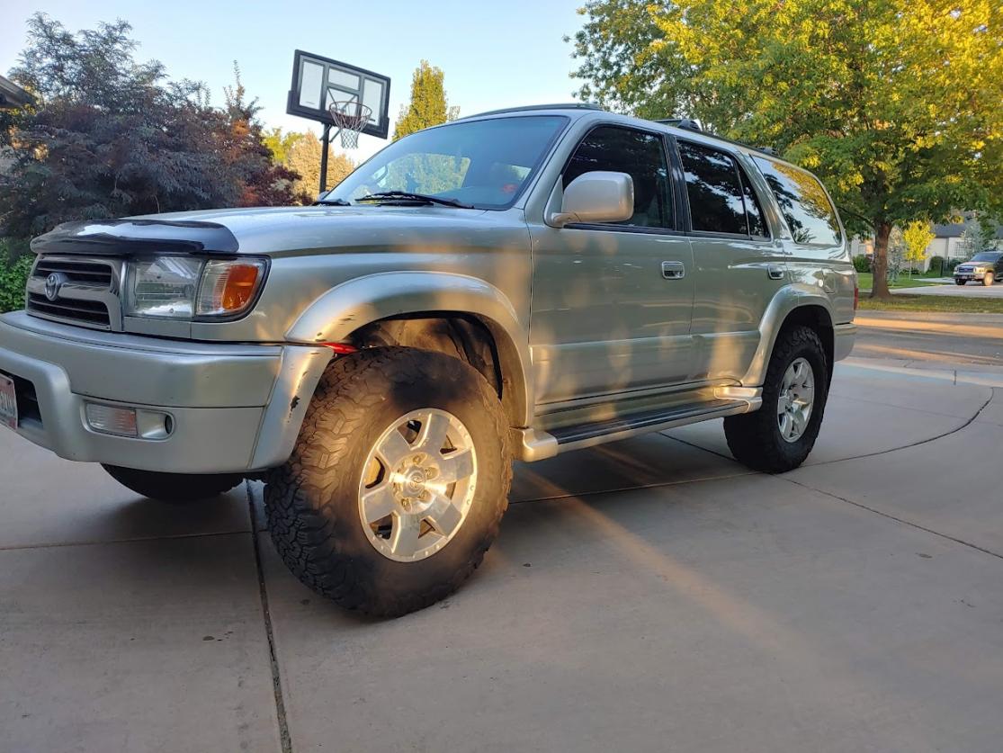

Here’s a pic of the rig:

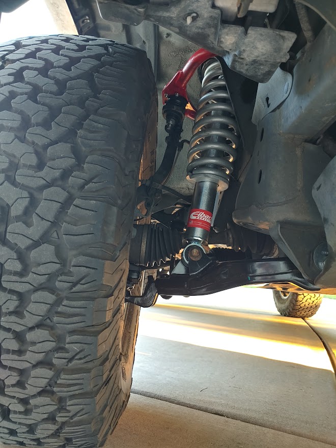

It was time at 225,000 for suspension attention. Tires were done so it made sense to go all in with upgrades while replacing.
New upper and lower CArms, Ball joints and Eibach Pro Truck level one suspension. Take-off wheels from a FJCruiser moved me up to 17", and take-off KO2's with 5k miles on them (all 5 of each).
Also got her professionally detailed so I know it got good product and mechanical polishing that I cant do. Had her since new. Limited 2000.
