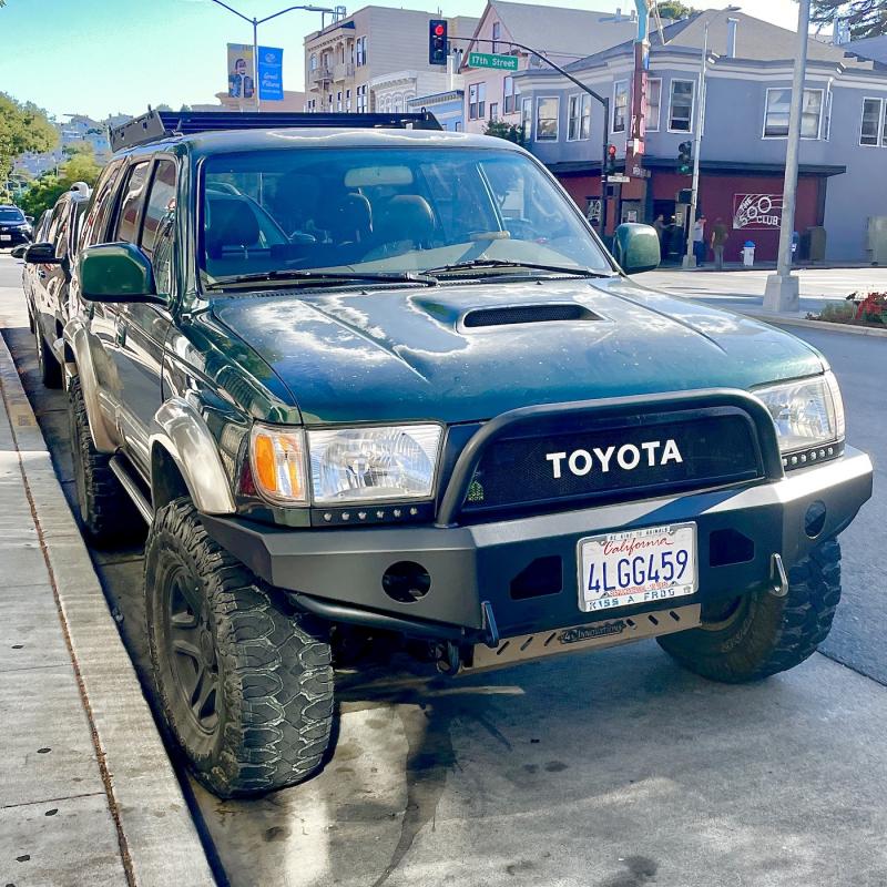

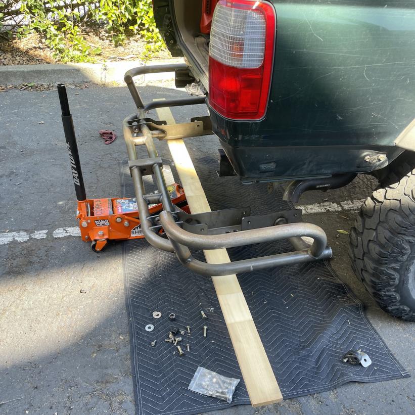

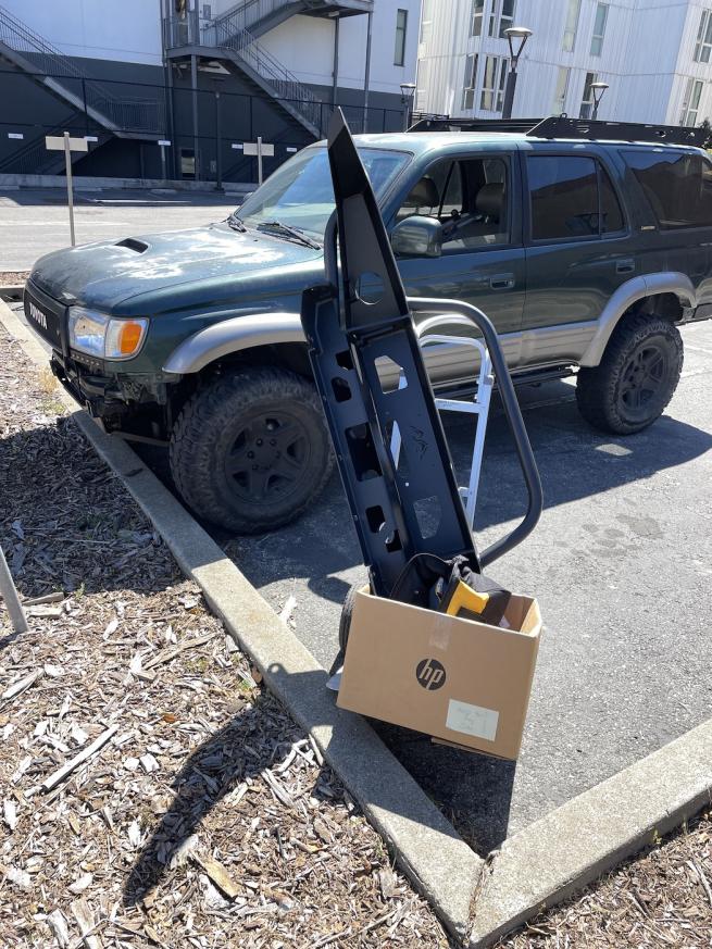

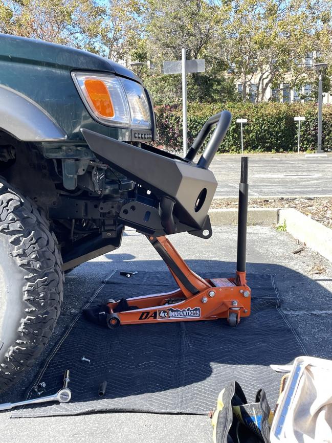

The instructions went to great lengths to drive home the advice:
DO NOT ATTEMPT THIS ALONE!

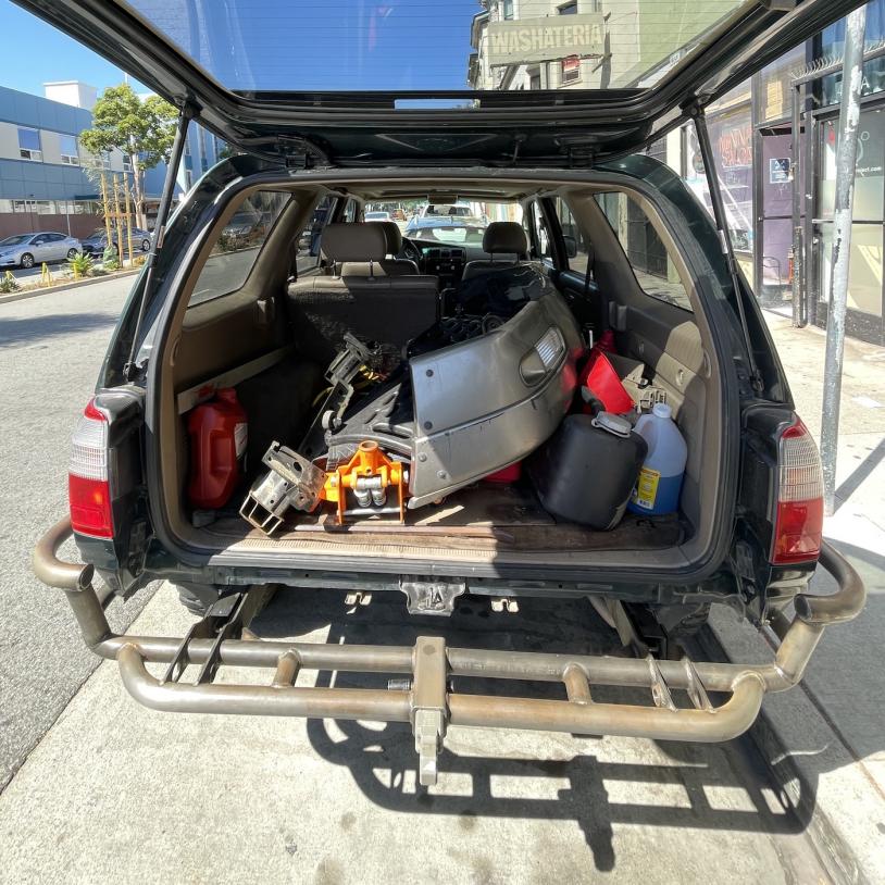

Solo-geezer front/rear bumper install....
Put the rusty tuber back on the rear solo as well. If I decide to keep it it will get paint but i had nice results with some steel wool and WD-40 Silicone anti-rust spray for now (not shown).

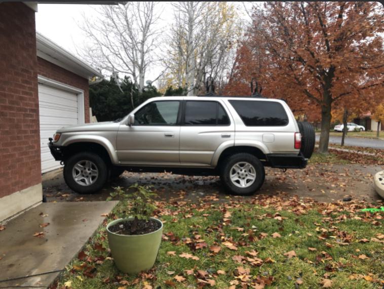

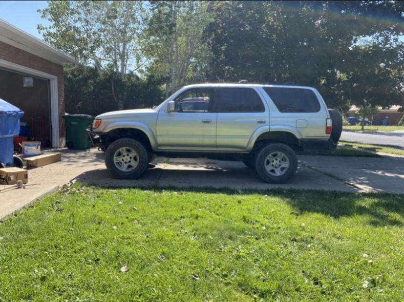

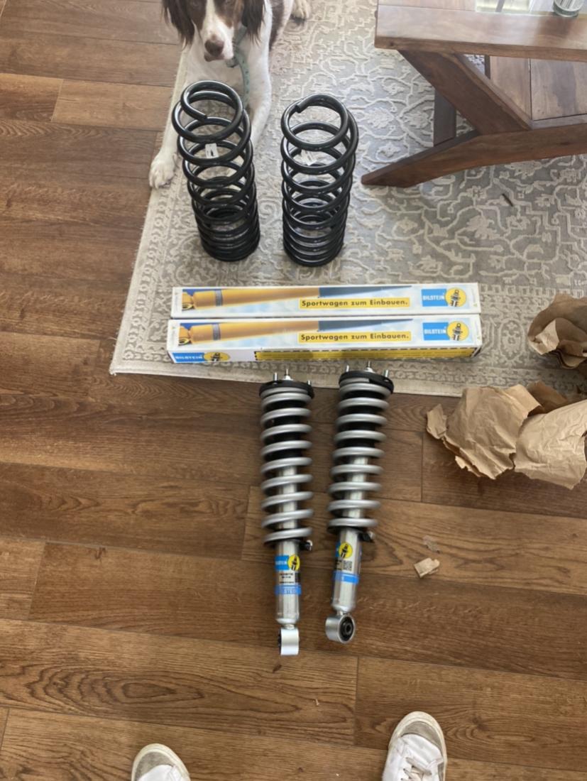

Got my lift from Wheelers today.
Bilstein 5100s w/Eibach Coils for the front and long travel 5100s and OME 891s in the rear.
Before lifting on tired, saggy coils & shocks
Now after! Loving the ride, worried that the 891s were going to be too stiff but they ride like a cloud. Love the Eibachs in the front! This is with a 1” BL and stock wheels and tires.
