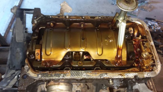

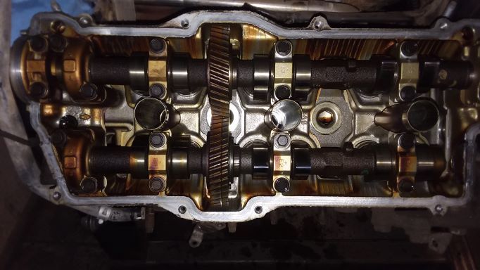

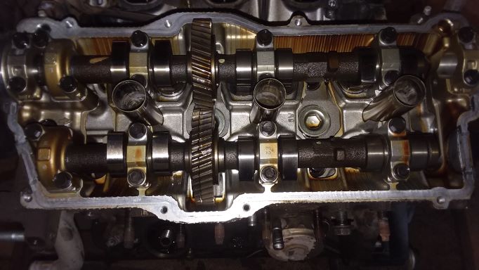

I also needed to pull the transmission for a warranty refresh.
On our out west there was some transfer of oil from the taco box to the transfer case so therefore the new seal. It wasn't much, but I had the units out of the truck so...

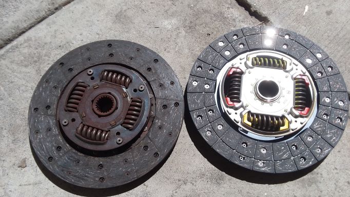

Resealed the replacement engine top to bottom and cleaned the heads and block of 20+ yrs of the crud build-up, put in a new clutch (not sure I'm a fan of the plastic and smaller spring size of the Aisin (OEM) replacement disc. Now i need to find a new home for this 97 manual.
