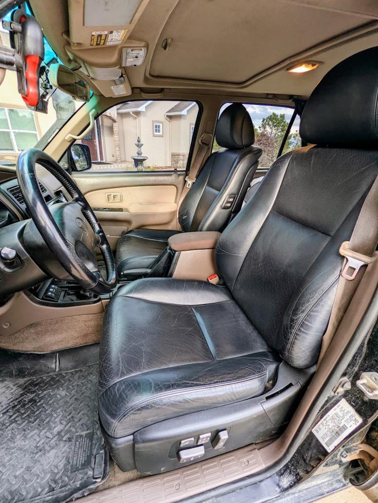

OEM seats are out and ready for Lexus LS460 seats. Wiring is functional, but I will need to remove the under the passenger seat heater for the rear, and the "humps" under the front of the front seat brackets, so a bit of cutting and welding coming up. These seats are also much deeper than the originals, making me feel horrible for whoever has to sit in the back (likely never happening), but I am mounting them so that I can sit further back than the OEM seats ever allowed.
