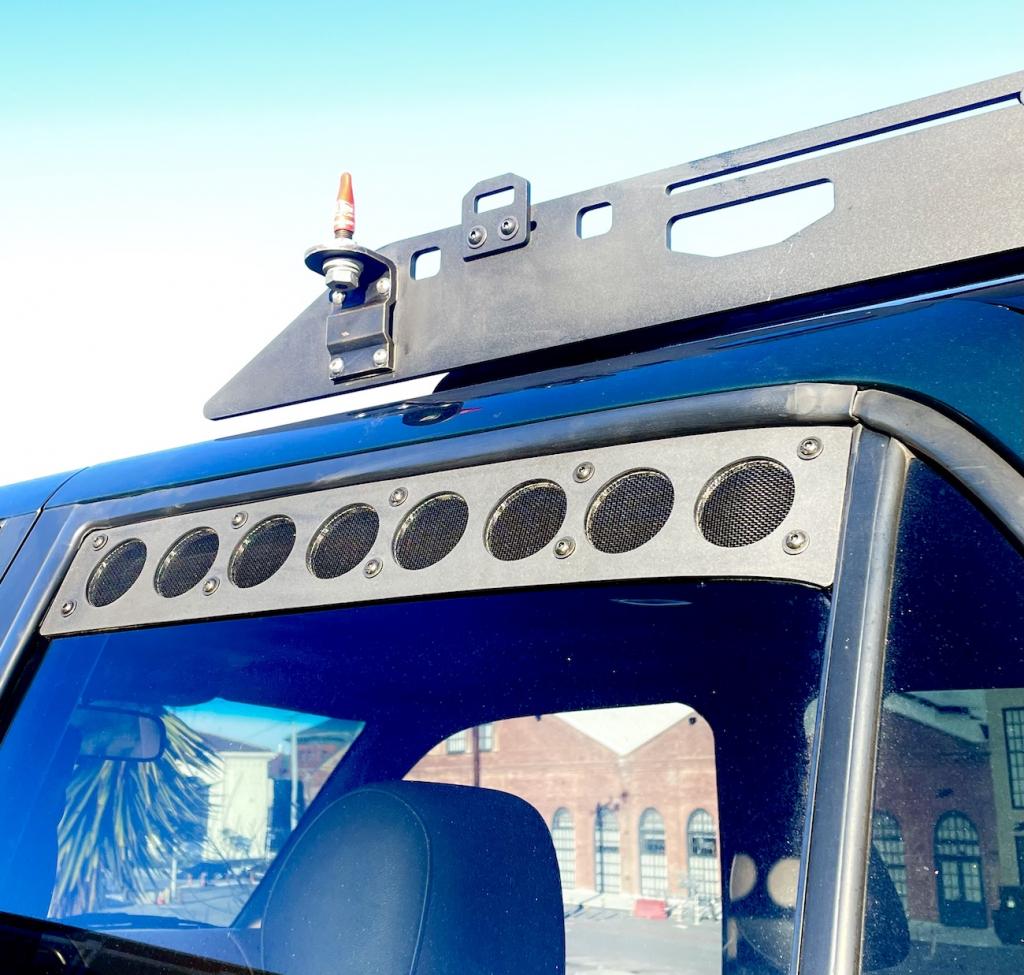

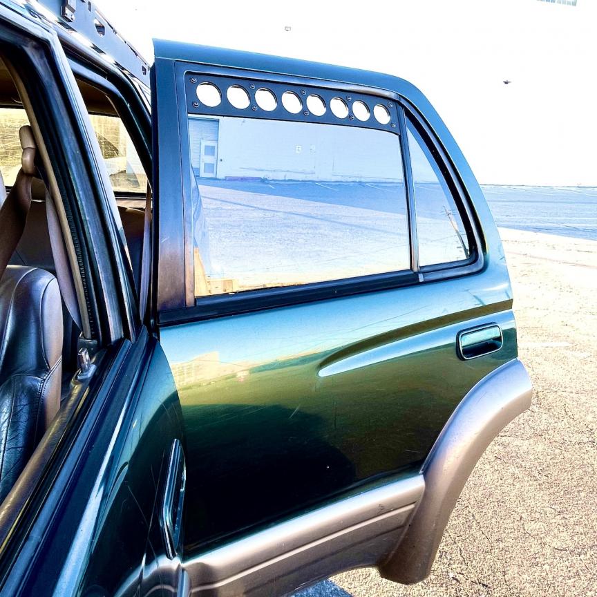

Completed a 3-step mod today. It went like this:
1. Roll down window.
2. Insert vent.
3 Roll up window.
I'll tackle the other side tomorrow......

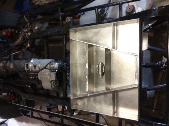

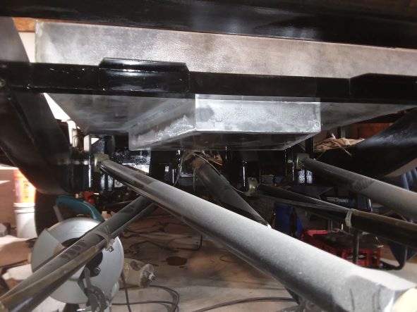

If u look back at previous pics u should be able to c its SASed already, Tundra 10.5" diff in the front and rear, ford dana 60 outers front and rear, Ruffstuff housings front and rear, Converted the front ford brakes to the Dodge 14" rotors and calipers while changing the mounting to the outside of the hubs so one doesn't have to pull the entire hub assembly to replace the rotors. Plus the increased braking.
Intended to just run 35" most of the time but built in the ability to go larger if wanted without having to redo the entire set up. Can clear 37 with no issue but with 40s id have to start limiting travel, but intended to keep it at 35s, don't plan to run 40s, for better road manners. While its focus is the ability to rock crawl vs go fast because of the geography around here it can still drive cross country and drive hwy speeds.
