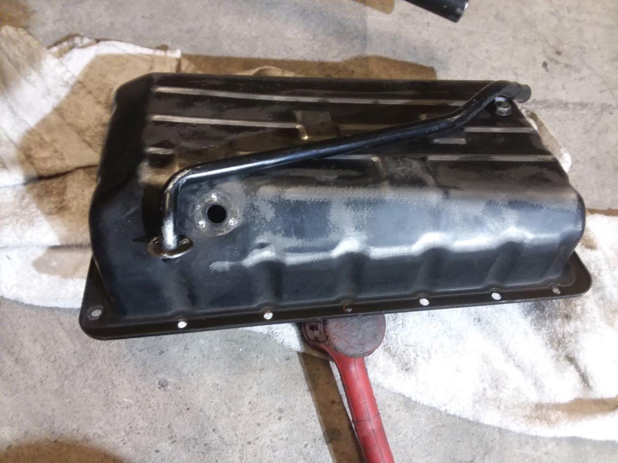

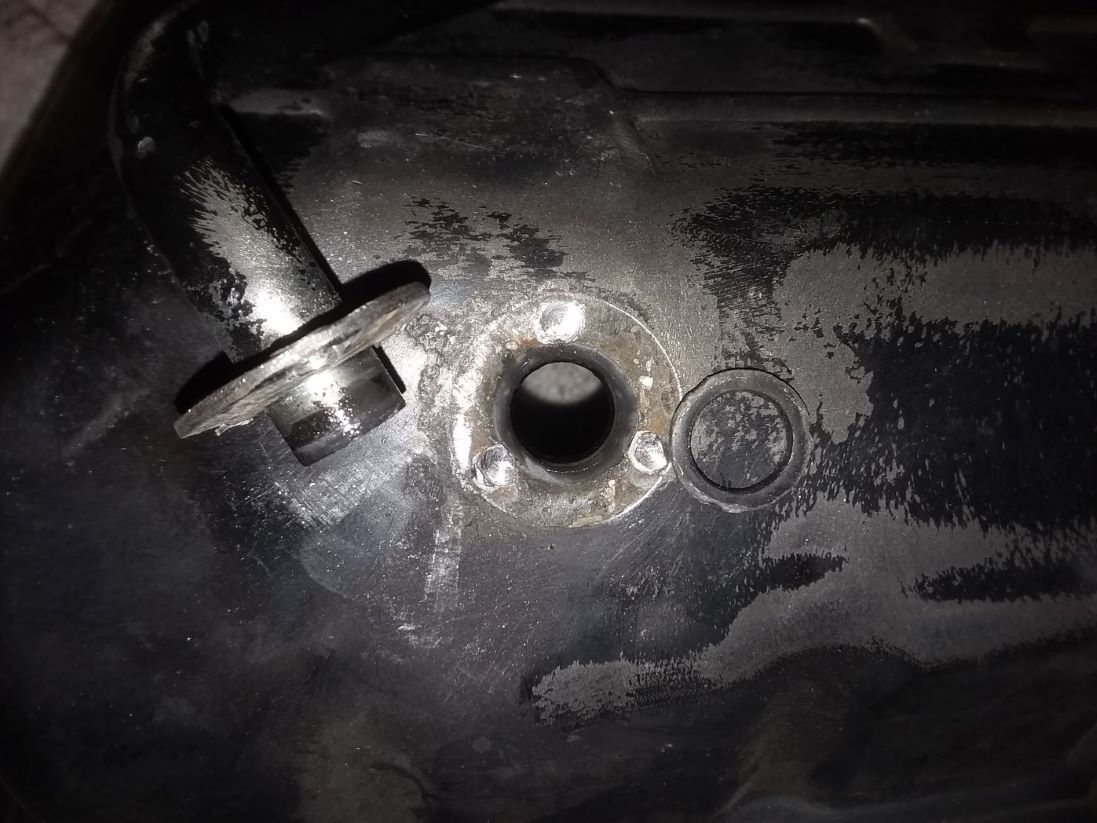

attempting to rework the 5vz a340 pan to work on the 2jz a340 to get the larger pan size, this requires moving the dip stick location to the pass side of the pan. Figured I'd share something I found out during said move that I was unaware of, there is an o-ring between the pan and tube, under the 3 spot welds that hold the 2 as one.
