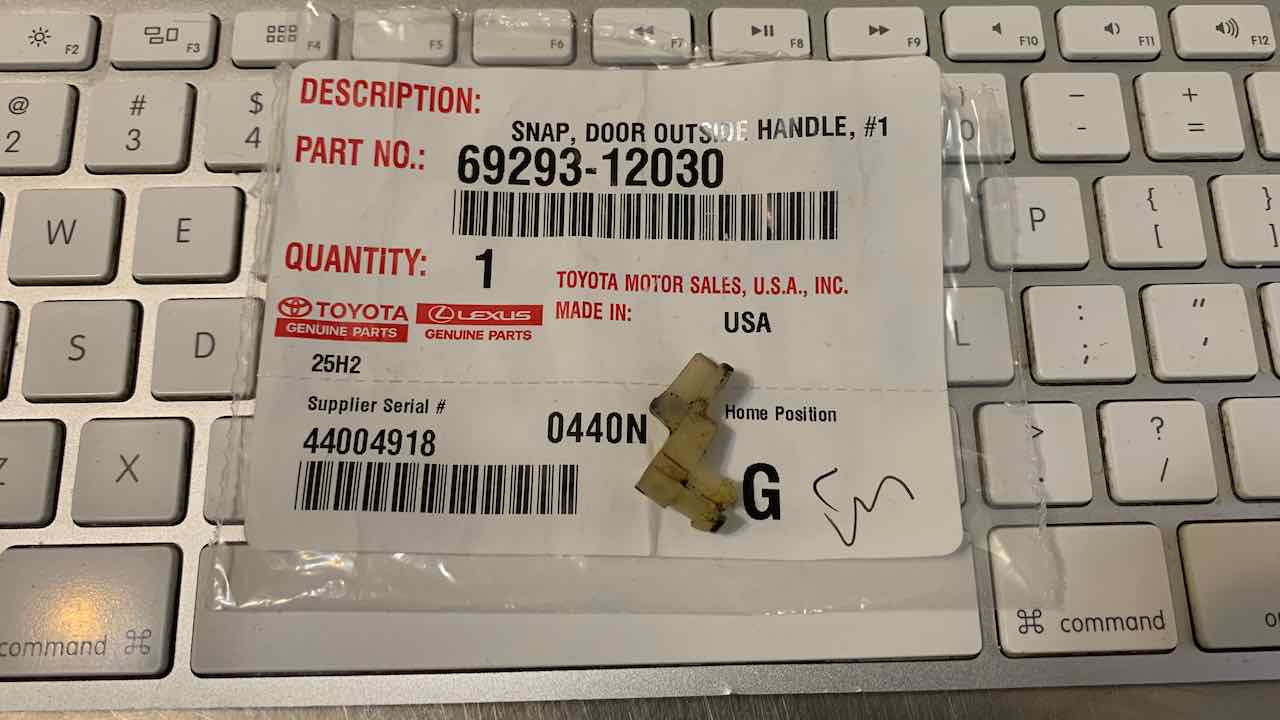

Fixed a busted clip in front-passenger door handle (wouldn't open from outside).
The first time this happened on the driver side I didn't have a manual or this site and spent an afternoon replacing the entire handle. This time took me 10 minutes. Knowledge is power.

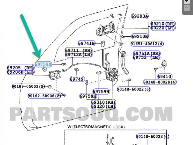

Is that the clip that holds the rod between the door handle and the latch? Went to open my door one day and heard a snap and my interior door latch stopped working, but I’m assuming it’s the same idea for the outside. Looks like there’s a little clip that’s broken that I’m guessing held the rod back in place so wasn’t sure if this was the part.
Is that the clip that holds the rod between the door handle and the latch? Went to open my door one day and heard a snap and my interior door latch stopped working, but I’m assuming it’s the same idea for the outside....
Yep, just a clip that attaches the latch rod to the external handle. I've only had issues with the external handles but yes, same idea.
I believe the clip you're looking for is either 69759-20060 or 69759-20070 (left/right but I"m not sure which is which). I can get these online from my local dealer for under $3/each. In-person they're $7.
