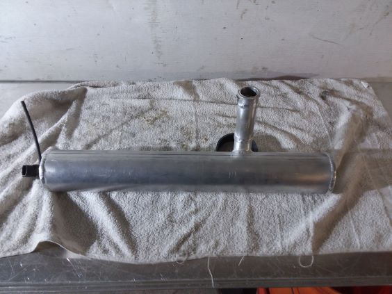

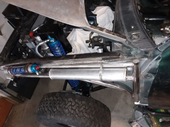

Got the rad over flow and washer fluid tanks worked out.
