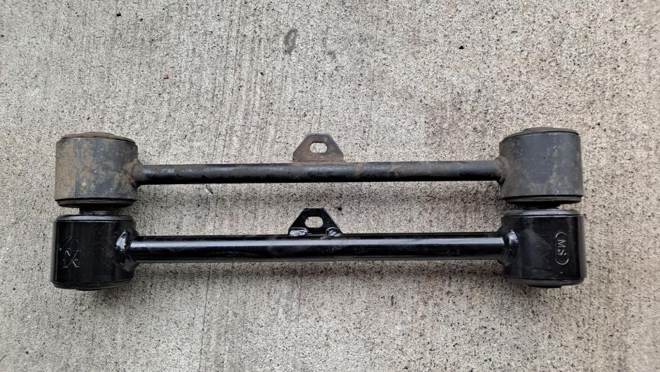

Picture below comparing a stock link to the Mevotech Supreme model. We'll see how they hold up. They look great and felt like quality.

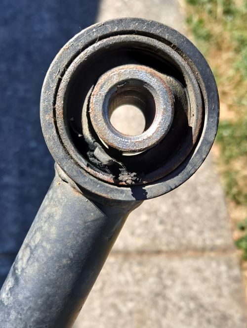

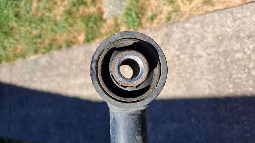

Here's what the bushings in my lower links looked like last June:

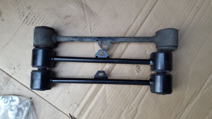

Did you compare the mounting point distance between the OEM upper control arms and the Mevotech? The Mevotech upper control arms show they "fit" 2wd and 4wd 4Runners, but 2wd upper control arms are shorter than 4wd upper control arms in order to change the pinion angle for the different driveshaft designs.
They bolted right in without any difficulty. They list the basic dimensions on the RockAuto website. You can use the Parts Catalog on Mevotech's website to confirm the fit: CMS861168 - Control Arm - Mevotech
They do say that they fit both 4WD/RWD vehicles... They are not the shorter 2WD models, that is for sure. I received a pair of those once years ago.
EDIT 03/31/2023: This picture below is a reference to me receiving the WRONG parts years ago. These are NOT the Mevotech Supreme arms I received yesterday.
the ones on the left look shorter to me, i assume thats what you got years ago that were wrong ?
