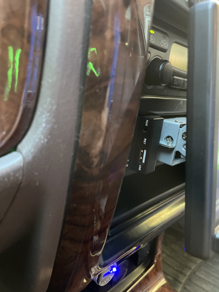

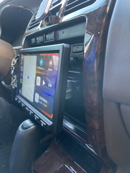

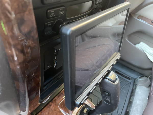

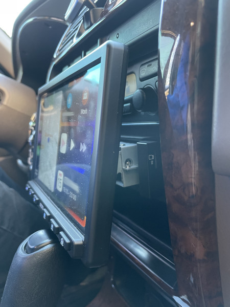

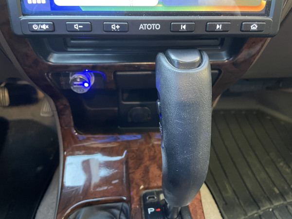

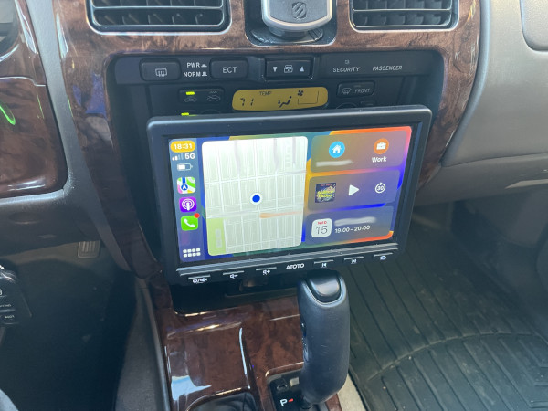

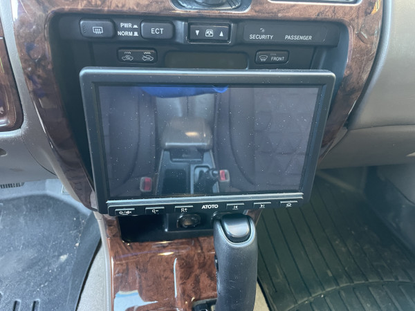

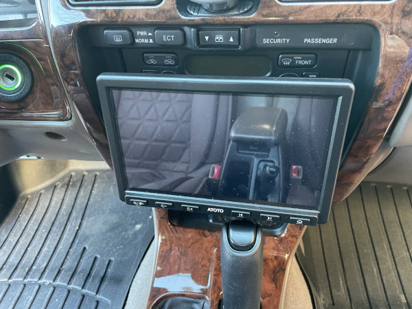

Installed a new Stereo head unit w/ wireless Carplay/Android!!

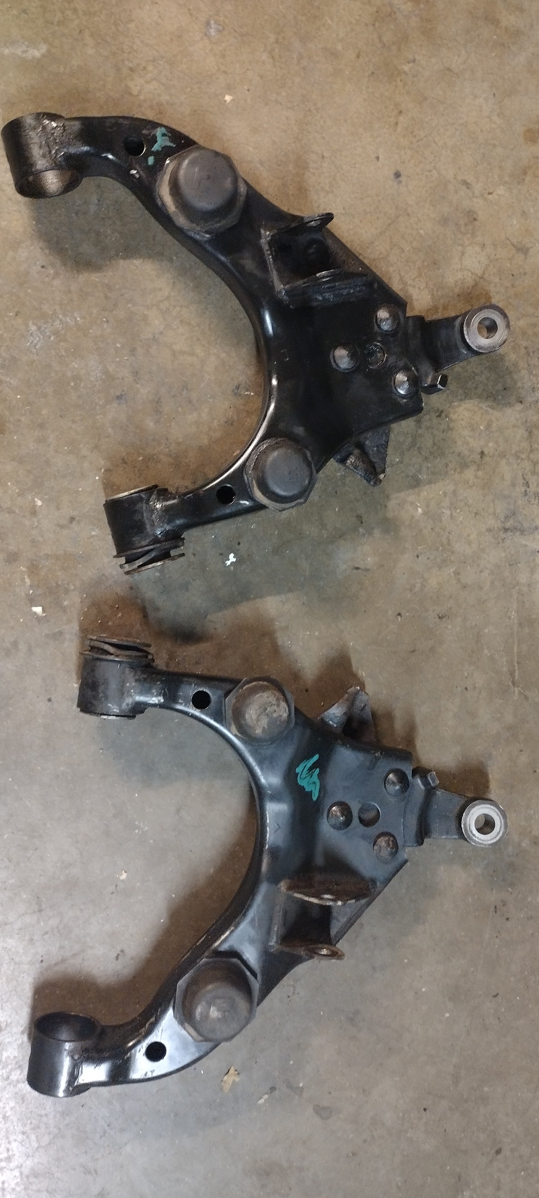

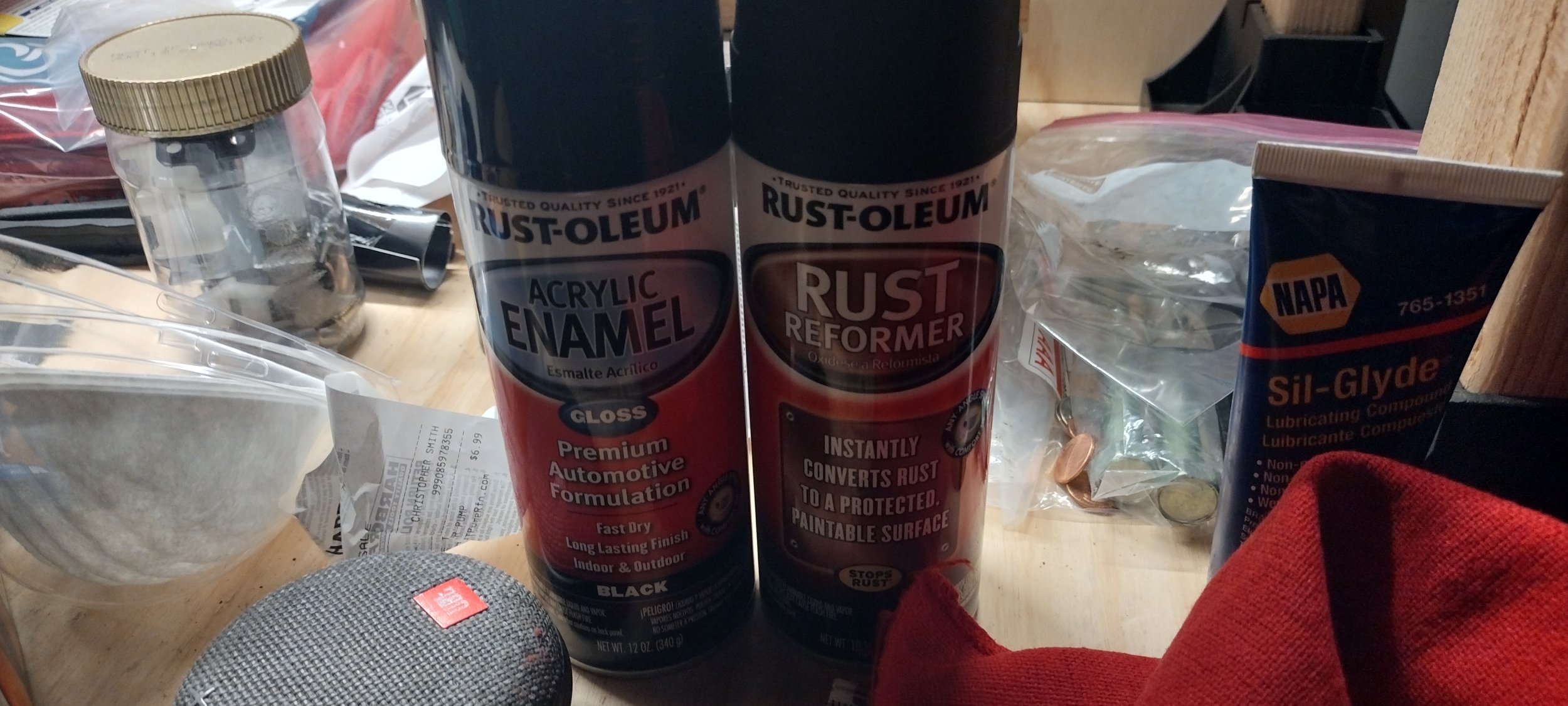

Cleaned up my donor arms a bit, going to a buddy's shop tomorrow to press out the two bushings that were being stubborn using the bottle jack method. Nylon cup wire wheel and some foaming degreaser were absolutely perfect for this job. Took care of all that grime way quicker than just trying to polish with shop rags alone would have done >< Debating now on wire wheeling and painting them which will take me a bit. Never really rattle canned anything in my life so this is probably a great project to learn on, especially considering my truck isn't on stands waiting for them. Did a little research yesterday and I think I got the right stuff? The rust reformer is basically a primer right? Do I need to use mineral spirits before to get a good surface to put this stuff on?

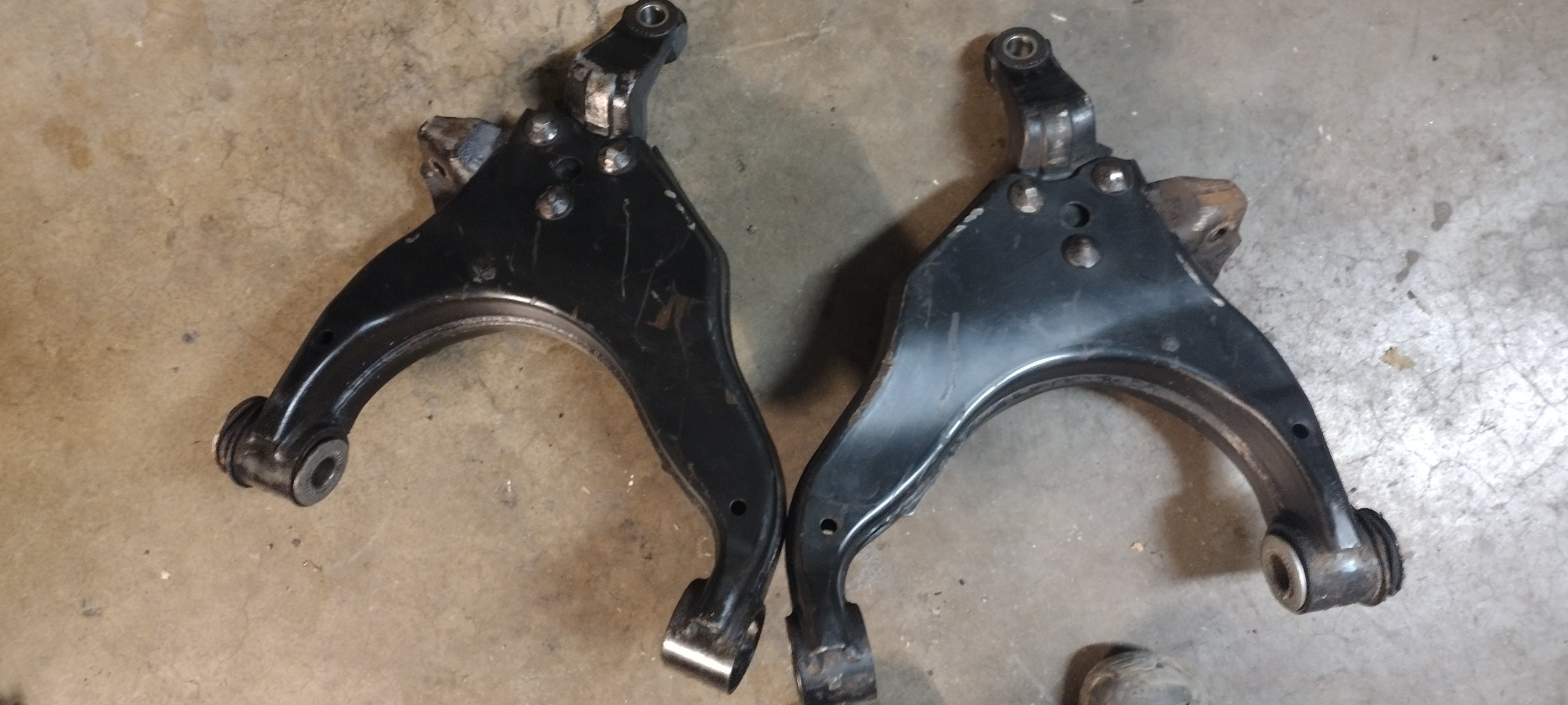

Bushings are all out of my donor arms. Took the wire wheel and knocked off all the rust scale and scuffed the OEM paint (man this stuff is tough). Decided I'm just going to touch up the scratches and rust with the Rustoleum Rust Reformer and then do a few coats of enamel to freshes the arms up. Really happy with how this is turning out so far. The one thing I wonder about is how much paint I should put on the inside of the bushings sleeves. I assume there is a point where it's too much and it makes your life harder getting the whitelines in. Should I just let overspray on the rest of the arms take care of it? One coat?

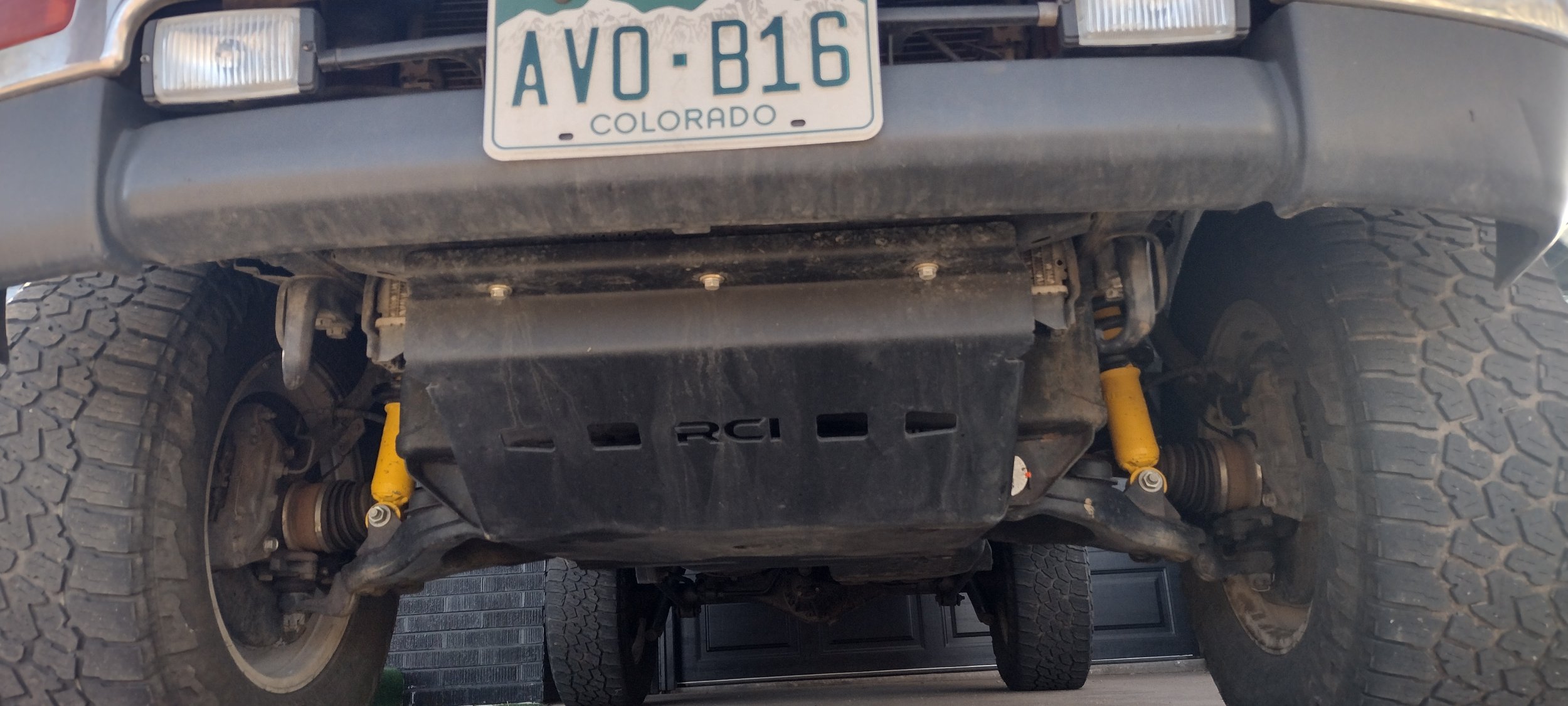

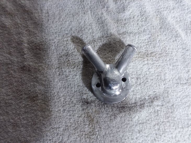

Also installed the other OEM recovery hook that I snagged at the yard. I like how it gives me a little extra radiator protection too on that side since the RCI skids don't cover the corners. Couldn't find a specific torque spec for this but based on the 8 on the bolts I looked it up in the general torque spec chart and it said 80ft lbs. Checked on the other side though and I went up to 100 before I quit so I put the new one up to 100 for now. Does anyone know what these come at from the factory?
