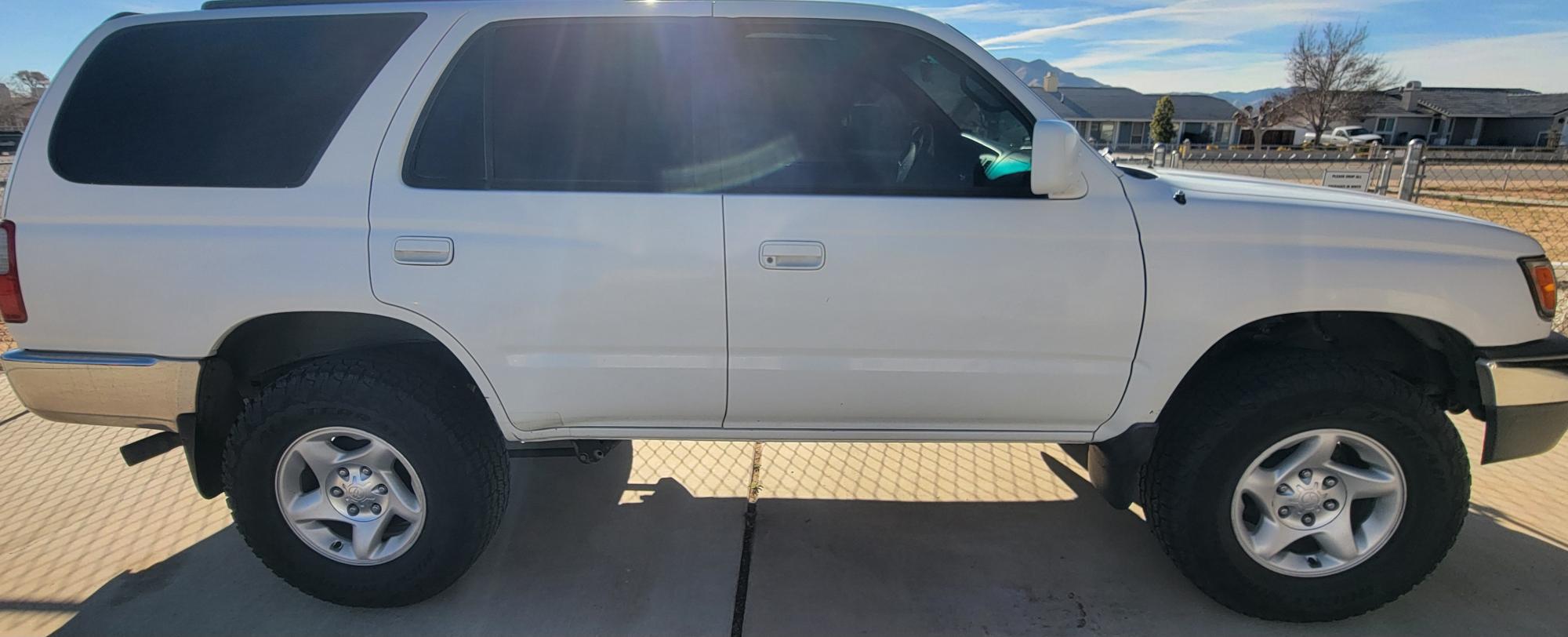

After years of putting up with crappy faded copperish window tint on the front doors, and just the factory privacy glass in the back, I had the tint done at a local shop. Went with carbon tint at 5% in the cargo area and 25% on the doors. If it was my daily driver I would have gone ceramic because of the heat here in the summers but the 4runner is pretty much just my weekend vehicle now

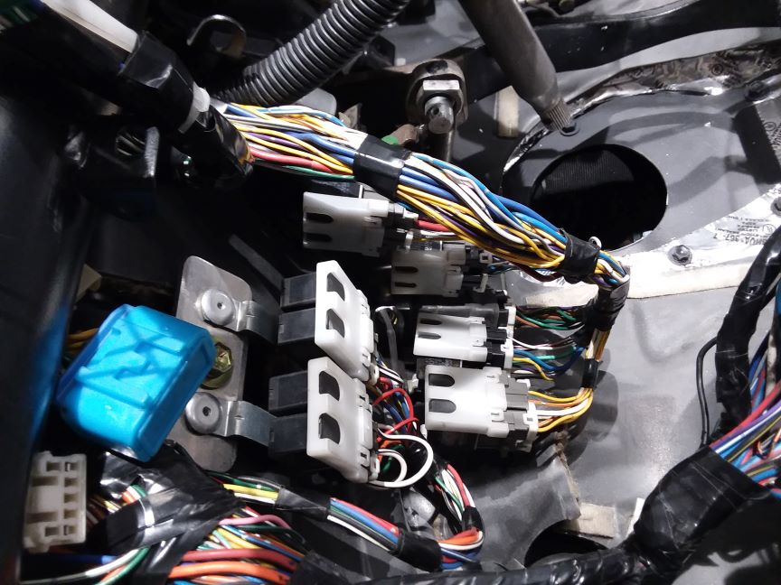

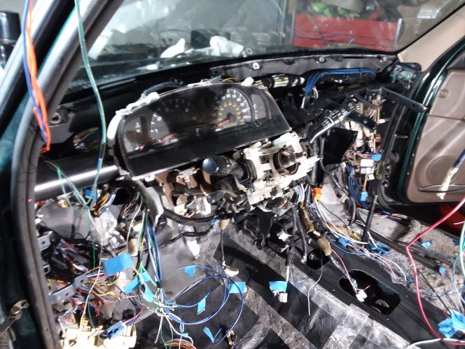

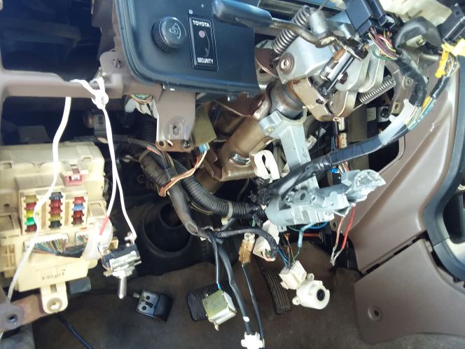

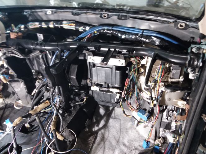

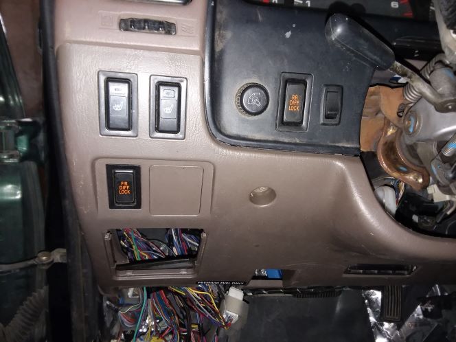

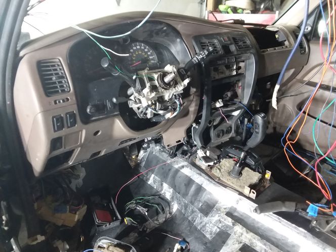

Steering column fog switch, controls the 40" light bar, rewired the rear wiper switch to control the electric fan. ON makes the Fan run on demand, INT the Fans normally (The Volvo/BMW Fan Mod), OFF the Fan can't run on its own until turned back to one of the others. All ON/RUN PWR switch to keep from accidentally draining the Battery.
ECU "New" should be completely integrated into the 4runner.
Plus a number of other systems added/rewired to function as I wanted.
Have to install the dash to wire up a number of OEM/New switches

It's a mod for people that change over to electric fans, It uses a 2 speed fan relay that came in some 90's Volvo's and a switch out of a BMW that activates said automatically at specific preset temps X2 based on which switch one uses.
if u look up "Volvo 2 Speed fan Relay Mod" in google u'll find all the info u could need.

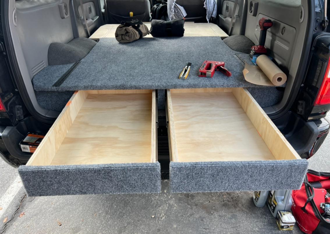

Built some slim (5”) drawers this weekend. Pretty happy with how they turned out. I’m 6’2 and wanted to lose as little vertical space as possible. Drawers are enough to fit all my tools (save the compressor that still lives behind the passenger seat), recovery gear etc. Still need to finish scribing and carpeting the flip up front portion but I’ll do that next weekend.
