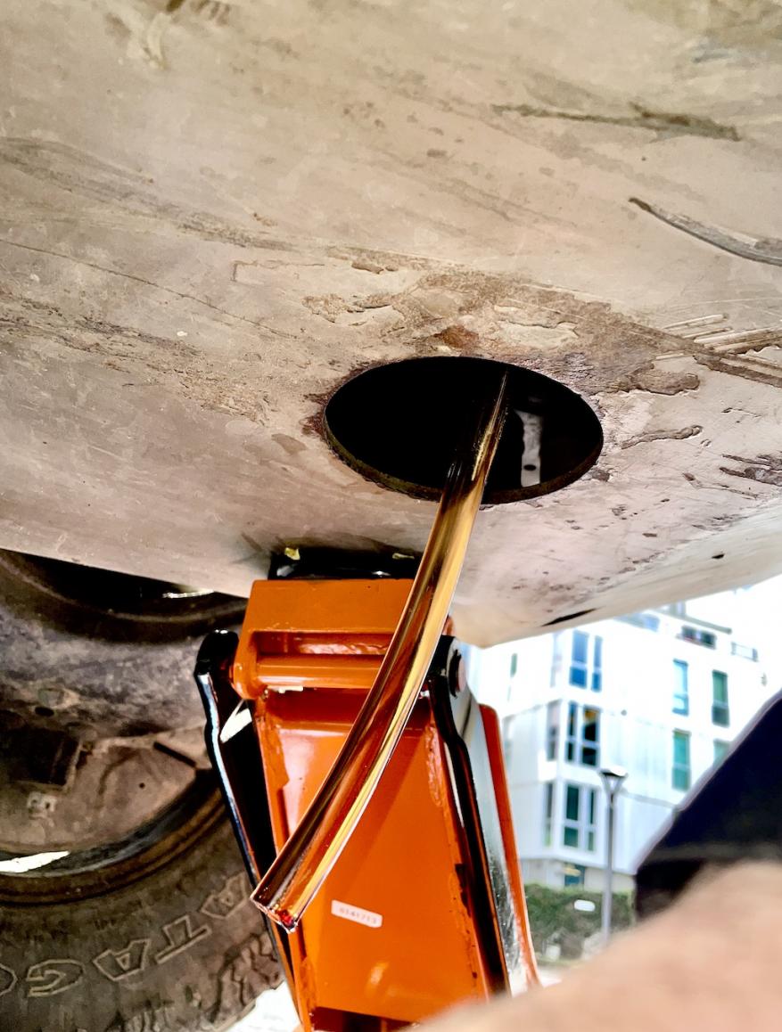

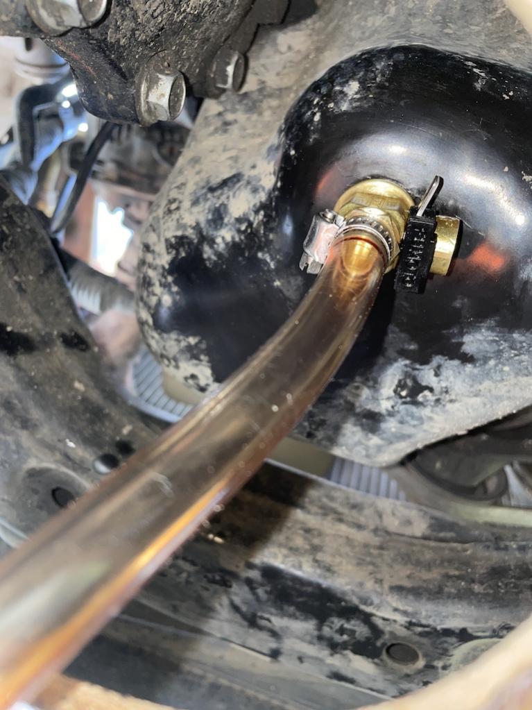

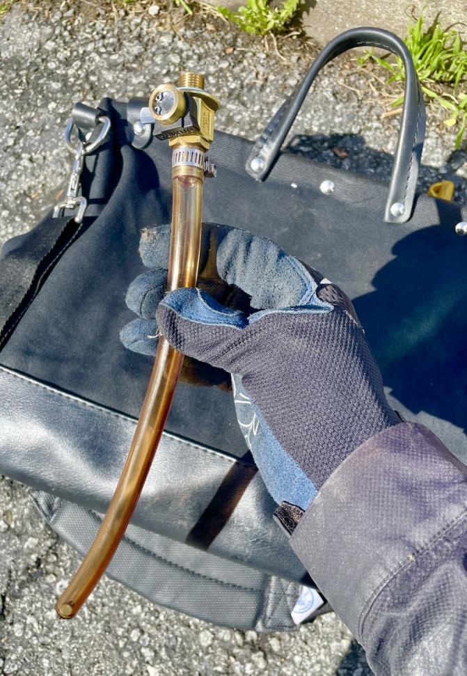

This barely warrants any notice but since it's all I've done this past weekend, I'll post it. The drain hose was falling off and disappearing from my shorty valve so i did a trade and got a long nipple version that fits a hose clamp better. I also take some sick pleasure in posting this because there are always people who seem to think a Fumoto valve is some sort of safety risk. The front is on a jack only because my oil jug was extra-tall. Onward...
Those people are crazy, especially on the 4Runner - it is WAY up in there. I leave my hose connected 100% of the time, it just sticks down 1/2" or so below the skid plate. If a rock or debris pulls it off, I'll just replace it. Been that way for years now with no issues. I'm so much of a rebel I don't even run the little lock bit of plastic on most of my engines (including lowered vehicles).

Damn bro, you ARE a wild man!! LOL
I leave my hose on too and just let it lay on the skidplate. The plastic clip was still in my photos bc it's a new valve - it will go missing soon. Stay free brother!

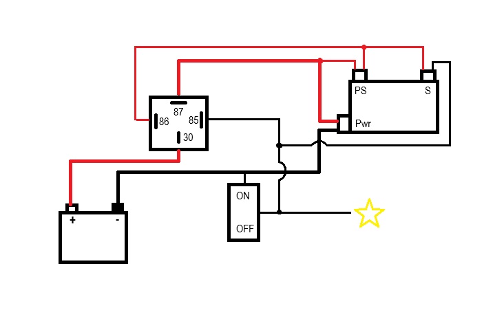

Spent 5 hours rewiring my air locker to a negative trigger, and went I finally went to test it... nothing.
Then I spent another whole hour diagnosing why that is.... before I realized I forgot to disconnect the battery and I blew the 40A fuse, probably while snipping the old wires :doh: :doh: :doh:
Which is kinda relieving, my new circuit (down below) is much more simple than what I did the first time and I was BAFFLED as to why it wasn't working. But still a bummer!
The star is supposed to be the dash light lol
edit: yes I realize now that it won't work :frusty:
