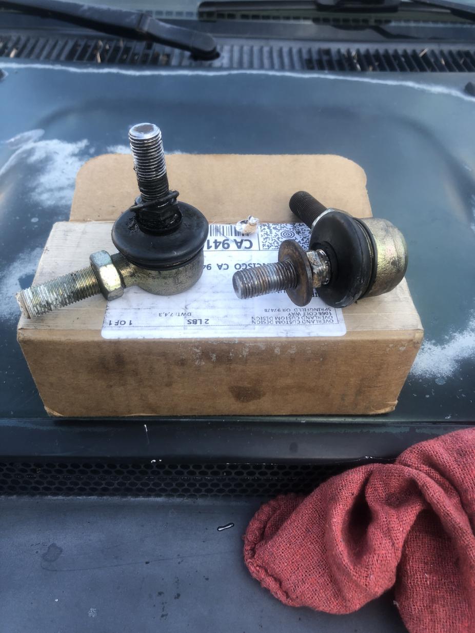

I ordered up mix of parts at a sweet deal to convert my old Sherpa Antero into a full-length Matterhorn. Also rebuilt the ball joint ends of my OCD sway bar end links. I had buggered them up over the years and had cross-threaded stuff and even tore the boots. NOT OCD's fault. All tight and back to No Clunks again!

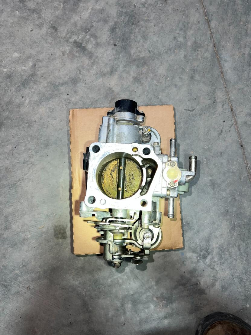

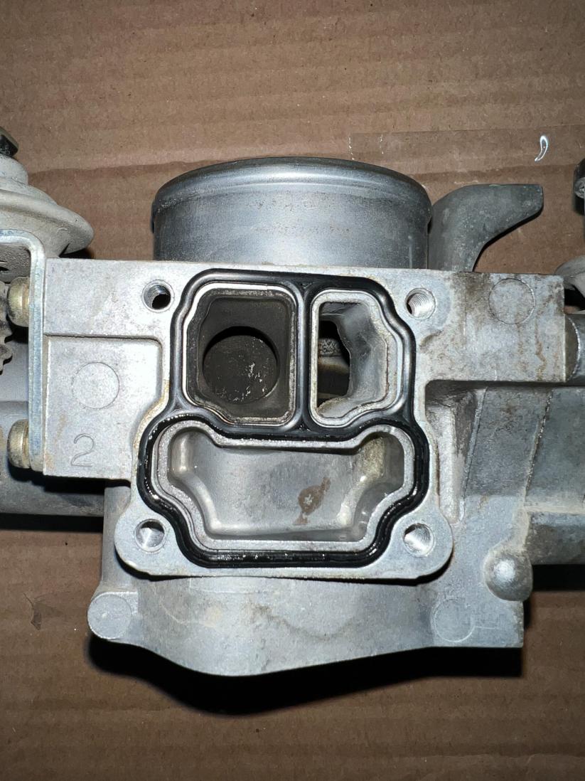

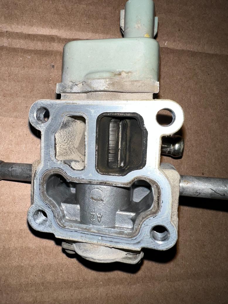

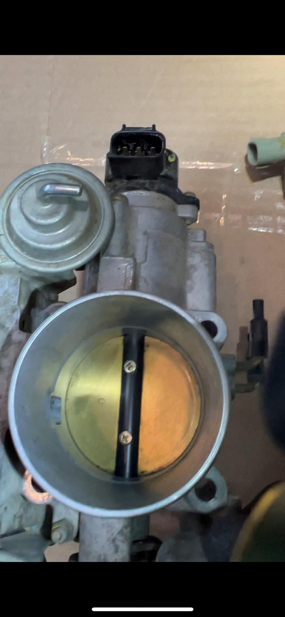

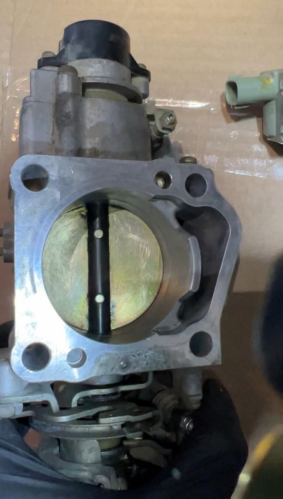

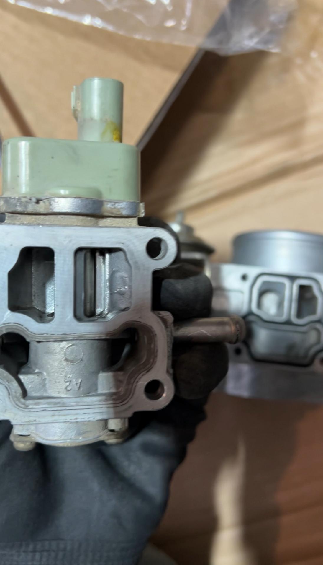

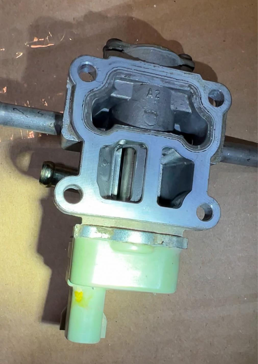

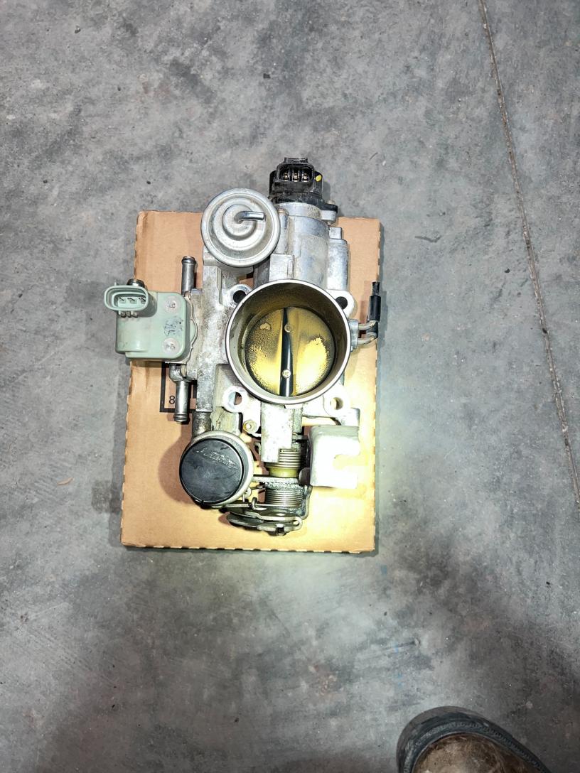

Cleaned TB & IAC + Installed New Gaskets
When I recently bought this 2000 SR5 4x4 Manual with ~174k miles, the whole engine bay was covered in fine dust. Purchased with CEL p0171 and high warm idle (~1500rpm) as the only symptom. I cleared CEL and it came back.
Discovered a hole on clean side of the stock air box. Not sure how long the engine was exposed to unfiltered dust. Awhile by the looks of TB.
Fixed air box hole, got CEL p0505, so I set out cleaning throttle body & IAC. Replaced both gaskets and a number of vacuum lines. Cleared CEL, disconnected battery and EFI fuse. Been driving for about 120mi without CEL. Warm idle is between 850rpm and 1200rpm but mostly sits around 1000rpm.
Think I still have a vacuum leak. Replacing the entire intake with a stock unit and will report back.
