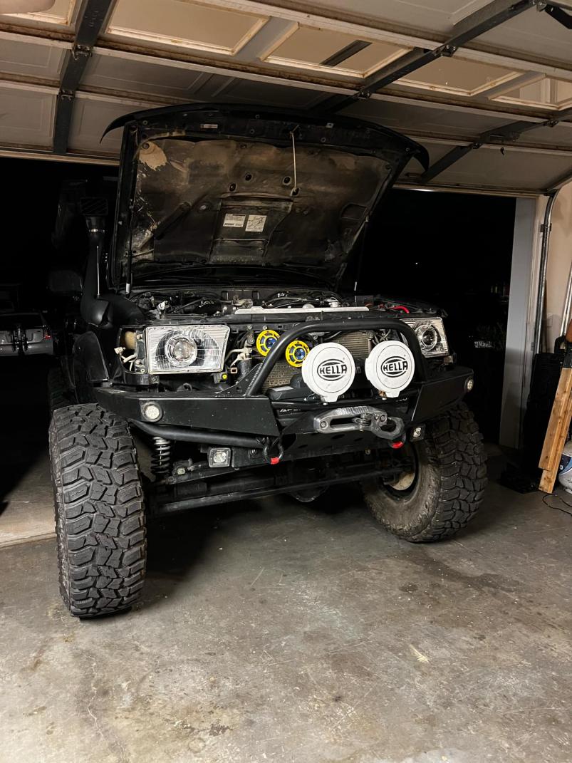

Installed some retros :)
After 10 years of driving around with halogens.. It was time for an upgrade
