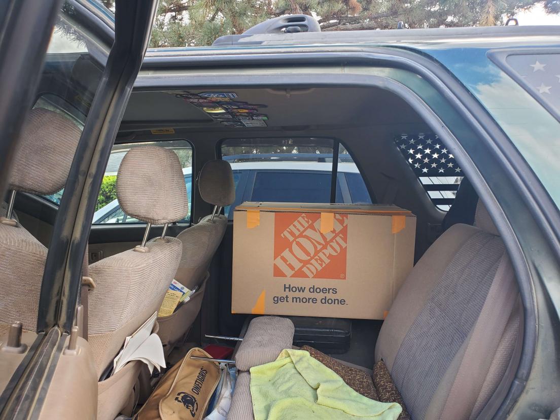

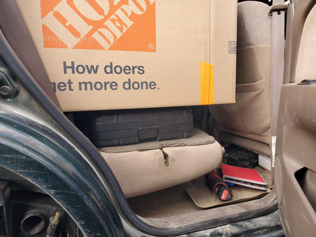

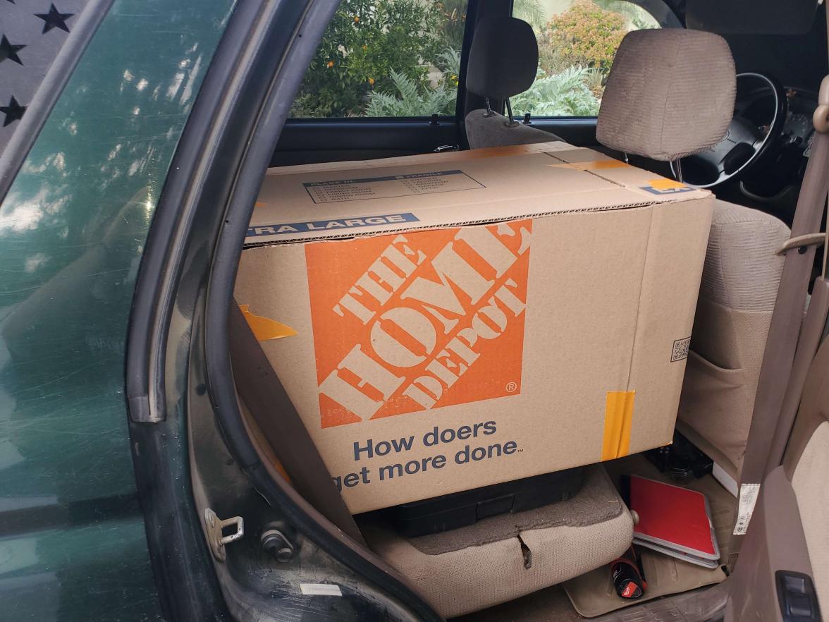

Well yesterday I tested out the CAD fridge template. The smaller size fits perfectly. The larger one was just to tall to get the lid open and get it in the proper location to give me the max sleeping space. It is a 37qt fridge. And on the floor under the fridge there is enough space to fit the power bank.
Today I placed the order for the fridge,I have a onx elite subscription and got a great discount on it too! It's an iceco vl35pros in olive color. It will fit my needs, since I'm solo 99% of the time. Be efficient enough as well. I'll have a 200w solar panel on the roof to charge the power bank.

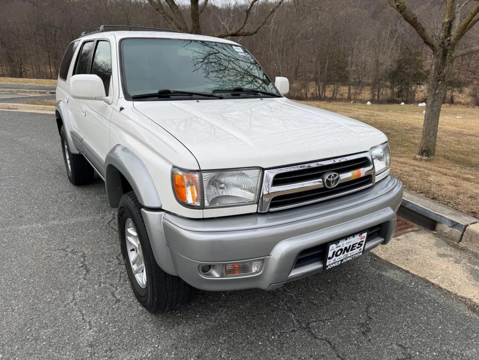

Bought a high mileage Gem
Got a high mileage 99 4RUNNER Limited, on Bring A Trailer auction site, this week. 229K Down sized from a 2014 Sequoia that I paid 22.000 for five years ago. Sold Sequoia outright to a local dealer for 18,500. My insurance went down $500 buck a year. New to me 4RUNNER is way overdue for a Timing belt change but still runs strong. Look forward to learning a lot about my new toy on this forum. Thanks in advance.

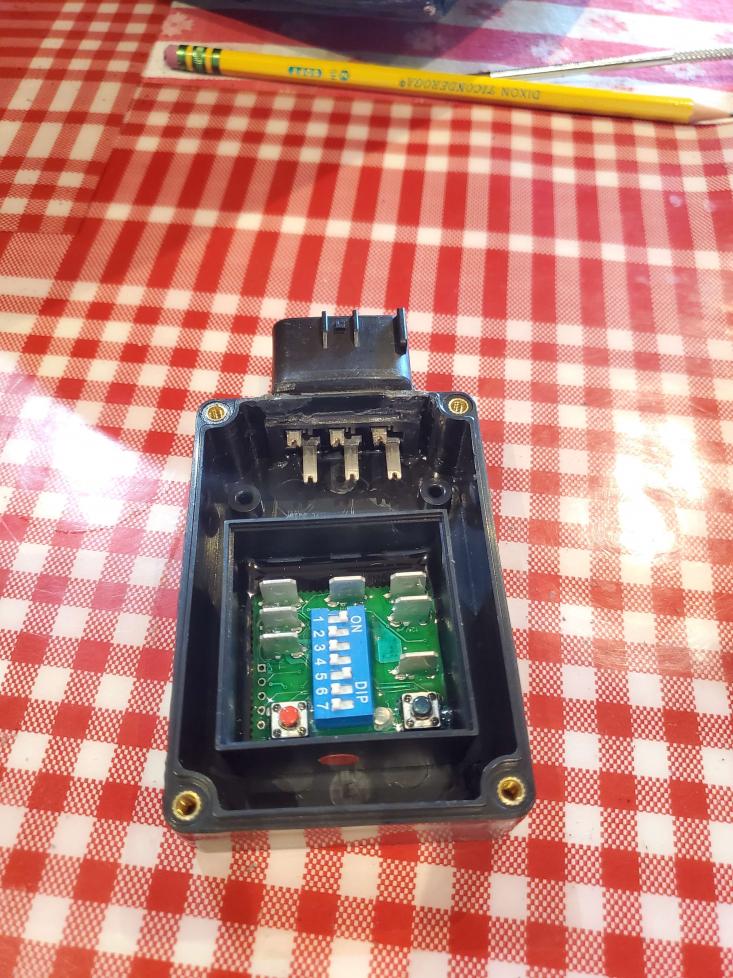

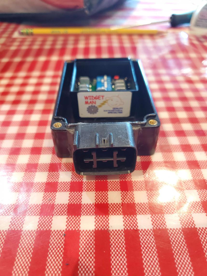

Also started on the fan control module box. Did some cutting and epoxy of a 6 position pcb connector. So now it's waterproof. Just have to solder the wires onto the connector and fit them up to the pwm controller. Also got the fan ordered. Camaro 2016 ss fan. Almost got a spal aftermarket, but forgot it runs off a different controller. I'll start another massive thread when I start this thing.

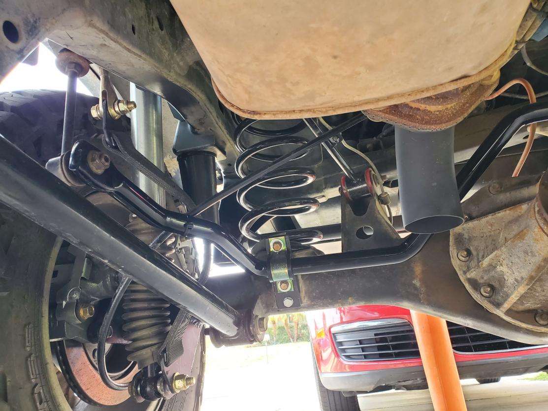

Got the addco rear sway bar yesterday. Thanks FedEx for leaving it in front of the garage again in the rain. Thank God it was just a sway bar. Looks sweet. I'm using the front end links on the rear and no front bar. I've been driving with the stock rear bar, and I have mixed feelings on how it handles. Body rolls like mad.
Going to have to diy some turnbuckle/heim rear links. Using a button head bolt on the swaybar to give me more clerance between the lower link. The stock ball joint end link hits the lower link.

Looking forward to seeing the links. Letting old front links clunk around out back is getting annoying. The stud is the wrong size for the OEM bushings.
I'm wanting to use my DIY sonoran set of axle-side lift brackets, but I don't like the angle the links sit at (I think Jziggy bent his to fit?)
I've been contemplating relocating the frame-side mount up/foward to match. I don't know the leverage math, but does that seem reasonable to do?

True glad someone didn't run off with it. Have had that happen more times then I care to admit. And FedEx being the worst offenders too.
I too have the axle side sway bar lift brackets. I can say for sure the addco swaybar will not fit a e-locker 3rd member without the lift brackets. If it was a inch lower it would smash the elocker motor. Addco didn't copy the stock bar bends at all. It did come with felt fuzz lined bushings. So no lube needed, which is cool. I used the front links at first. But they put the swaybar 1 inch away from the lower links, which I'm sure would smack the lower links badly, flexed out. So I put the rear end links back in and it has more clerance, but they are now at wierd angles. It's like they should have made the sway bar narrower and put the end link mounts on the inside of the frame. Either way, I see bad contact in my future. Just not feeling to hot today, otherwise I'd pull the springs and check for issues under flex.
Pic is with front links on rear.
