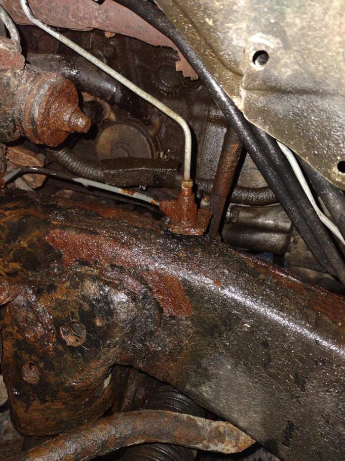

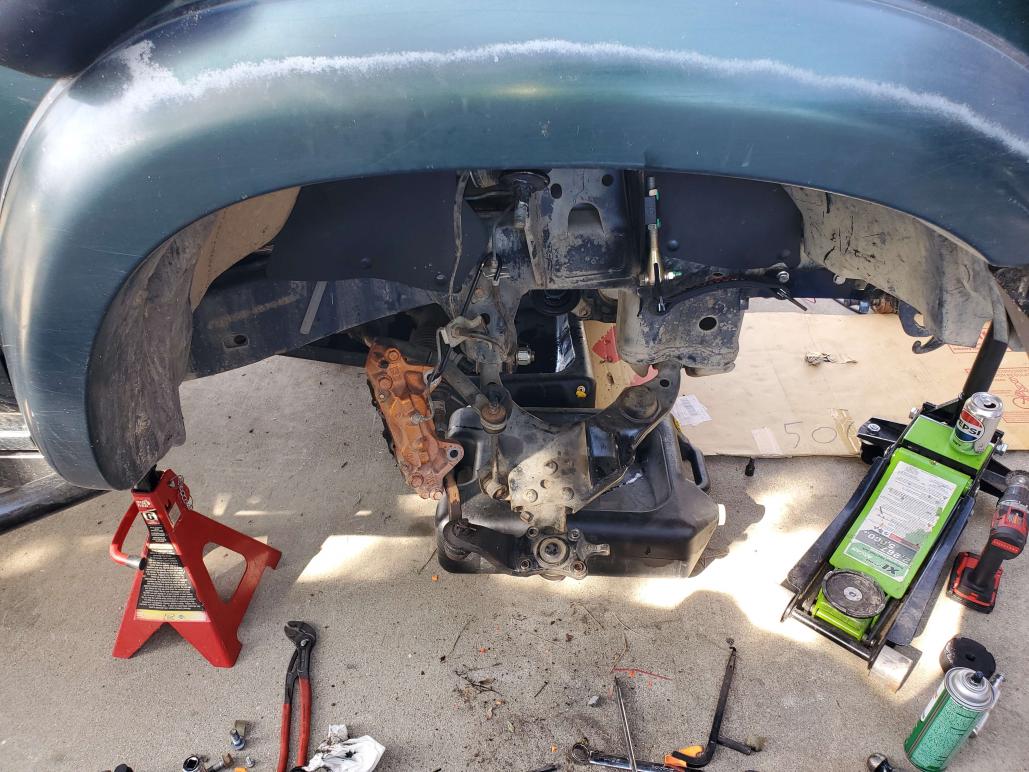

On my way to get new tires, I blew a left front brake line. Downstream hard line of the 90* "fitting". Needless to say, I limped over to an autozone to get some brake fluid to get back home.......very slowly with a lot of distance between me and anything in front.
I just got this 4Runner a week ago. PO did brakes on all 4 corners about 5K ago. But not all the lines were done. AND the parking brake needs adjustment.
A week ago, on my way back from picking it up I paid a visit to a forum member.....Brillo.
We discussed a lot of 4Runner things. One of them was fabricating brake lines. So I already had a brake line "kit" in my amazon shopping cart. I knew I was going to have to do this sooner or later. It is sooner.
So for my 4Runner today.....no new tires, cursed at her a little bit, a DIY brake line kit with 25' of 3/16" Cu-Ni tubing, amazon flex hoses and amazon hard lines from flex hose to caliper.

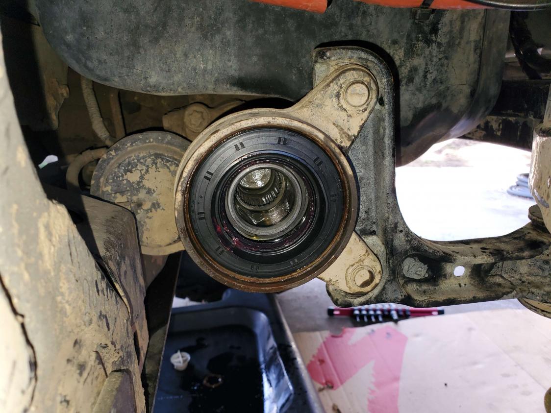

Well today I reinstalled the stock hubs, new wheel bearings, and new trackmotive extended travel cv's. Also put in arp studs instead of bolts for the lower ball joint mount. Man it's a PITA to take apart all the manual hub stuff. Those damned cone washers.
I have to take the pass side axle out of the hub as I forgot to grease the splines of the cv stub......sigh. Lost my 36mm socket to, so this will be finished tomorrow. Oh yes also put in the land cruiser hex front diff drain plug. Almost stripped the alen out.
Well, the outcome........ got an inch more down travel! That is awesome! The coilovers top out before the cv's come close to binding. Rad! No other pics, had to focus on getting this done. Still got to install the front diff breather mod thing to stop it from puking oil.
