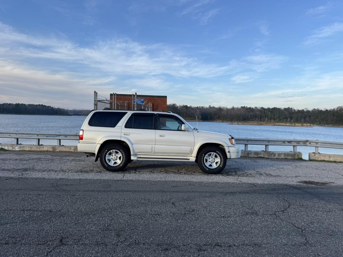

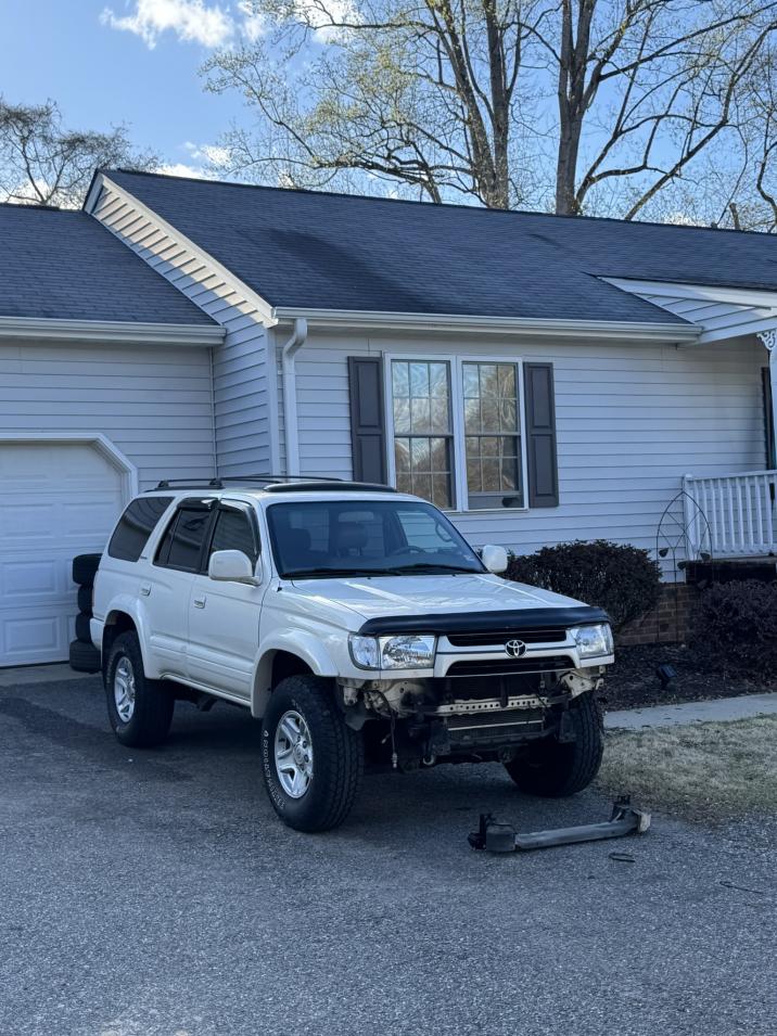

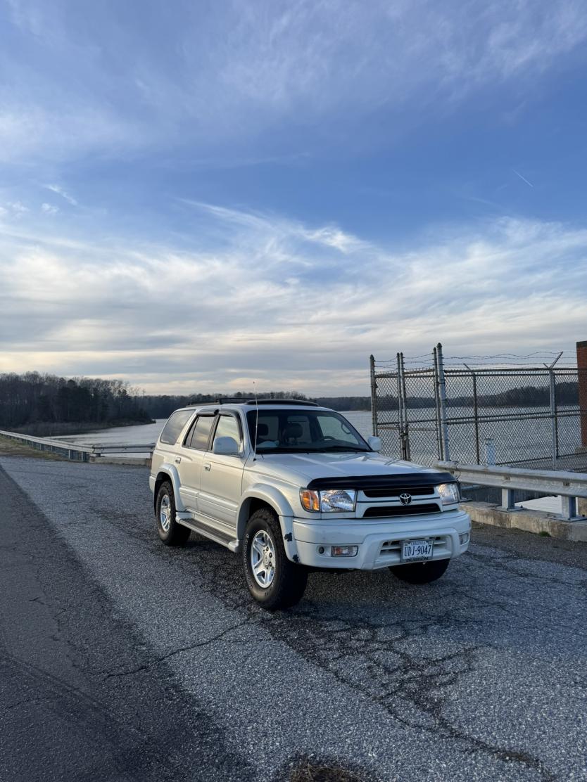

Picked up this Limited Golden Pearl a few days ago, 180k miles, limited, bone stock for a steal! Immediately threw a 1.5 inch body lift on it while I wait for suspension parts to deliver :D
