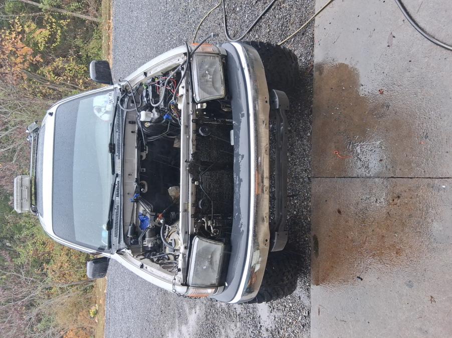

Work in progress
In the middle of swapping into 3rd gen. Previous motor broke 500k so it's a much needed improvement.

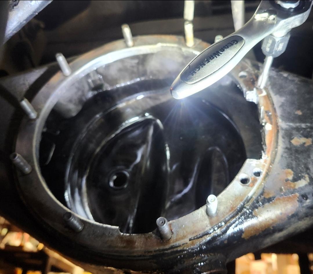

Removed rear diff, drilled, tapped, and grinded out the housing for an Elocker 4.30 retrofit on my rwd. It fit in after I cut, but before I tapped and installed studs, tomorrow I fit it in and hope and pray it all fits together happily lol. Writeup with wiring to a custom switch pending :)

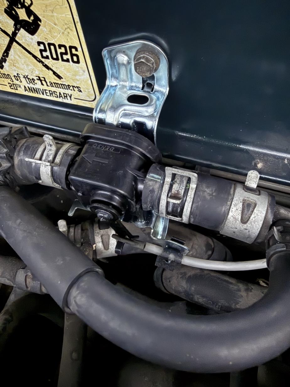

As fellow sufferer of oddball temp fluctuations, and having done everything I could think of short of a water pump to get back to normal temps, I proactively swapped in an new OEM heater control valve this afternoon. Why? Because my heating system has become an important part of my cooling system and I don't want the original unit to fail in the middle ofnowhere. When I drive slow, and on most hills, the heater needs to be cranking to stay under 200 degrees. If I'm above 50MPH, all is well. 188.6 degrees. New water pump and TB, et., will be done in early December. I'm on T-Stat #4, Koyorad radiator, and a custom fan clutch that runs longer and louder over a wider range of temps than the stock one does. I know I shouldn't have to do any of this, but I am only human.

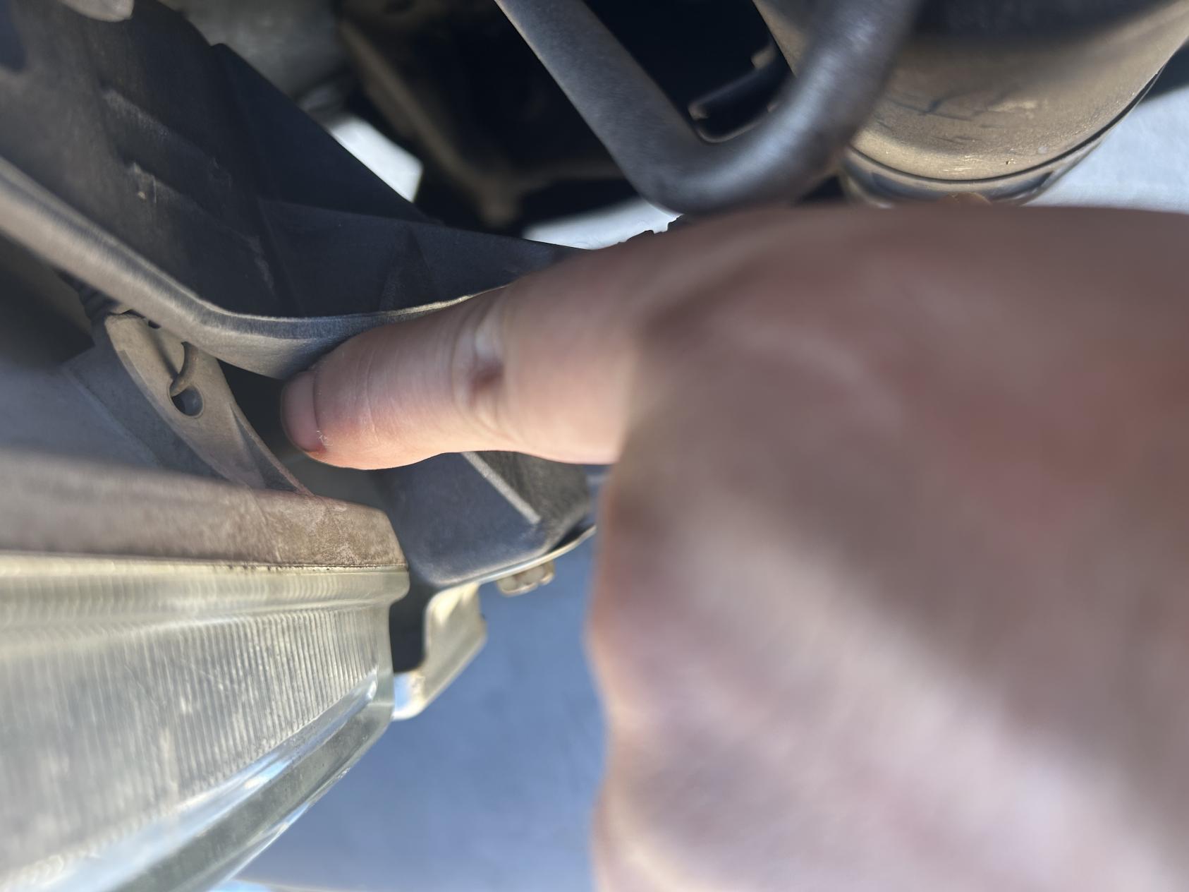

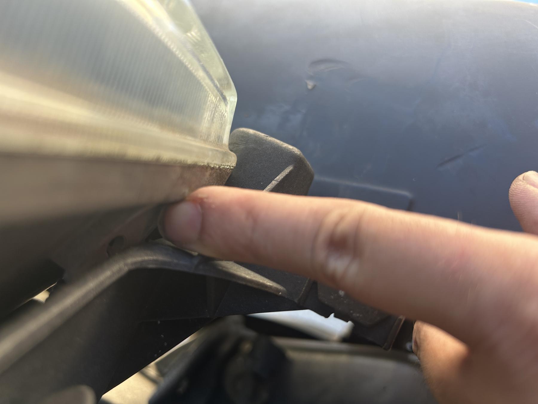

Headlight adjustment
Been working on a front bumper repair and in the final stages. Hoping someone could help me realign my headlight?
It seems like the bottom of headlight needs to be pushed out a little bit. There is more room between the housing and lamp on the unaffected side and the filler piece below it sticks out too far as currently assembled.
What pushes against the spring in the housing that is pulling the bottom of the headlight back in?
