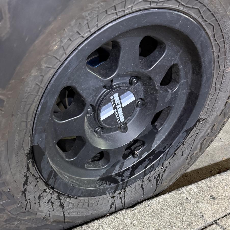

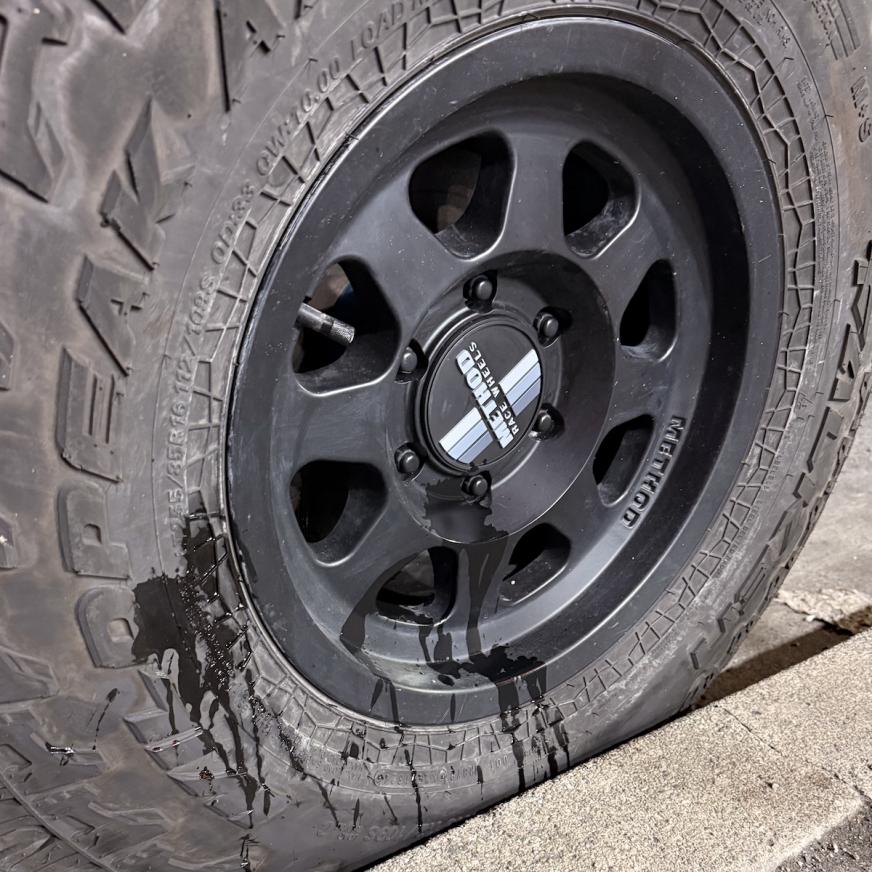

Today I was reminded of one of the perils of owning a homeless 4Runner: Local dogs :)
