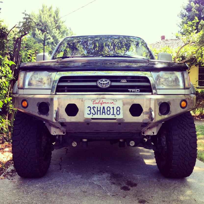

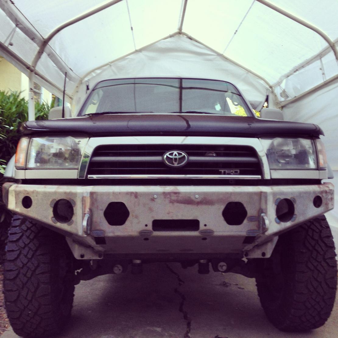

4x innovations plate bumper mock up. Need to do some cutting, make some modifications to accommodate for 1" BL then off to paint and VR winch install.
