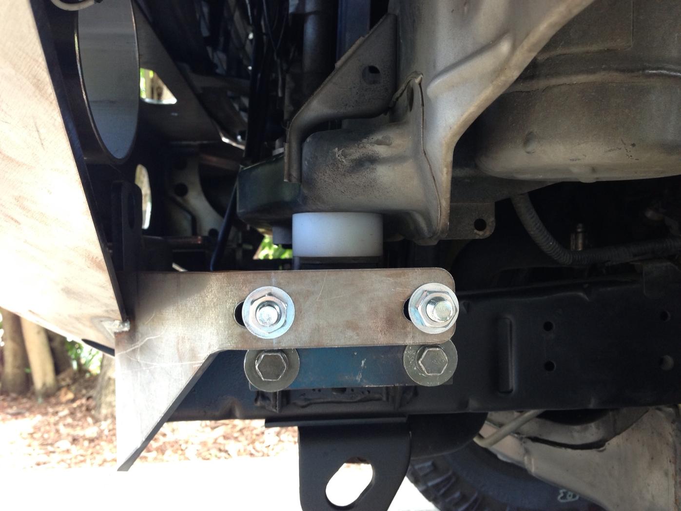

How did you do that? I think I want a body lift but I have the 4xinnovations bumper that leaves the gap. Do you mind telling how you fixed the gap problem ? Thanks
Basically I was messing around with the parts I had laying around and picked up a few nuts & bolts from Home Depot. I would like to preface this by saying the install is not complete, I am flying by the seat of my pants and I am not responsible for any crazy ideas someone might take away from this.
The 4Crawler BL comes with a bolt on bracket to lift the stock bumper up 1” and I would imagine the others do to, which is what I am currently using. Obviously the new plate bumper is much heavier and I will need to figure out a way to add strength. Additionally, I now have two failure points by adding a bolt on bumper to a bolt on bracket. Surprisingly it feels really solid and I am confident it will hold up to daily driving while I work out all the details. I plan to beef up the bracket or have a new one made, weld it directly to the frame and leave the top portion as a bolt on so I still have the option to remove the bumper if I ever need to repaint or access the winch.
I also notched out a part of the skid plate mount with a grinder to fit the plate bumper over the preexisting mounting points instead of under. There are 5 holes for the skid plate that I plan to use to attach the bottom portion of the new bumper with nuts, washers and bolts. I might have the skid mount boxed in as well for additional strength.
As Bandit observed it is quite snug at the moment, which does not leave much room for flexing. If I make or have a new bracket made I will take this into consideration.
I recall Ripcord addressed an issue with the bumper mounts tweaking and plan to revisit his build thread to see how he added more support. He doesn’t have a body lift but it is still good tribal knowledge to take into consideration.
