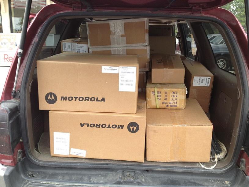

Loaded her up with $250,000 dollars of optical equipment.
Hows that for a quarter million dollar ride? :pimp:

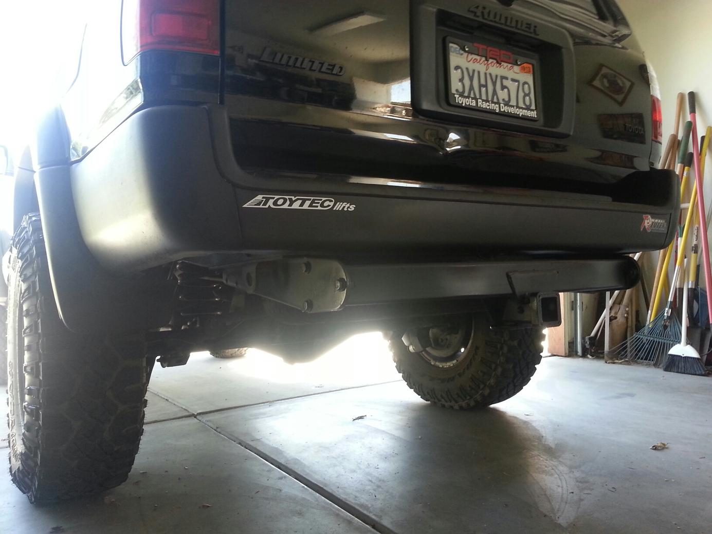

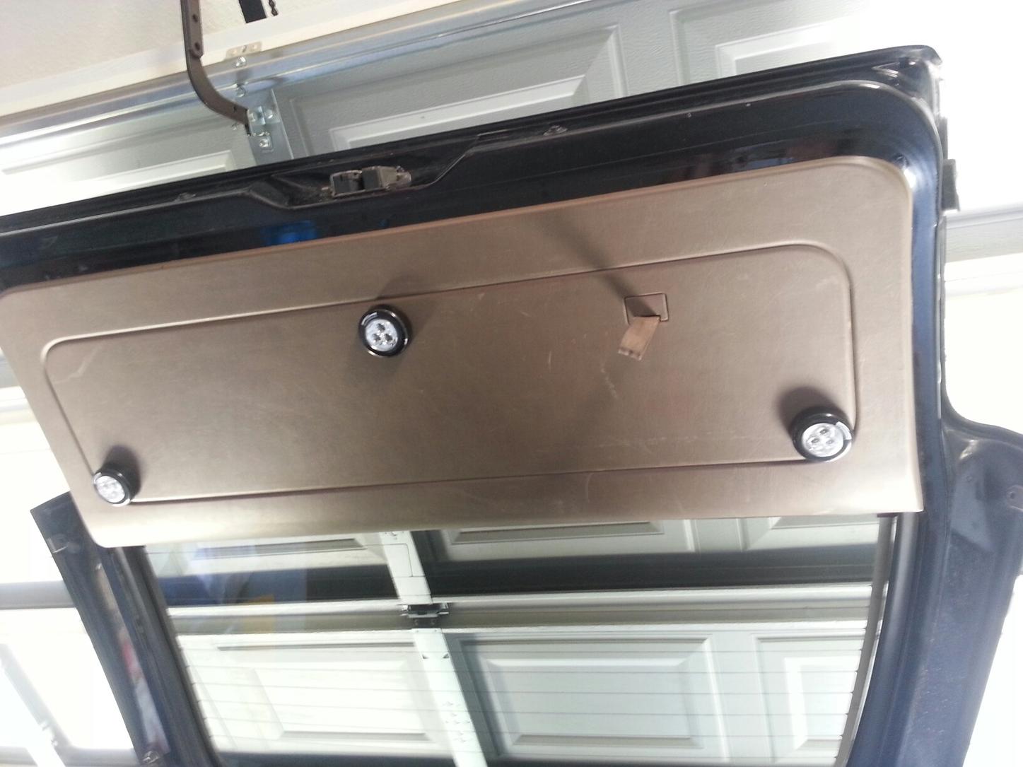

Just mounted some LED light pods on my tail-gate, the pods came with an adheisive backing so the install was a snap, they might look a little cheap but they do the job! BETTER THAN DARKNESS! :fear:
*also got some new decals for the rear bumper: ToyTec & RevteK :bowl:

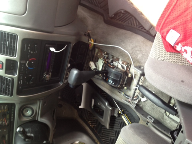

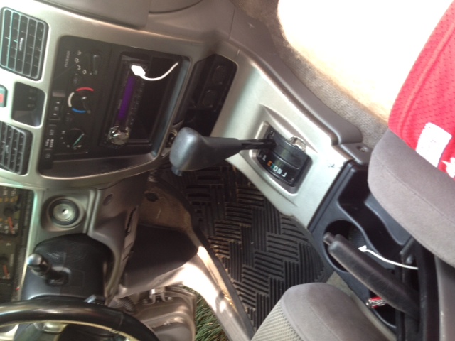

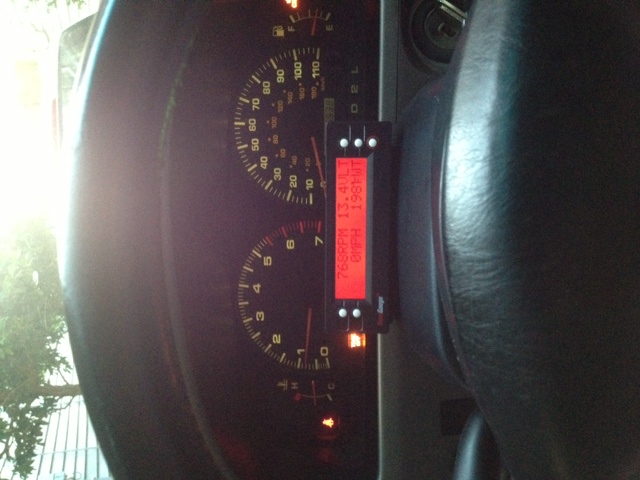

I routed my iPod cable through the dash and up through the e-brake hole. Also, installed my new Scangauge II today!
Wow, I don't know why the pics are sideways. But, I don't know how to rotate them the correct way. So, for a little guidance in this time of great peril, I attached that owl.

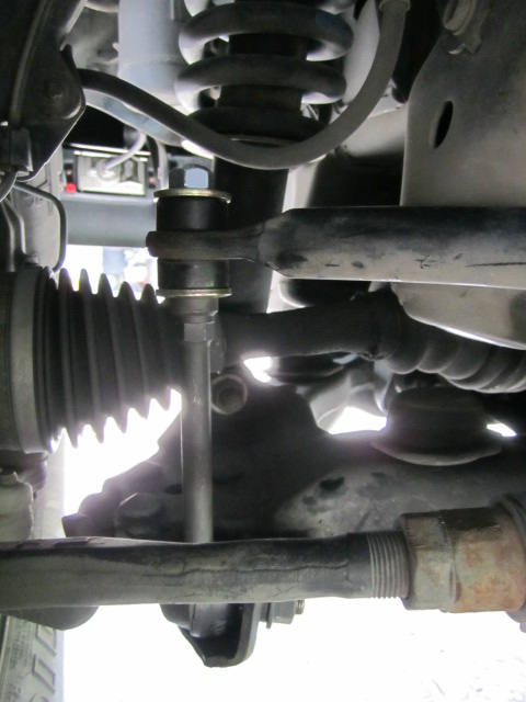

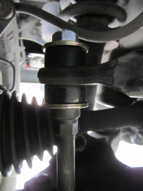

Endlinks and Tint

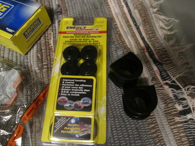

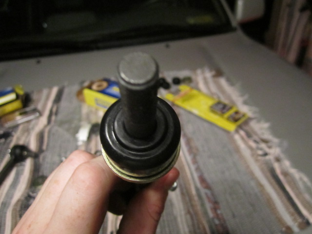

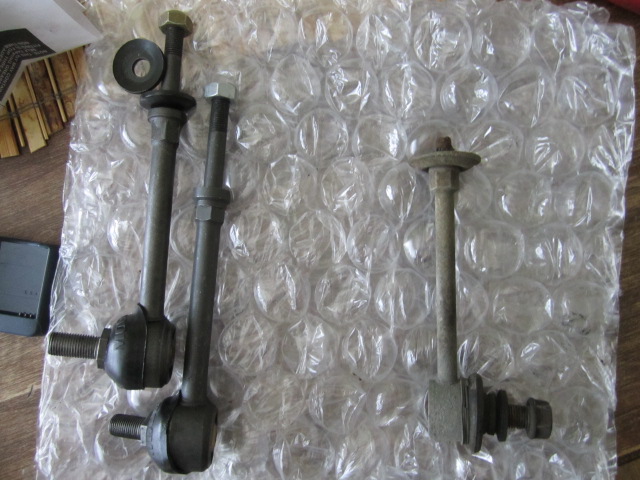

Finally, finally!, got my new front endlinks installed with Energy Suspension black bushings. Still have to install the new bushings on the rear endlinks, but I have to find a way to get the nuts from hell off first :ybrick:. Those things do not want to budge!

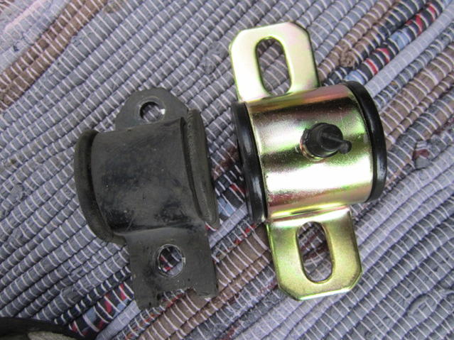

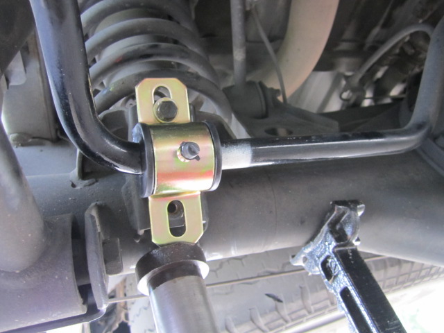

Also, I ordered ES front and rear swaybar bushings. Frustratingly, the fronts did not come with any hardware or brackets and are too "skinny" to fit the oem brackets, so those are getting returned. Got the rears installed though, piece of cake, although I did have to "jack" the brackets into place so the holes would line up. Those came with new brackets and zerk fittings, used oem hardware. Very happy with the endlink bushings. I originally purchased a Prothane kit but those did not fit at all. The ES ones fit the links snug.
Can't give a comparison as far as the bushings go because I think I was driving without endlinks at all up front for a while, but new endlinks vs. no endlinks is a big difference. I can actually take turns at reasonable speeds now!

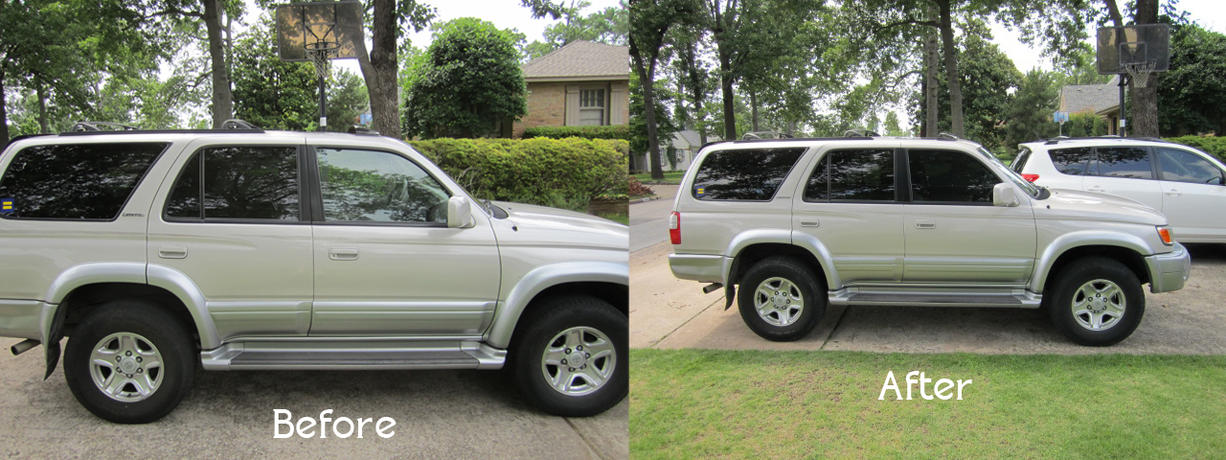

Lastly, got my front windows tinted. In Oklahoma SUVs can have 25% up front and anything on the back. I believe the privacy tint 4Rs come with is 23% and my front windows are basically identical. This will do for now until I get 5% on all my back windows :)
