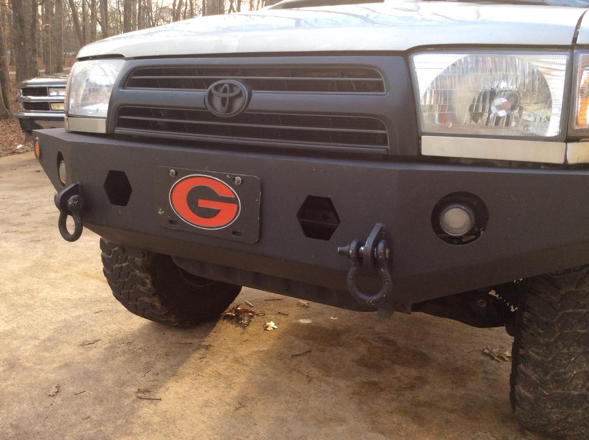

Not sure on the turnaround times (I got lucky and was able to stop in on my way through town and picked up a "scratch and dent")
However, you will LOVE it when it does show up. Hopefully you have the newer style factory bumper mounts so it will just bolt right up. My '96 needed plates welded on the front frame rails, but totally worth it.
edit: I see you have a 96 Limited...crawl under and see if you have these crush cans on the front frame rails instead of a flange with 3 bolts.
If so, make sure they send you these weld plates.

The crush cans come off with one bolt, idk ill see whenever it gets here.

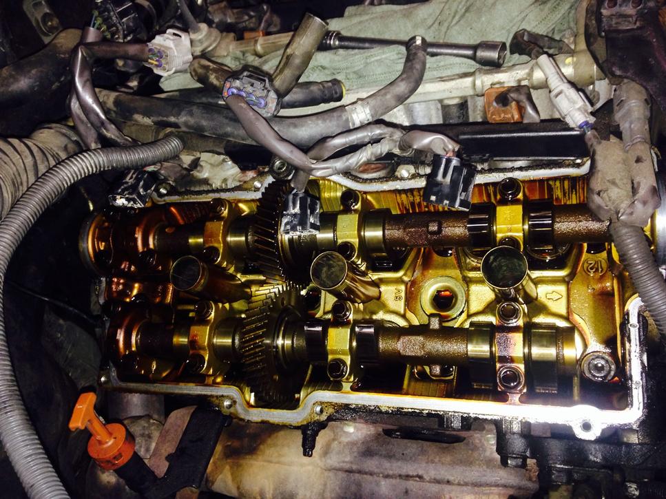

Started replacing valve cover gaskets and it was going good until I slipped and destroyed one of my new spark plug seals. Be careful when bending the tabs back down on the bottom side. Other than that everything looked good.
