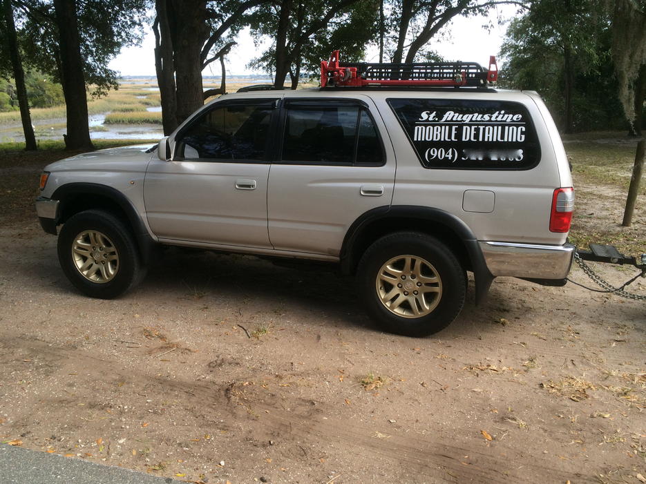

Refinished my wheels. They were really scuffed when I got them. So after 3 years of sheer laziness I decided to paint them black. Then when I went to get the paint and supplies I noticed an awesome color called CHAMPAGNE MIST and figured I could do black wheels like everyone else in my area does on EVERYTHING, or WTF, bronze would be RAD. Besides I can always redo them black again if I hate it. 3 days later and I am pretty stoked how they turned out.
