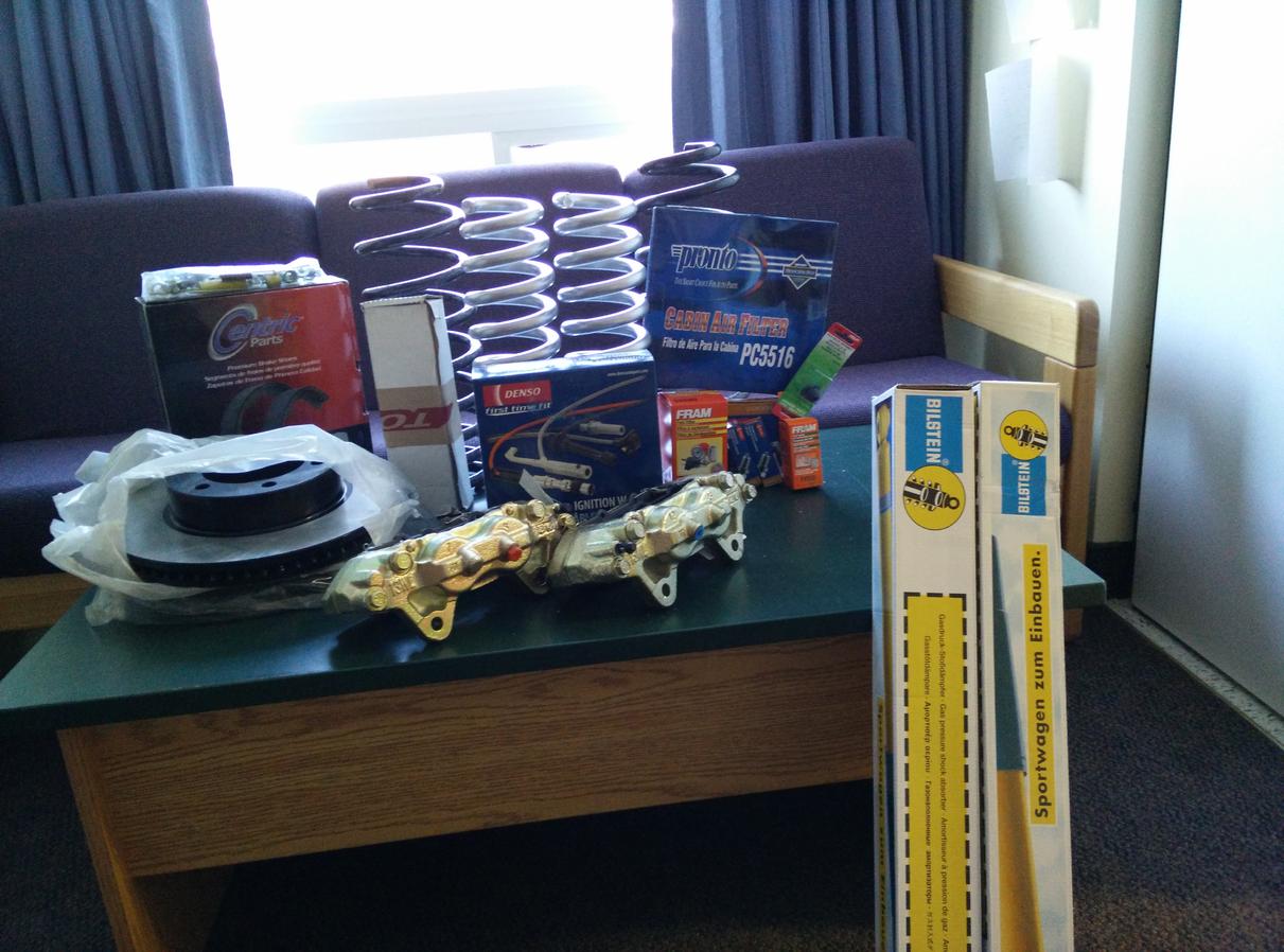

Finally got most of the parts I ordered :D. Loaded 231mm tundra calipers, rotors, rear brake shoes, rear brake hardware kit, toytec eibach front coils, diff drop kit, ome 891 rear coils, long travel billy 5125's, oem denso plugs and plug wiring, and some other small stuff :D Still waiting on the tundra billy 5100's :)

Nice, though I am quite curious where you are putting that cabin air filter.....

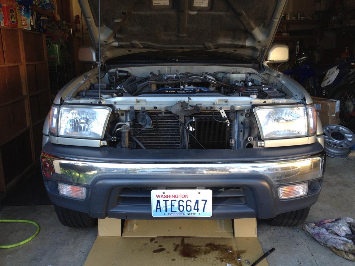

Installed new Denso Radiator since the OEM one had 187,569 miles on it, also threw on a B&M 70268 for good measure.
Holy bananas I didnt even realize that it didn't have one! Shit! My parents '95 Volvo 850 had one(I almost convinced them to sell it to me... I only kind of miss it)! Haha, guess you learn something everyday. This is my first car so everything is a learning experience. Maybe I'll mod the sucker so that it fits :P
Edit: After looking at it a bit, I might be able to put something together on AutoCAD and get it 3D printed. That way I could easily replace the filter.
