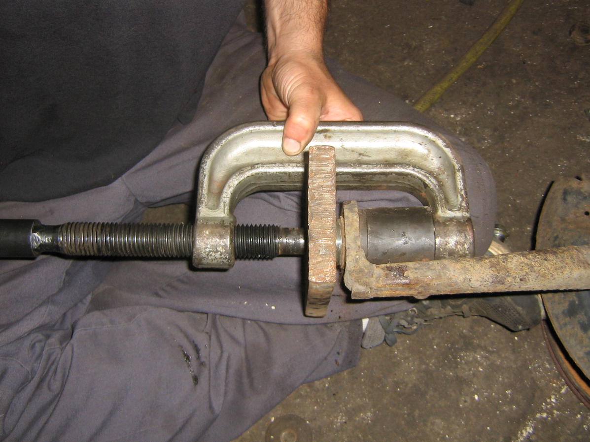

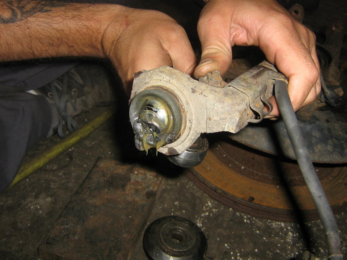

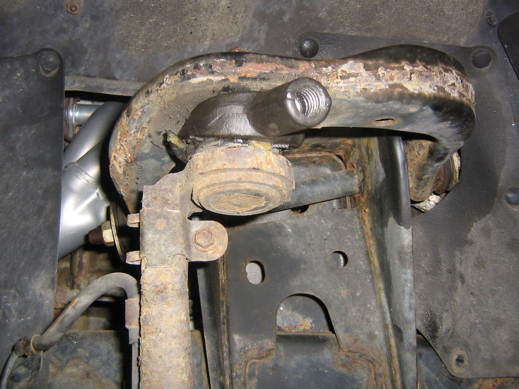

How was removing the UCA? I just replaced the lowers but have been holding out on the uppers since, I think I need another tool to remove them. what did you use to get them out?
Removing the UCA was easy, getting the UBJ out sucked. I had the spindle off so I cut the top of the ball joint off & pressed it out with a flat piece of metal. (my buddy's suggestion)

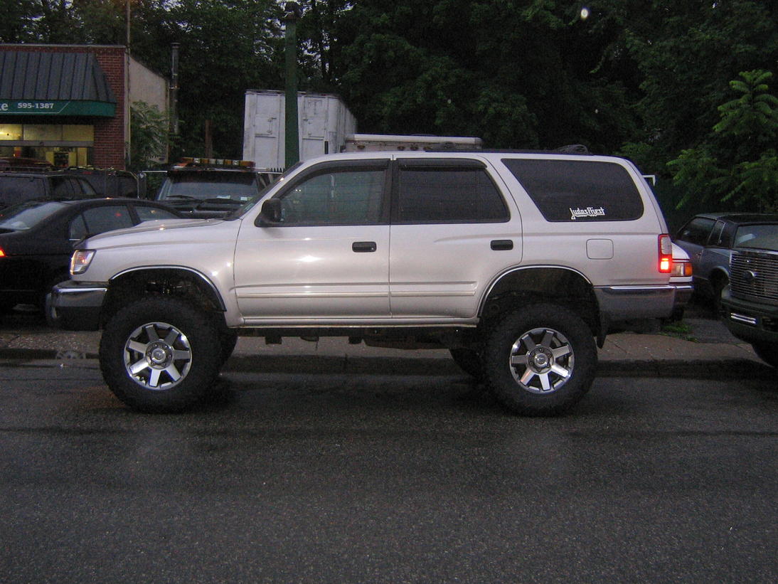

Looks super good buddy!:bravo:
Thanks Bro, I'm real happy with the way it came out. I'll take better pics,
this was taken at 6am in the rain Sunday morning. Me & my buddy Craig worked on it all night. We also installed the the hi-flow SS exhaust from the headers back.

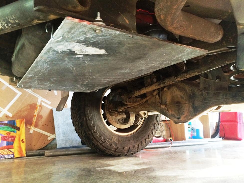

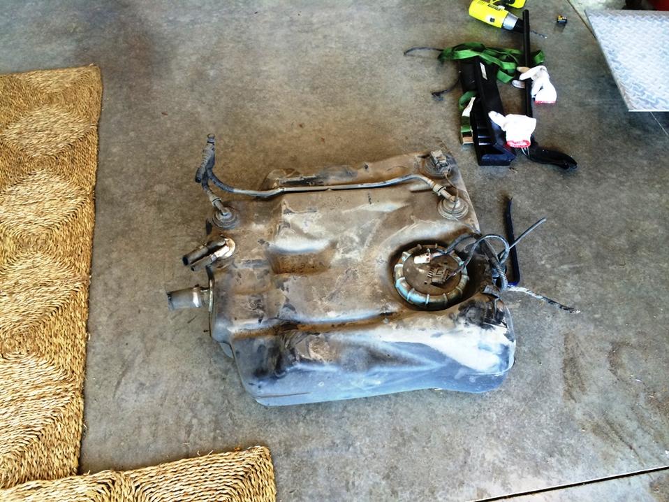

12.2 gallon aux tank and transfer pump installed.
Building a better skid - just not finished with that part.
